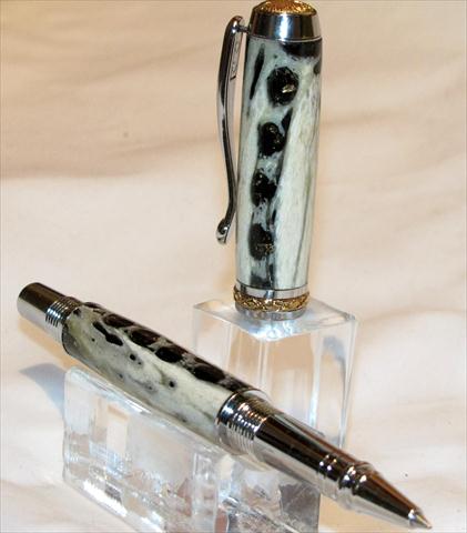

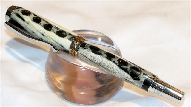

Working on two projects, but this one is by far more fun than the other (Woodturners finish)!! This is turning the Gator jaw pen blanks from Tom Barron!!
Tom asked me to make a video, so I have shown drilling, and turning with the roughing gouge, skew and Rotundo carbide tool. I have to say it was fun to get different tools in my hands again.
The process is all "on tape", but I was impressed with the still pictures that will start and end the videos. Hope you enjoy them too!!
Hardware is the Triton Rollerball in chrome and tiGold.
