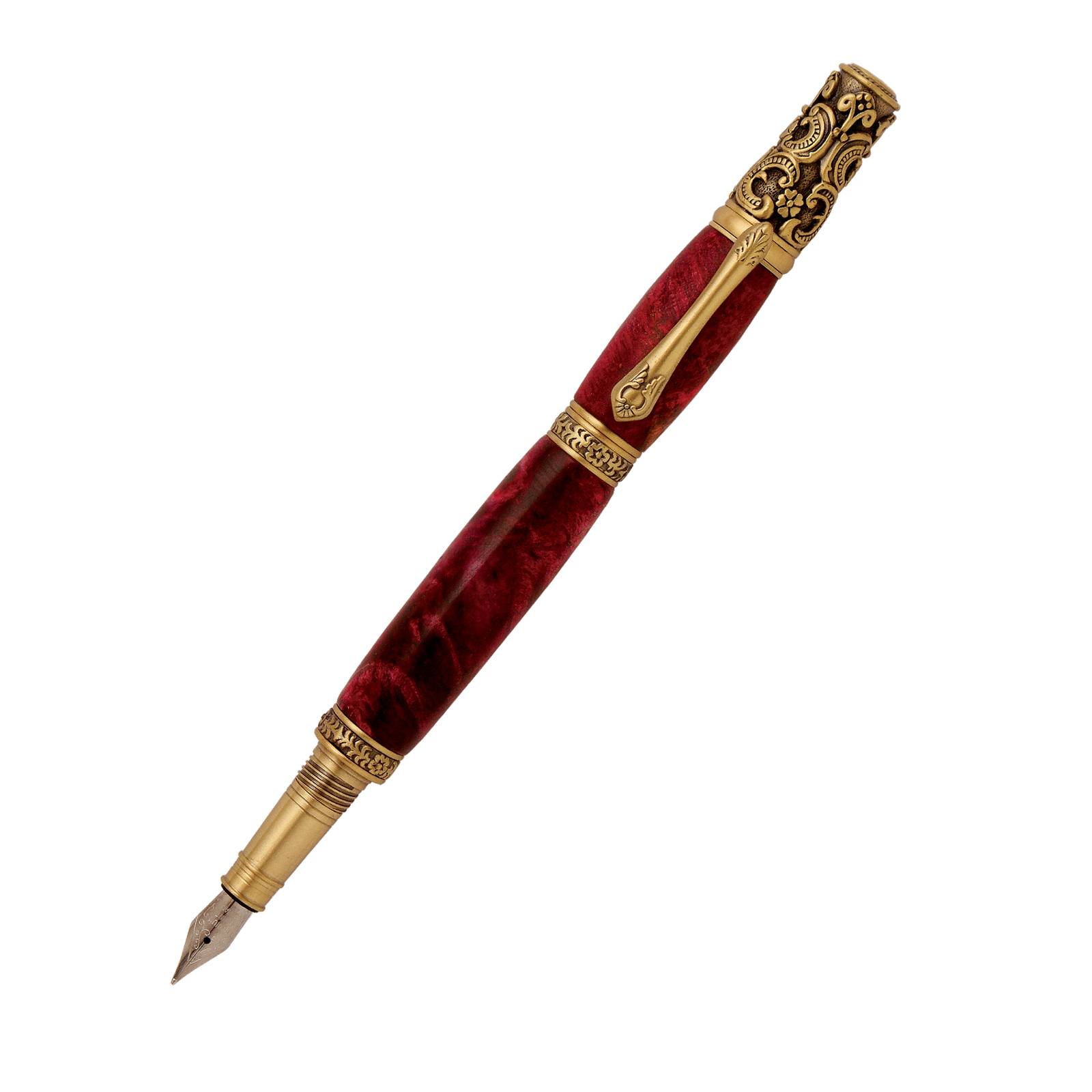

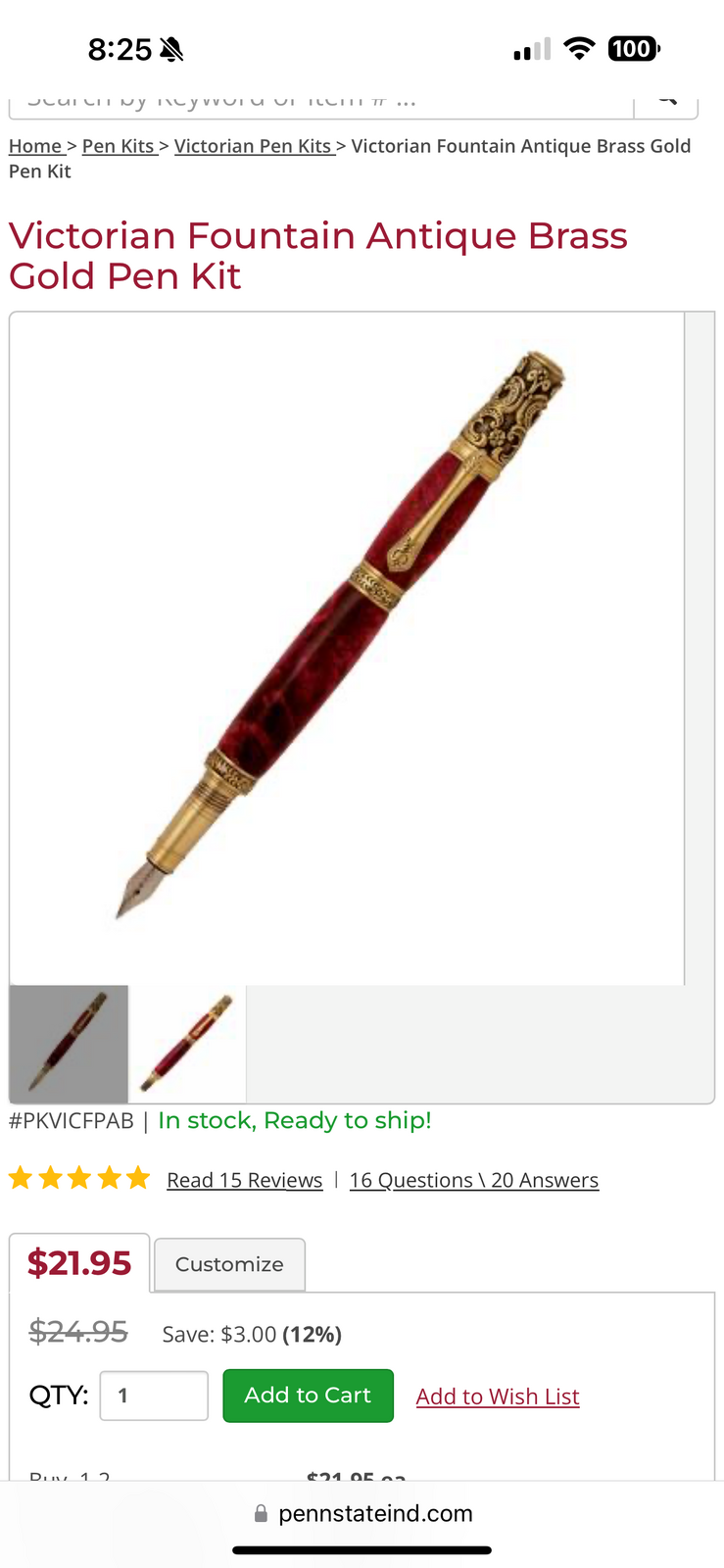

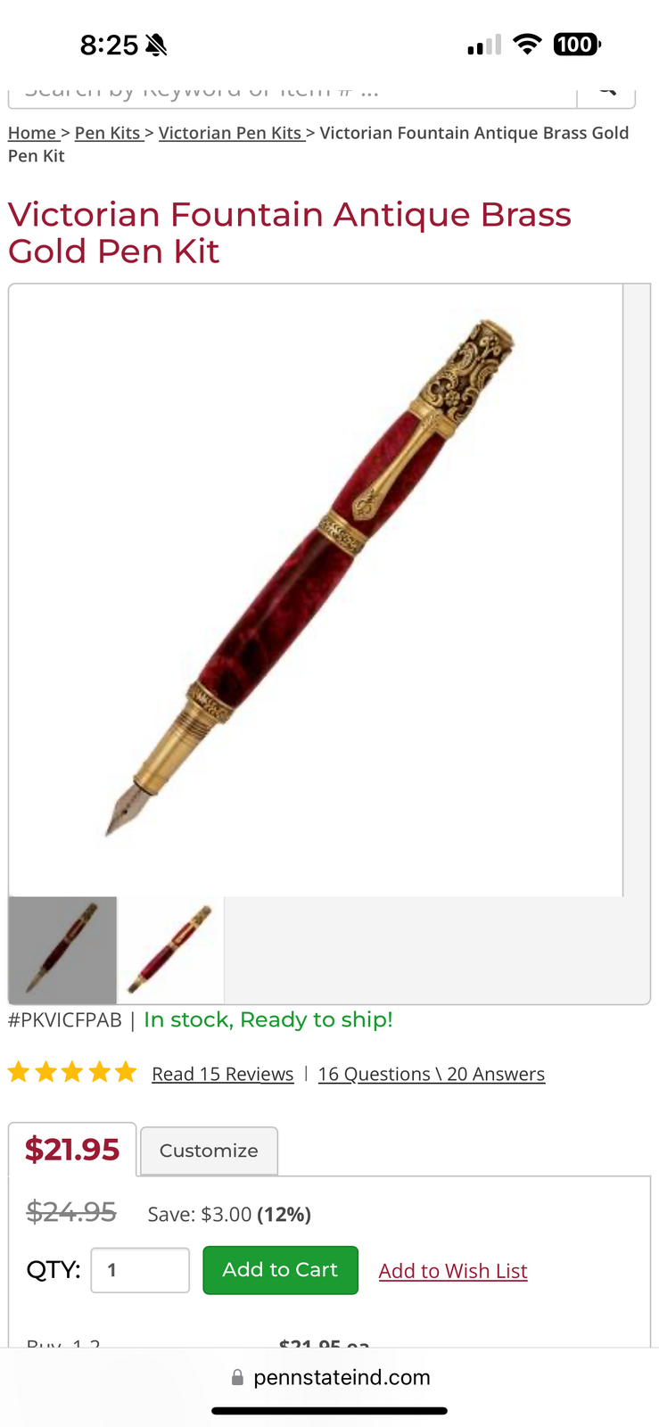

I have a customer interested in the Victorian Fountain Pen by PSI. He has some concerns about using a fountain pen, so we decided he may be better off using a roller ball instead.
But, I can not find the rollerball style anywhere, except already made!
Is the rollerball style still available and, if not, is there a conversion sold separately?
Any and all help is appreciated!
David @ Alchemist Woodwork
This is the pen kit:

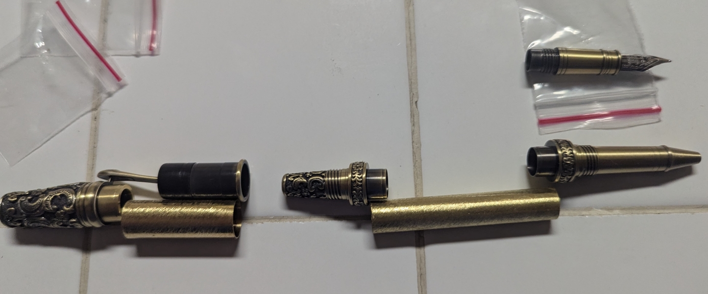

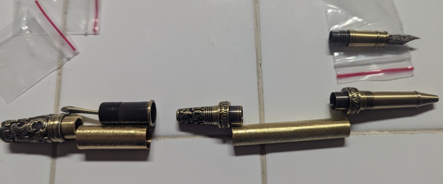

Allrighty. Victorian FP came in today.
Surprisingly the nib for the Victorian twist did not work. Neither did any JR kits.
PSI's Southwest worked, but that may not be helpful as it seems like they are killing that one off also. There are likely other PSI kits that would also work - I just don't have any on hand that did. Wouldn't hurt to drop 'em an email.
Also Woodturningz fountain pen conversion (pkfpc-abr) worked, so any of their kits that can use that nib will work. According to their website, this nib works for a " Voyager, Commander, Scuba, Pirate, Golfer, Owl, Cobra, Sealife, Sea Turtle, Elephant, Scorpion, Shuttle, Chess, Train and Amazing Grace"

no prob. Maybe you can sell your customer a rollerball with "bonus" fountain nib as a one-off.
For the one I've got I'll probably sacrifice a Woodturningz kit like I mentioned. Kind of a waste of a kit but I've learned that having spare parts around never hurts.
Here's a not very good pic of it laid out.
