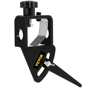

Does anyone have this jig? I am new to this and it did not come with instructions. If someone has something similar and could take a picture of how to set it up with a bench grinder, I'd really appreciate it!

This appears to be a clone of OneWay's Varigrind jig used with their Wolverine system.
For me, if I have or am buying OneWay quality, why would I want to buy a clone jig to go with it?

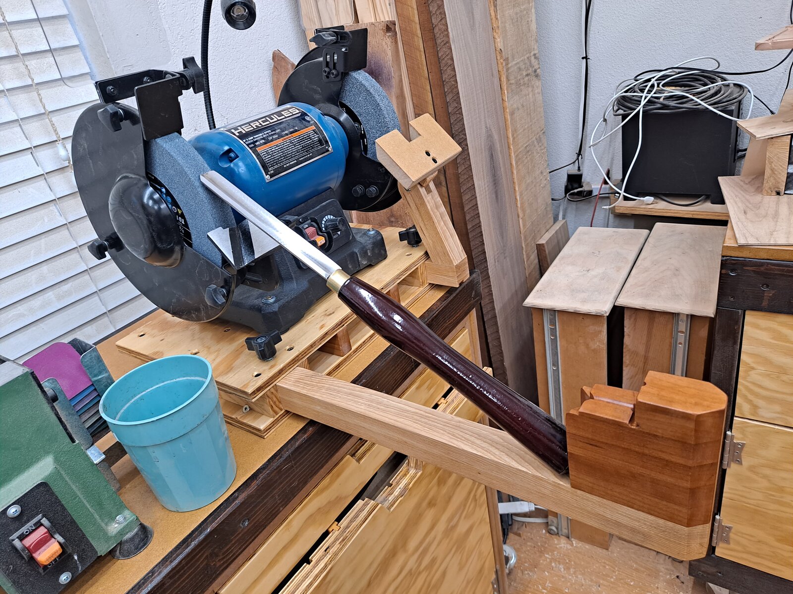

That jig is designed to be used with the Wolverine Sharpening system, but it should work with a homemade version of that system like this one that I made. Here are a couple of the videos I referenced. That jig would fit in the upper notched portion.
