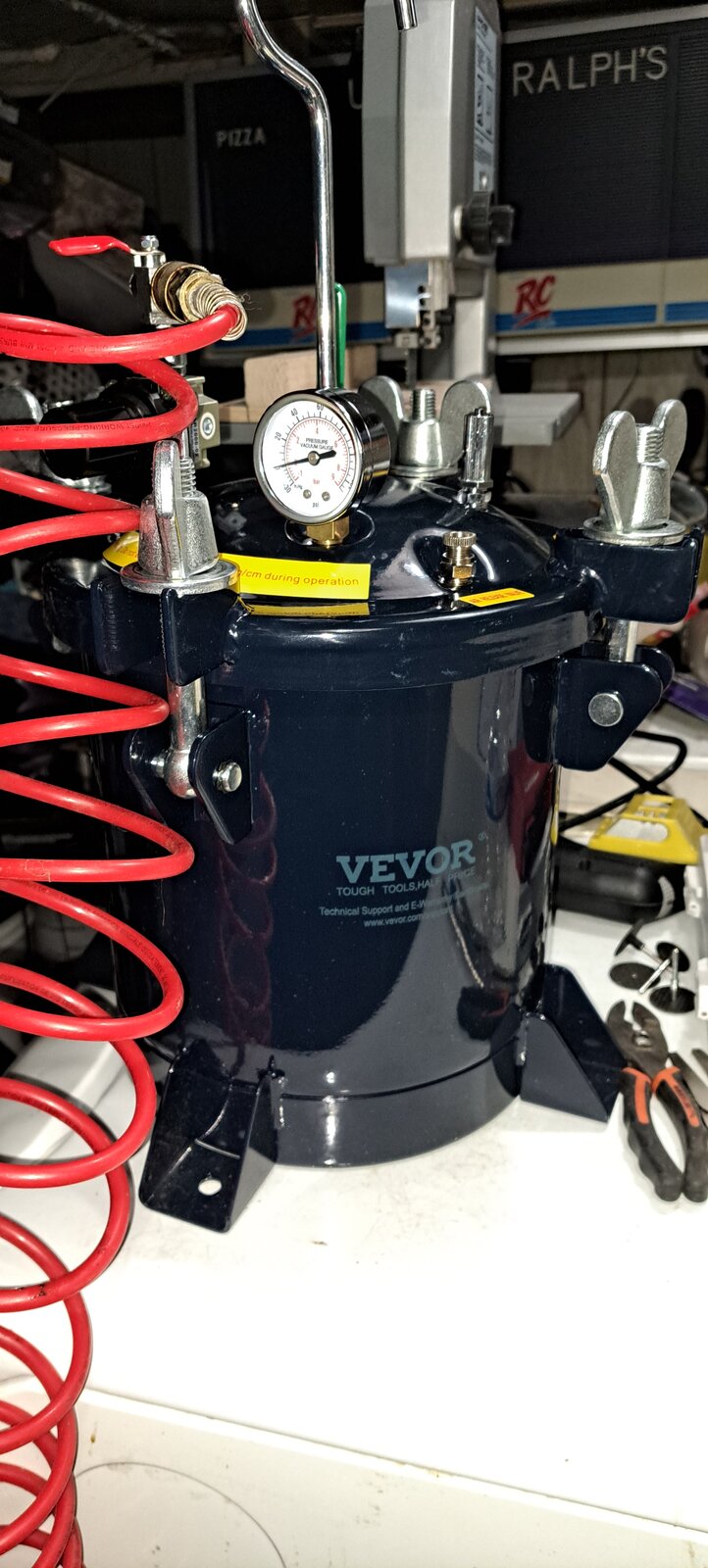

I just got this vevor pressure pot. and its built like a tank LOL anyway did anyone here get one too? I'm having the hardest time removing the paint tube from the lid.

I just got one - so far I haven't been able to remove the tube, I'd like to get it out intact if possible but will probably have to resort to a Dremel too.
I pressurized it to 45psi a couple of days ago and it's held that pressure well, so it seems to be working.

What pressure is the tank rated for? I've noticed that Paint pressure pots have a rating around 30psi, which is a little low for resin casting.
