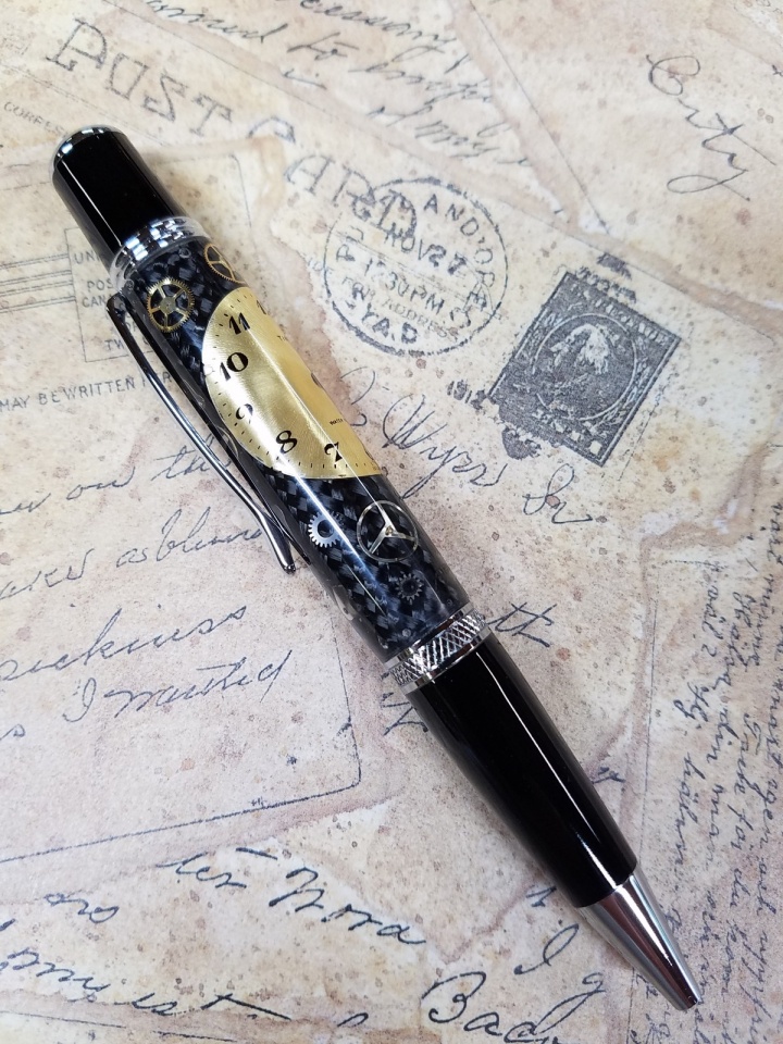

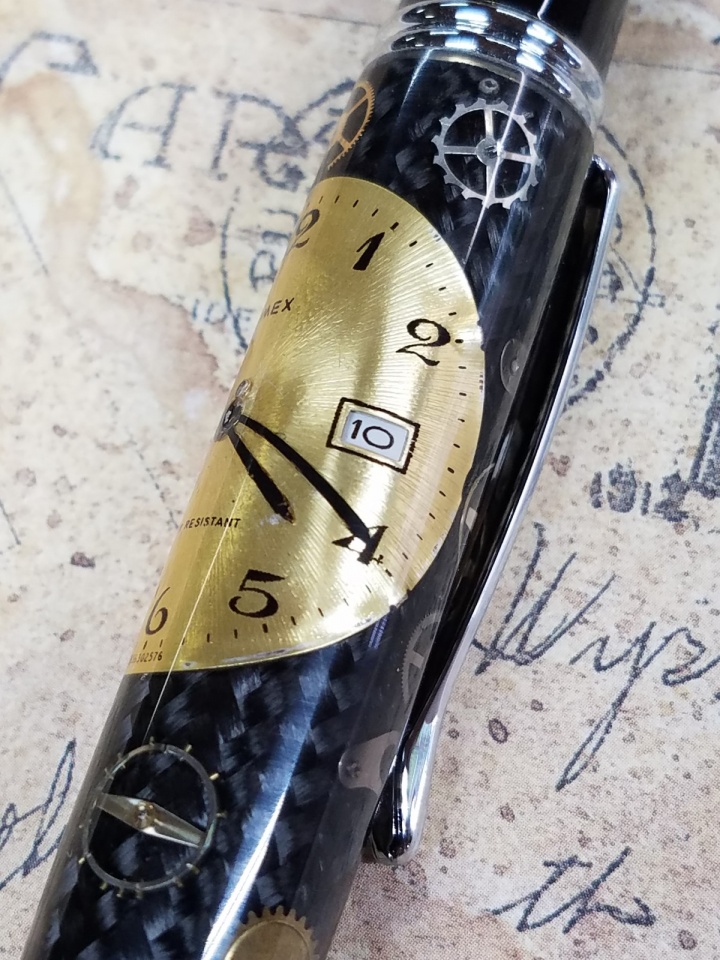

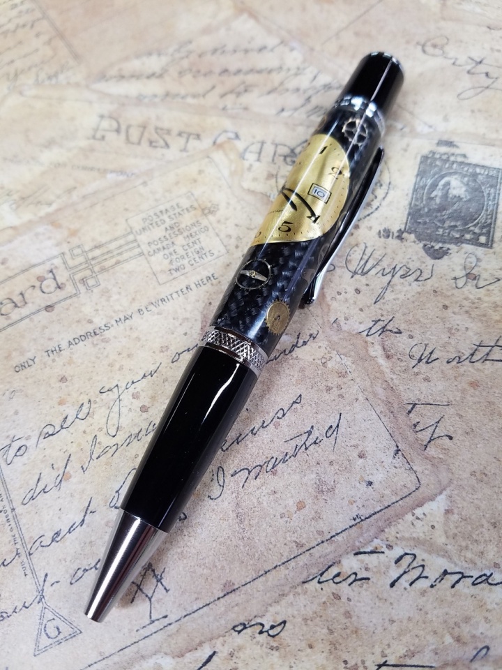

Another pen casting with Liquid Diamonds resin and watch parts. This is a very special pen, as the parts came from the watch that belonged to my Father who passed away on Sept 10 1972 at 4:20 pm. I incorporated these details in laying out the parts for casting. The time on the watch is set to 4:20 and the date is set on the 10th. The watch had stopped working years ago and I think this a fitting way to make use of the watch and to have something that can be used and passed from generation to generation.

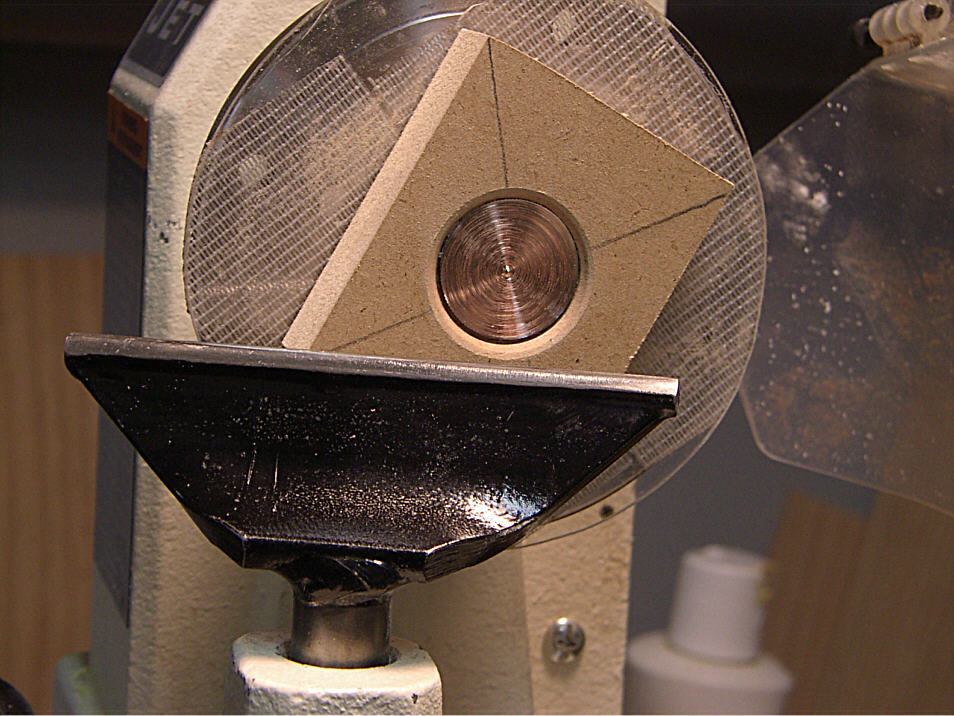

I've been thinking about making a watch pen using the watch my parents gave me for HS graduation 62 years ago. The back of the watch has an inscription that I would like to incorporate in he pen, it is substantial metal. Can someone suggest a way to "thin" the back so I could bend the part with the inscription around the pen tube?
Belt sander or if you are good with the lathe make a jig to hold the back and use a scraper to thin down or a carbide cutter. I happened to use a detail gouge on this one. You have to get creative. I have turned down coins both ways so it works.
