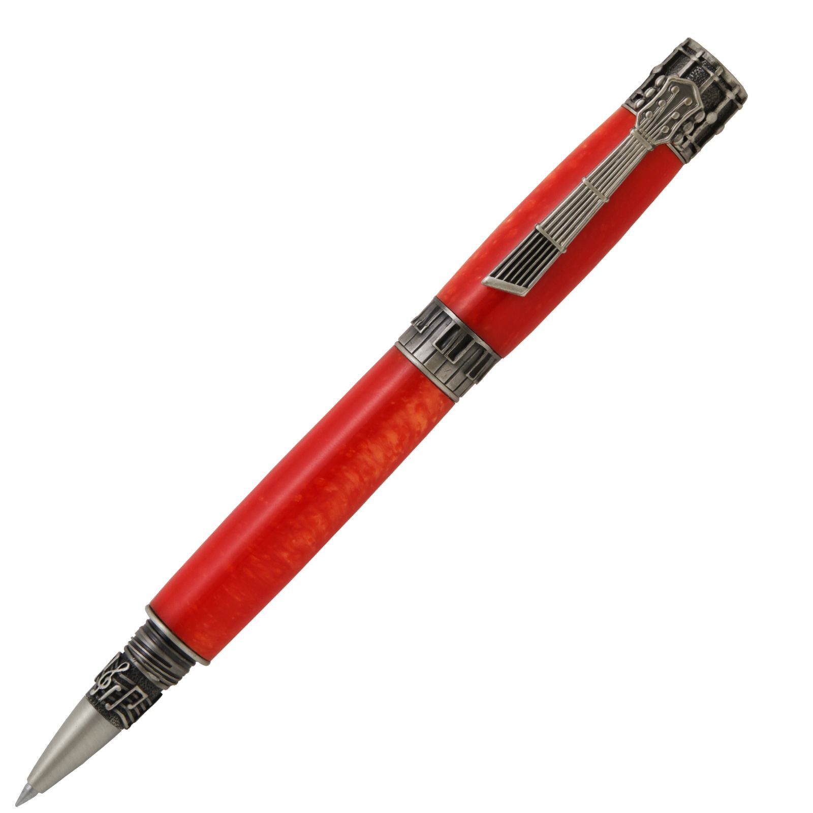

Since it's from Elvis' bungalow, why not try making a Music rollerball kit from PSI?
I thought about this one but after really looking at it I'm not sure it's the right fit. I'm going more for a Hawaiian themed pen but this is a good idea. Thanks.

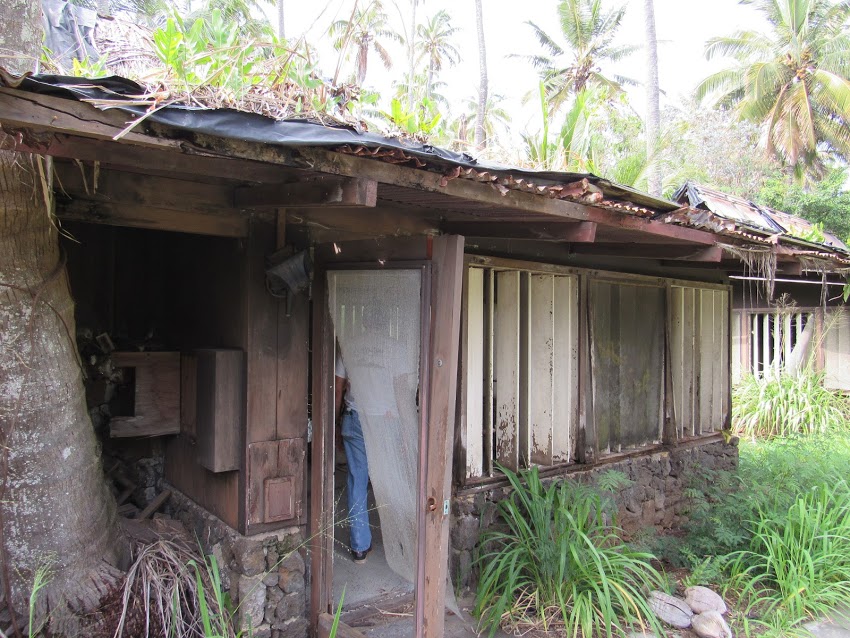

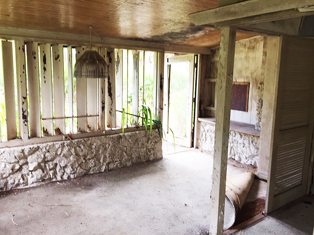

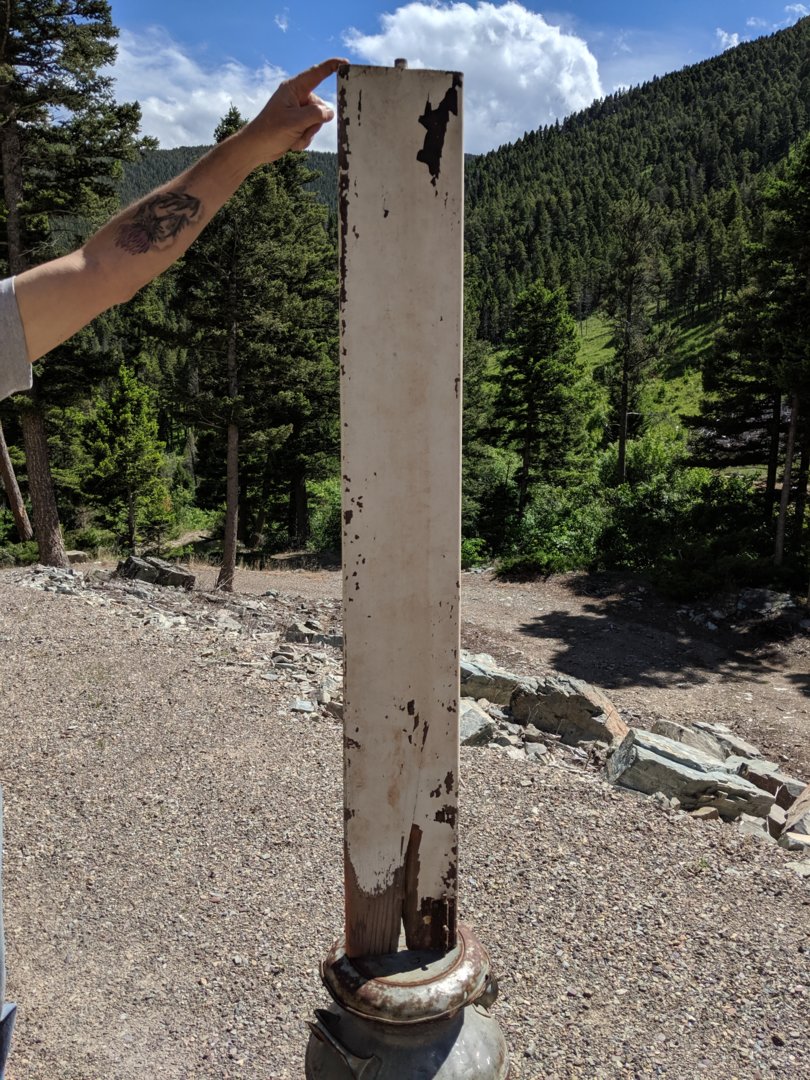

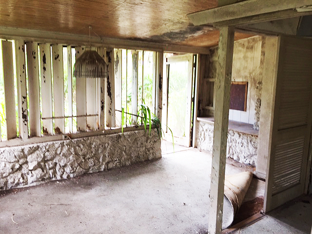

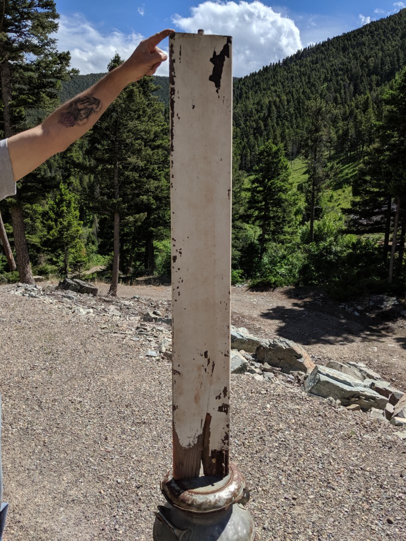

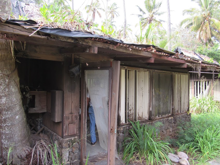

Here you go Chuck. The first shutter on the the right of the door is the one I have. The person you see in the Elvis Bungalow doorway is Bob the tour guide. I'm not sure how all these will post but the rundown building is the Elvis Bungalow as it was in 2016. There is an inside picture of the bungalow that shows what the inside looks like in 2016, a picture of Elvis inside the bungalow back in the day and a picture of the shutter at my home. That's a view out my front door. Hope you like them. Elvis slat.JPGElvis slat.JPGIMG_20190625_160510.jpgelvisbungalowfull.jpgbungalowliving2.JPG

Anytime you want to stop by feel free. If you fish be sure to bring your favorite rod and reel as I live 12 miles away from some of the best fishing in the country. And the view you see there is out my front door. I'm actually standing on our driveway with the shutter perched on an old milk can.
Thanks Tom. I doubt I'll ever get there, but I'll keep it in mind. So what I thought was your backyard, is actually your front yard. Beautiful view from any angle.
