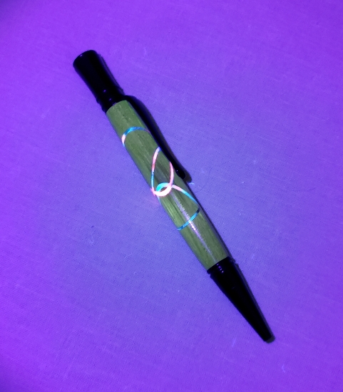

One thing I notice about fluorescence is that the CA seems to glow, so ID'ing wood after it's finished can be misleading. It is cool, though. This is purpleheart under a (supposedly) 365nm light.
