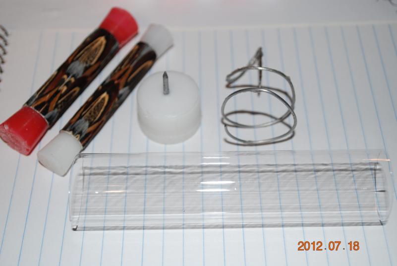

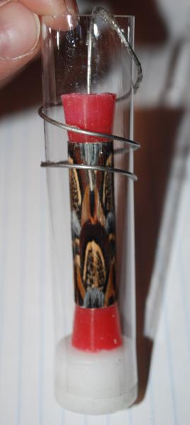

Attached are his pics which are pretty self explanatory.
Two silicon plugs in the end of the tube. He uses a delrin plug for the outer tube with a nail to hold the base silicon plug centered. I made my plugs from silicon putty which bonded with the silicon tube plug. Then the wire to hold the top silicon plug centered.
John orders 1 inch clear tubes, I grab T-8 bulb protectors from Lowes which are about 1.25 inch.
Have fun.

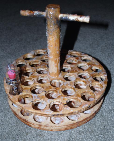

My set up was all CaptG. Gary is the Master! I just came up with the wires to stop the tubes from falling over in the tubes.
Its good to see that my wooden holders are not the only ones covered in PR
Lol, yep, what you can't see is that I stepped on it and broke part of it but CA glued it back together. Someday I'll find time to remake one.

Bit of a thread revival, just wondering what material the clear tubes are that are shown in the pics? Have silicon corks, just can't work out a suitable clear tube!!
They are flourescent light bulb protector sleeves, we got one at the big blue home improvement store. There are two sizes, we got the thinner one.
