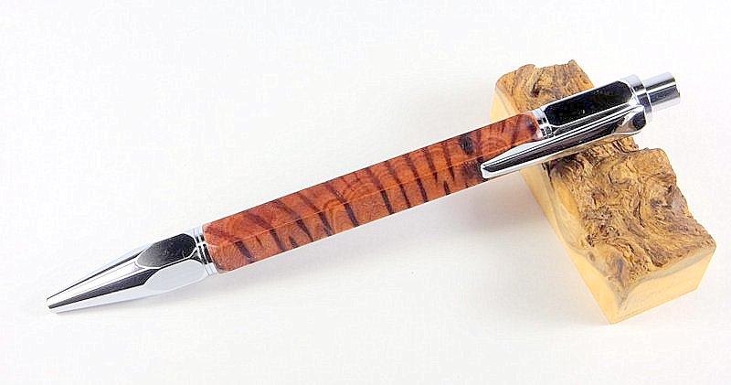

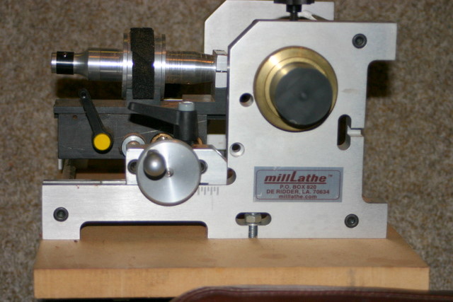

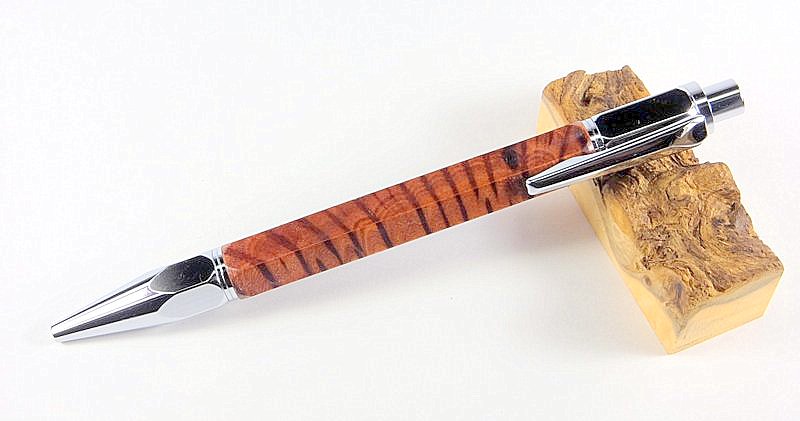

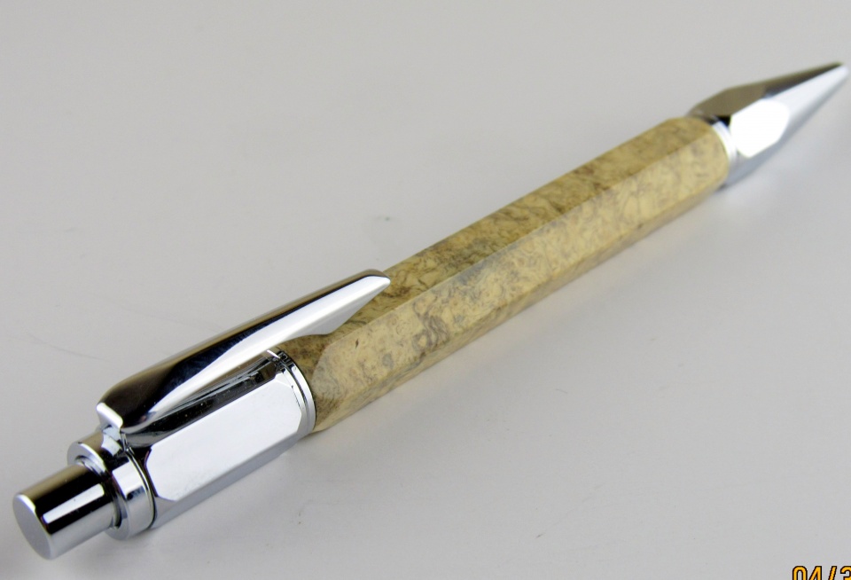

The blank is Black and white Ebony burl. Not as much black as there was prior to turning. I've made several nice pens with these blanks...

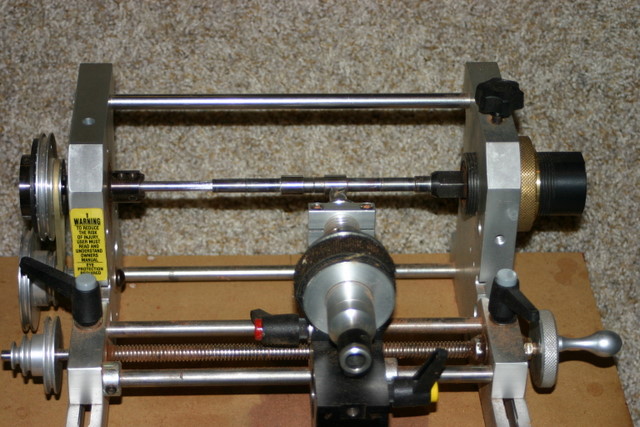

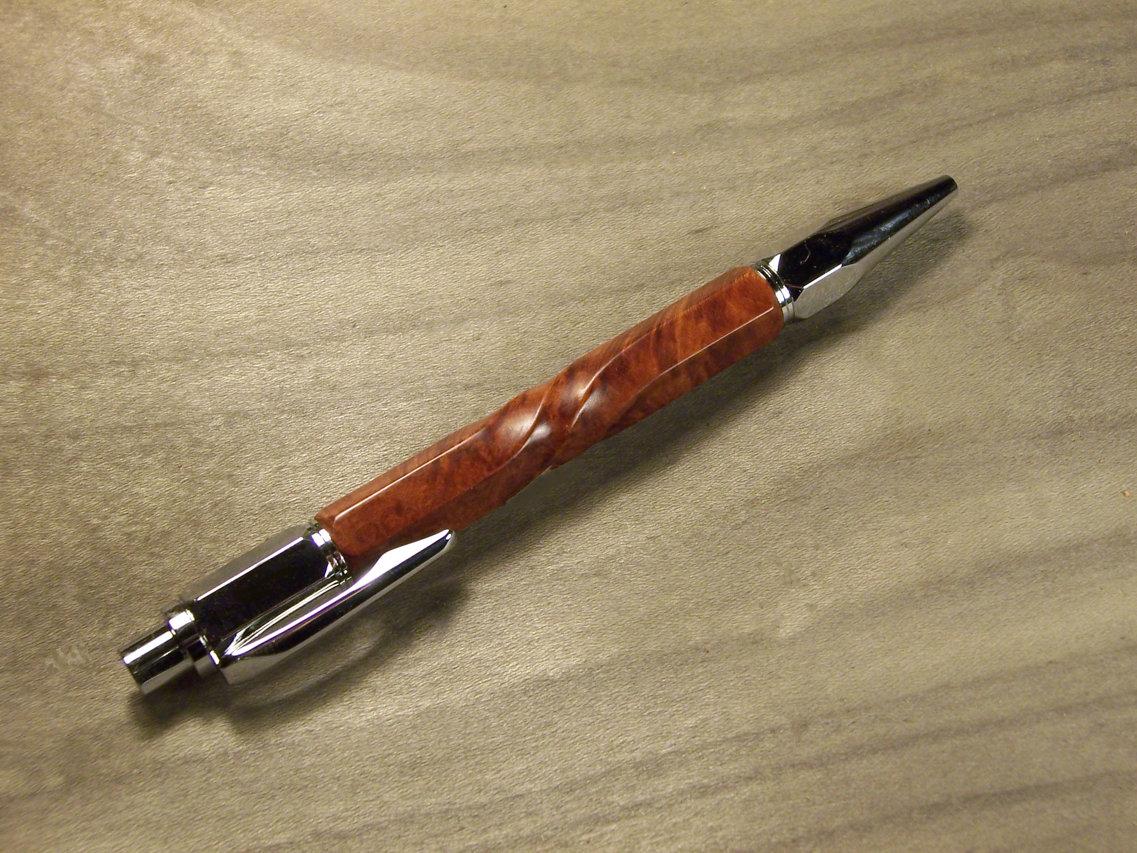

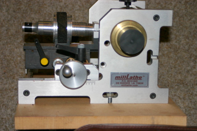

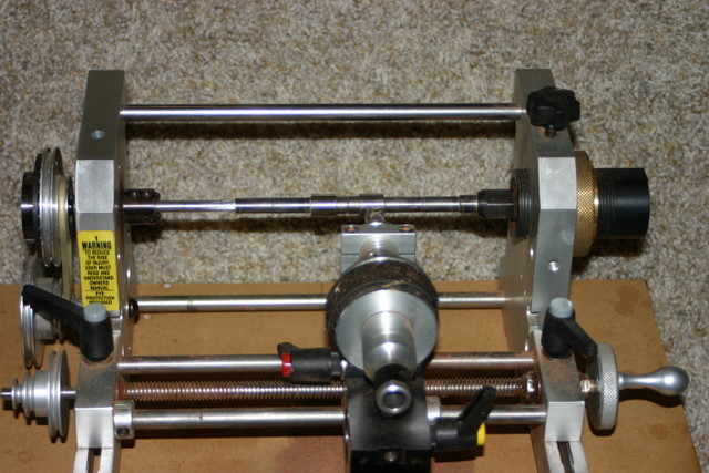

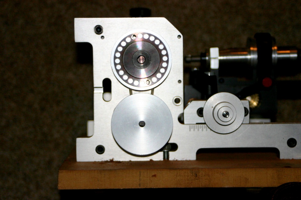

The faceted blank was made on a Pen Wizard type tool called the MillLathe. The MillLathe was sold by Woodcraft and discontinued about 2005. I have all of the attachments but have not used all of them. I use it to do these faceted barrels and rope twist barrels. I'm sure it will do much more but I've not really pursued its capabilities.
I use 1/4 inch shaft router bits held in a Foredom 44T handset powered by the Harbor Freight Foredom-like tool.
I have been told that the man who manufactured the MillLathe has a building full of them but is unwilling to sell. They were made in DeRidder, LA.

Very nicely done, Don !!!!!
The wood is beautiful, and unique ... never saw black and white ebony burl before !

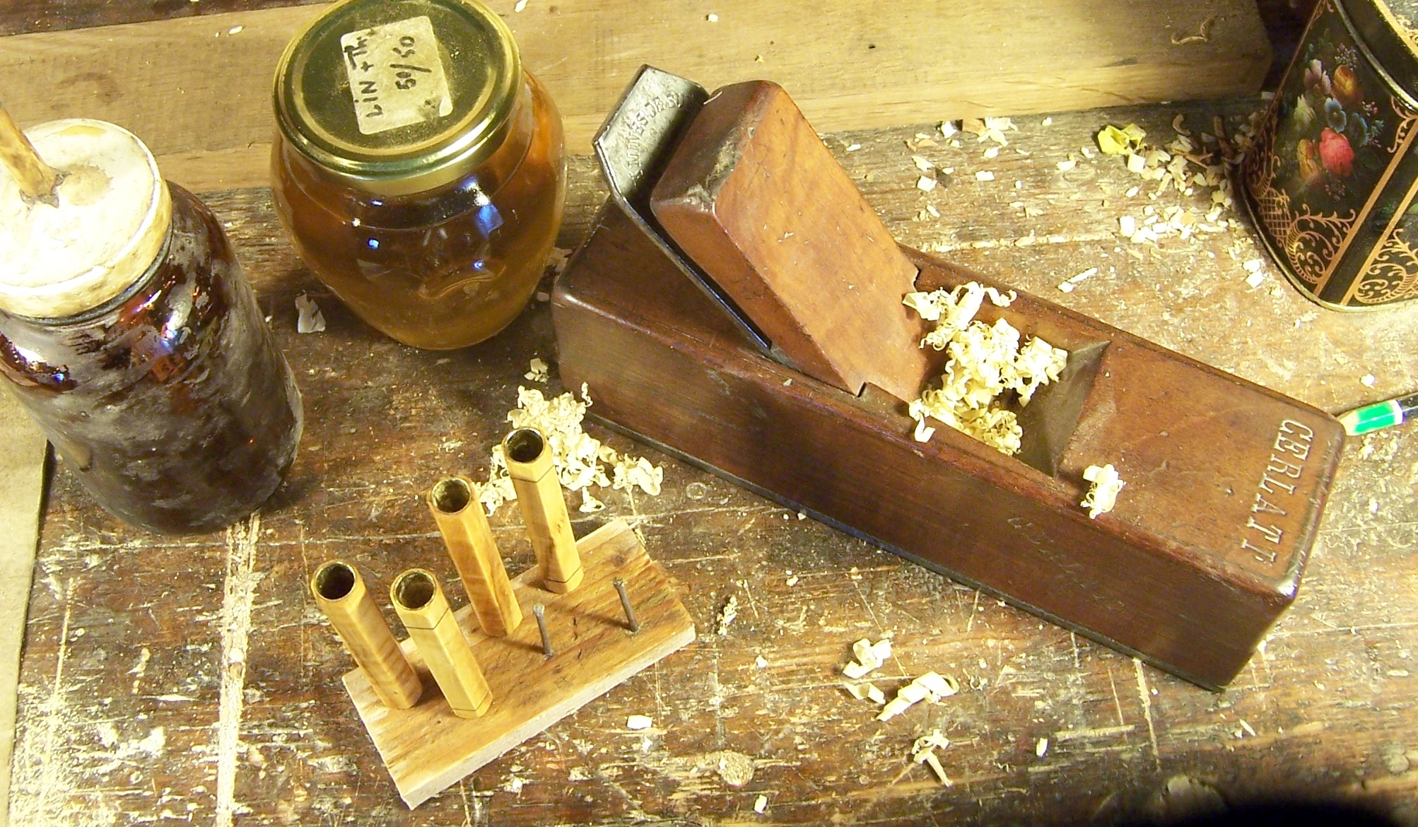

Yours are nice also and well done..especially with hand tools. I am impressed. Show us more. Thanks for sharing.

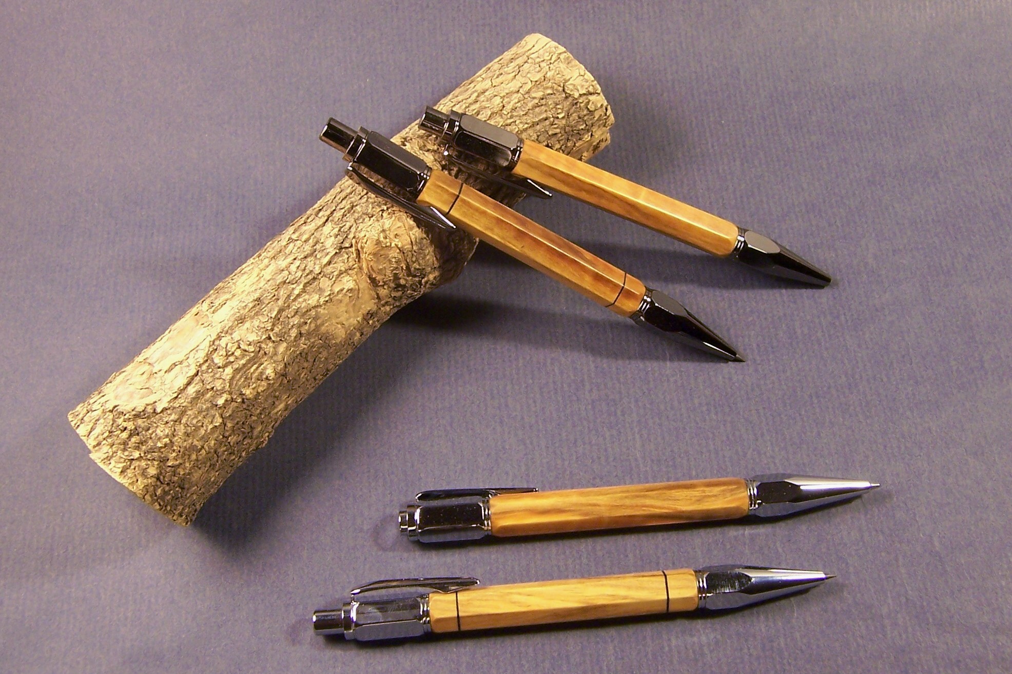

I know you Yankees are not necessarily handtools enthusiasts, but I shall nevertheless show you my MillLathe, less expensive, easier to find and for sure a fast worker:
Thanks Peter. You have some nice modifications to the pen wizard. I looked over your posts in the PW forum. I have gotten mine down and started working with it again. I have been reading the PW forum again.
Pierre and I are going to collaborate on an article about the hexagonal and octagonal barrels for the vertex. I will use the PW and Pierre will outline how he does them with hand tools. We are planning to have it finished mid June.
