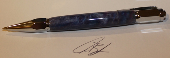

So this was my first attempt at a 3 color cast under pressure. Wow, what a difference pressure makes in the material. It might be psychosomatic, but it felt like the PR was more dense when holding and cutting it. :bulgy-eyes::bulgy-eyes:
Anyway, it's Silmar 41 with lavender, true blue, and pearl white in the mix. I was excited to try it out so I don't think I let it sit as individual colors long enough. The result is that the colors muddy each other. I feel lucky that the pearl white even showed up. Overall, I think the pen turned out beautiful, even though next time I'll do it a little differently.
Thanks for checkin' it out, and C & C are much appreciated.
