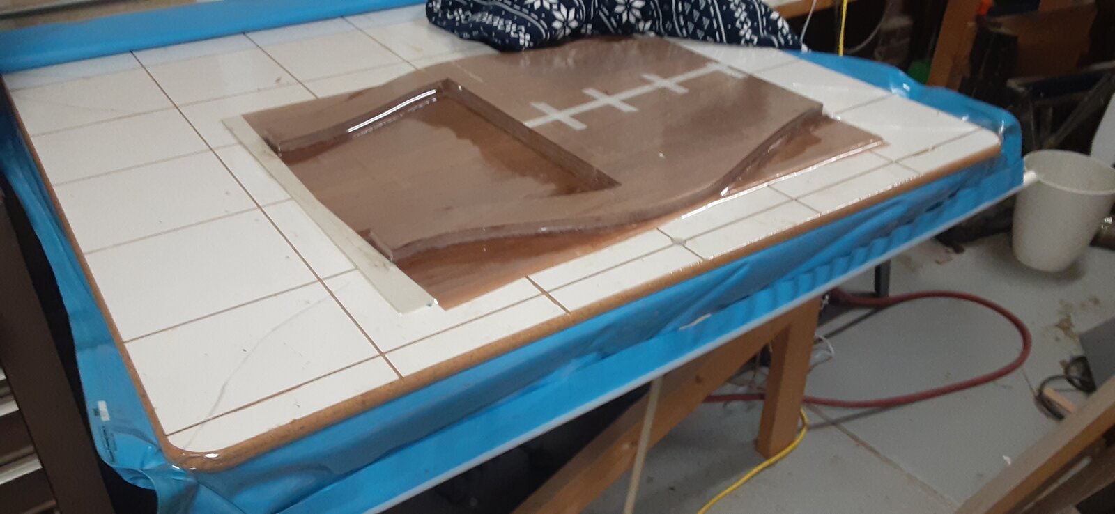

My kitchen table Santo Domingo rosewood, and quilted maple. The base is made with 1/8" layers of cherry, also done with a vacuum bag.
Heres the vacuum bag in action this week:
