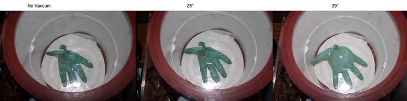

Don - Here's an example of the difference between 25" and 29". If 25" works for you, then great. For me, I wouldn't even bother with vacuum if I could only get to 25". Using heat and vibration (as advocated by some successful casters here) would be more practical than a venturi fo rme.
But to each their own.
