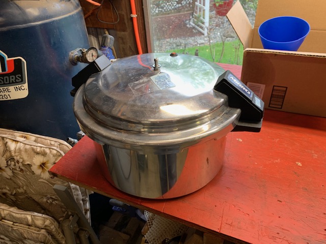

I picked up a mirro 12 qt pressure cooker. It is 14 inch across, I am planning to replace the top with 3/4" plexiglass. Is that strong enough ?

Plexiglass is ploy methyl methacrylate, the rule of thumb that "like dissolves like" suggests that Plexiglass won't hold up well against acrylate stabilizing resins. That said, others have said that 3/4" holds up reasonably well. However, I'd suggest trying to avoid getting liquid resin on the lid .

My lid is less than 3/4" and it's held up well. As mentioned, try not to get the stabilizing resin on the lid. I did once and didn't wipe it down right away. Our hot, dry desert air made the resin cure and now I can't see through the lid so I need to replace it.

I've been using 1/2 Plexiglass ( https://www.amazon.com/gp/product/B00P48KVZ2 ) for a couple of years with no issue. Using it on a 6 inch PVC pipe chamber, as well as a few 2 inch wide, but tall PVC tubes. Nice thing about a big flat lid with a center vacuum fixture is that you can use it with a variety of differently shaped chambers.
