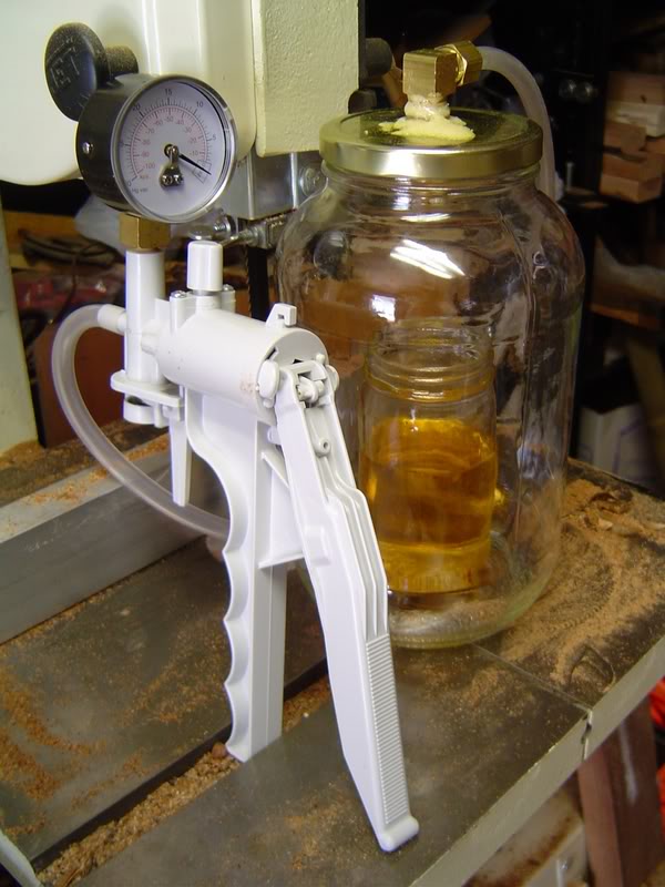

here's my version of a hand pump made with a half gallon glass jar and i get 20in of vaccum. i have a one gallon jar i have not yet setup. i like how it works. it works for me. i only stabilize what i want to turn the next week. i use a 50/50 solution of oil base polyurathane. i bought the hand vac at the local auto parts store.

Laurie-
Other than the solution you are using, that is exactly what I started with 2 years ago.
Since I started with acetone and plexiglass( as others have switched to and like) the acetone had a detrimental effect on the plastic parts of the pump when the pump dropped lower than the vessel.
The HF venturi pump with a compressor beats the hand pump version for my money.
AS long as it works and you are satisfied that's all that counts.

thanks big guy, i'm sure that when i get turn more often instead of working a real job (locksmith), i will move up to a motorized vacuum. as you and i said for that one corncob a week it's perfect.
