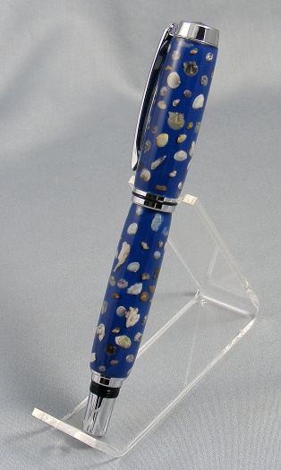

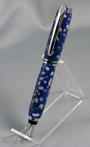

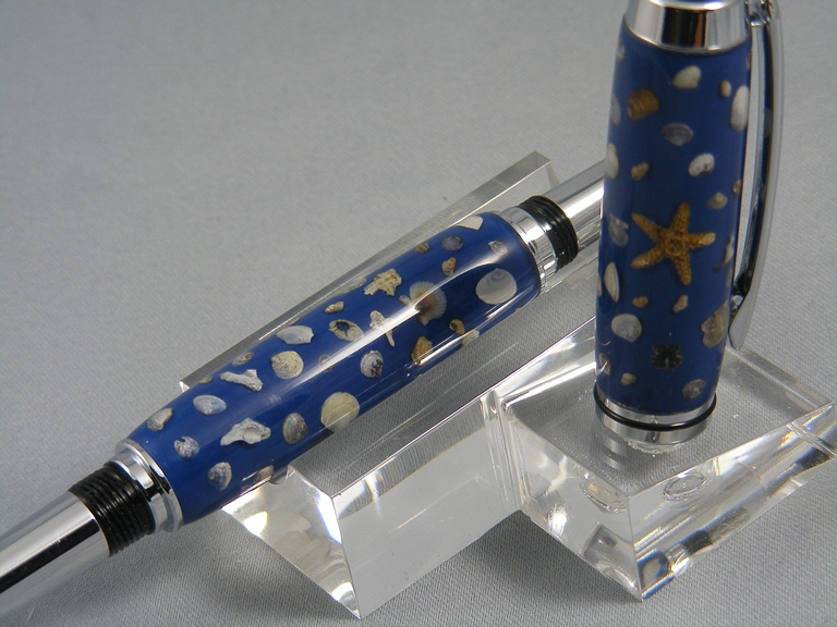

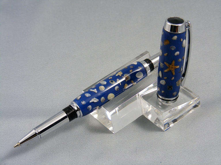

Whenever I go anywhere, I like to bring something back that I can 'hopefully' turn into a pen. I've done these before with shells from Fl. These are from Provincetown, MA. I was pretty pleased with the outcome. They are fun to do and I hope you like. Tubes are painted blue, all shells indiviually glued, then cast in clear resin. Comments/criticism always welcome. Thanks for looking!

Jennifer, that is a beautiful pen. Did you hit any of the shells while turning? If not, do you do any precast measuring so you know what you can get away with?

Harry, I do them by eye. I have turned into a shell occassionally, but ca will usually do the trick. I appreciate all the kind words!
How in the world did you find a starfish that small?

Jennifer, I really like your pen and the execution is beautiful. May I ask two questions? Are you using CA for the gluing and is the PR or Alumalite that you are using for casting?

Thanks for the nice comments!-Cindy, yes ca for the gluing of each shell,then glue the whole shell to fill in any voids in/around shells-cure at least 24 hours to gas off-then PR.
