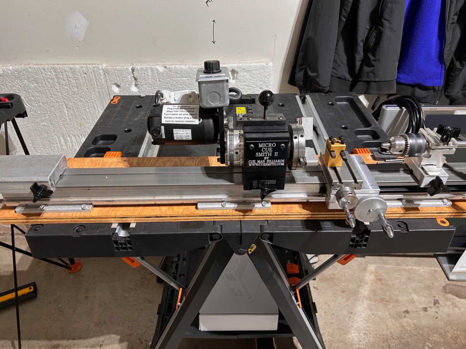

I'm currently setting up Taig pool cue repair lathe in the garage. Will work with door open. I just ordered the Mullet top mount 2" arm. Will use with a Shop Vac. (New HEPA filter on order.)

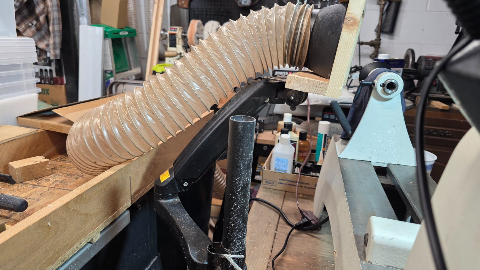

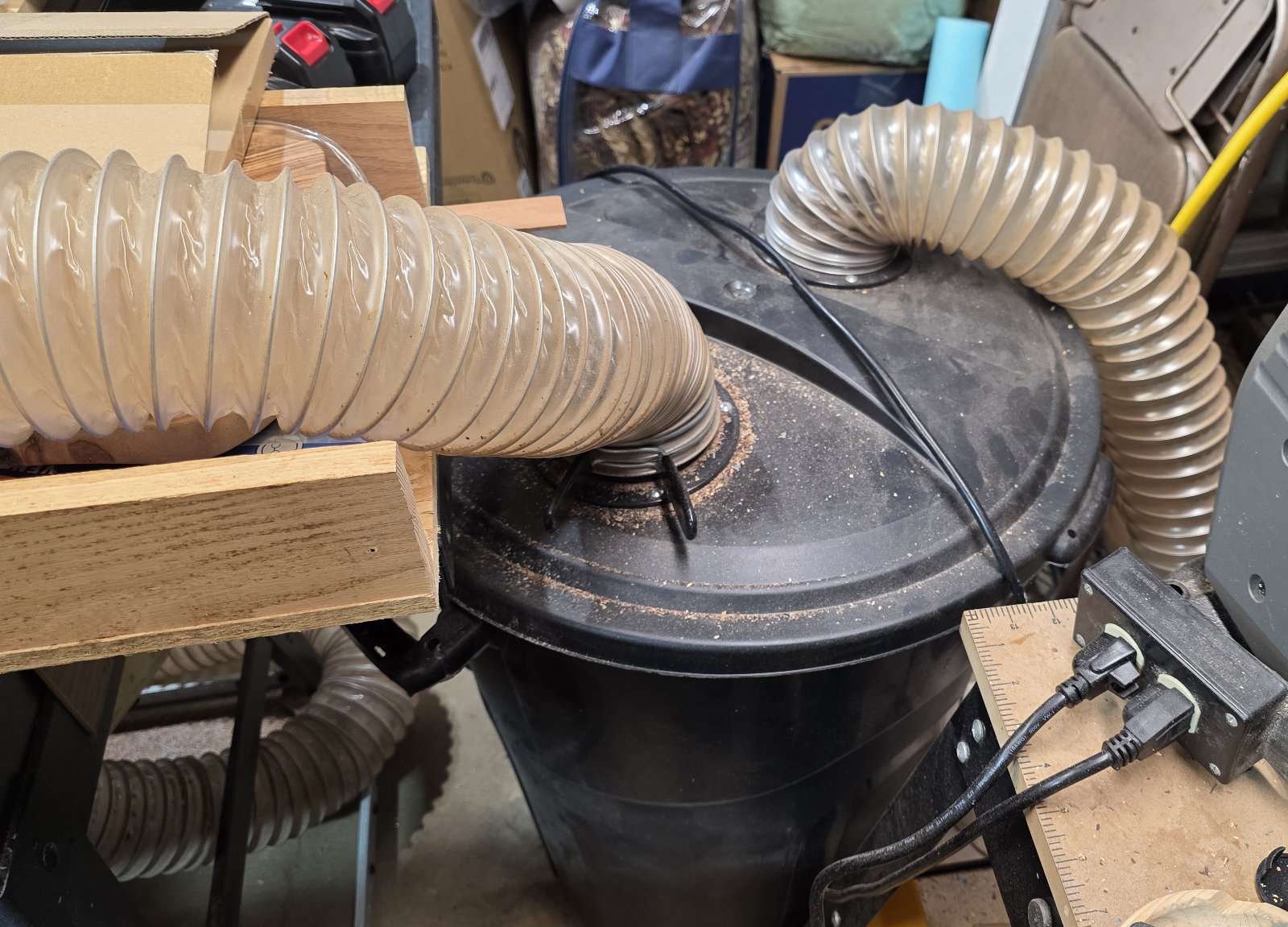

Eeek, the shop is a disaster right now. It's embarrassing, but here you go. The 4" hose coming out of the collection can goes to a portable Harbor Freight dust collector. Shop vacs are just way too loud. This set up could use some tweaking, but it suits my needs quite well for now. I can move the hose to the table saw or band saw pretty easily.
The collection can is a cheap trash can from Walmart with fittings to make it similar to a vortex collector (though not quite as effective) and some door frame insulation stuck around the rim of the lid. I don't understand why people let larger pieces go through their dust collector impellers before getting to the collection chamber/bag, but it's not my money they're using.

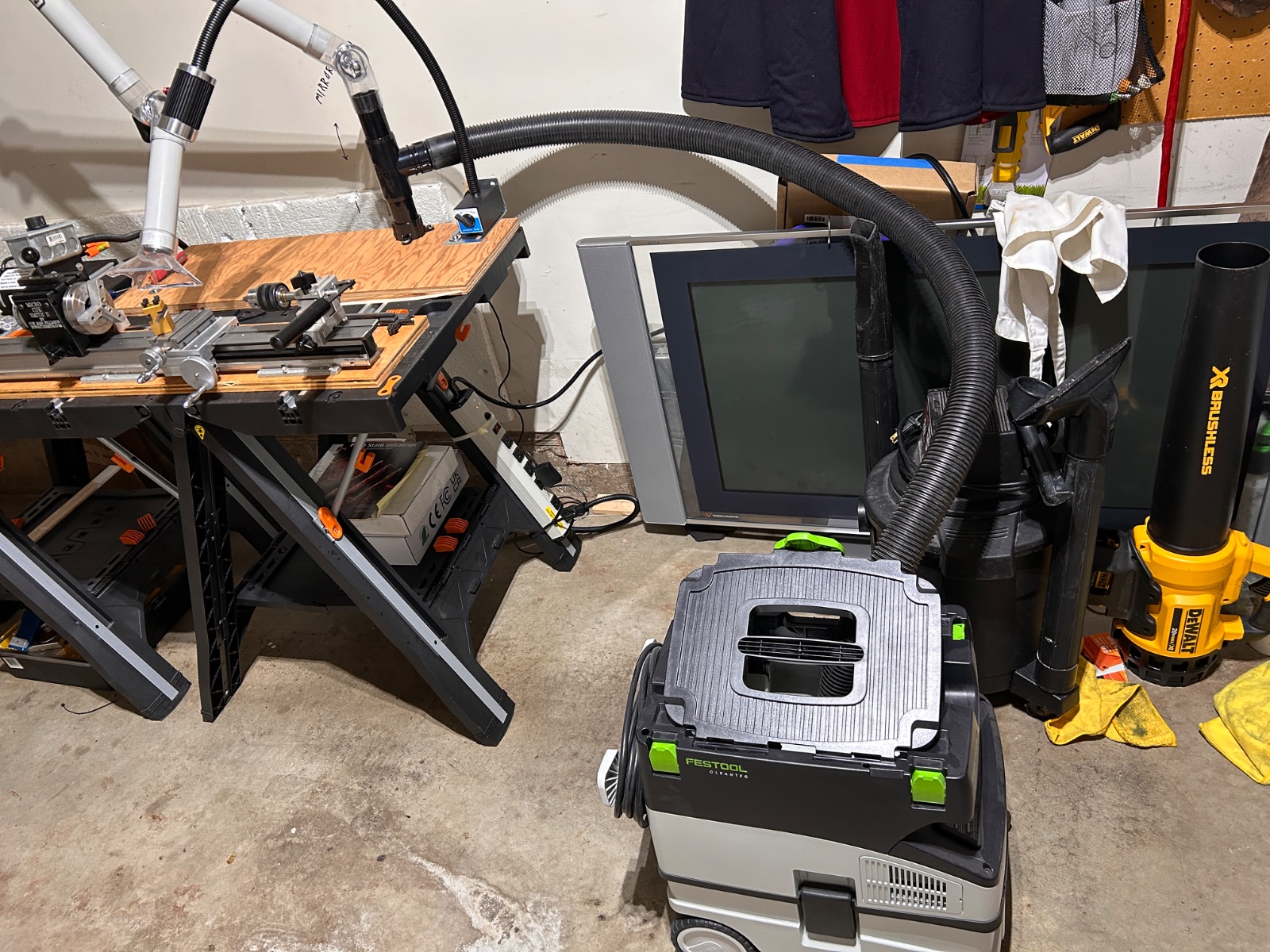

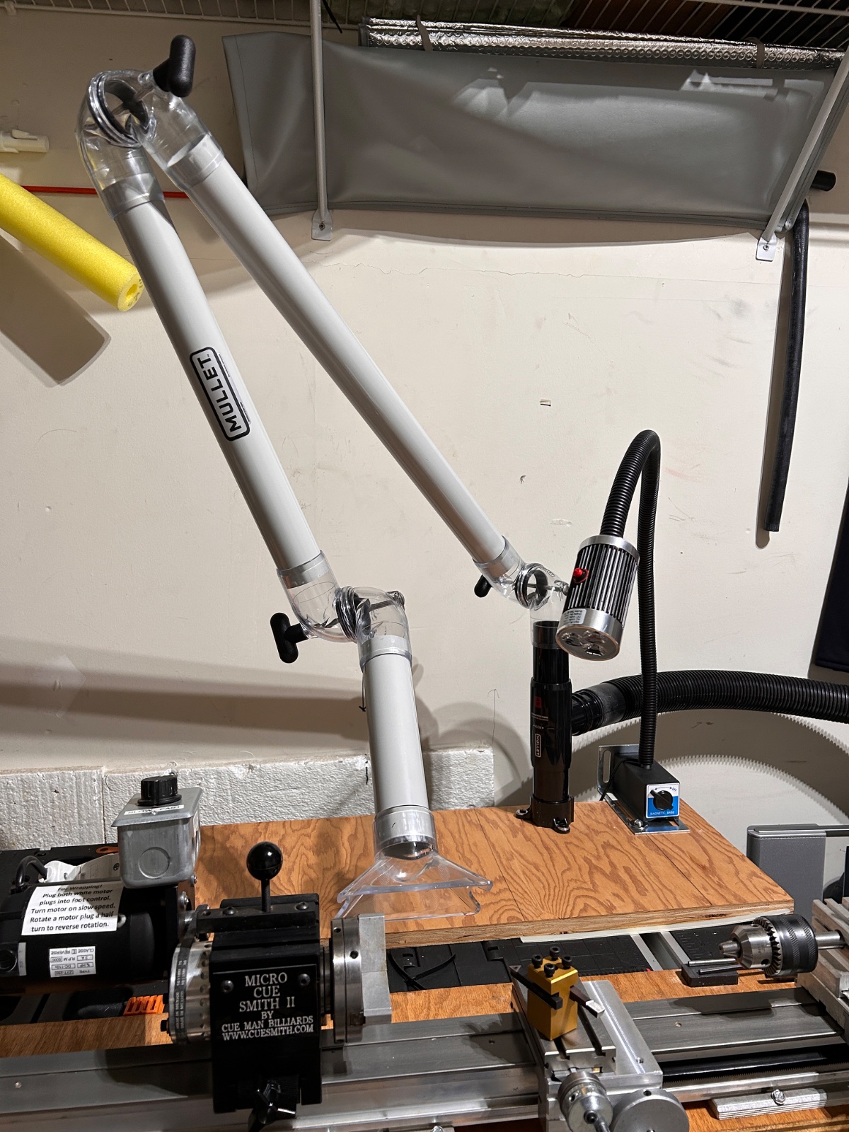

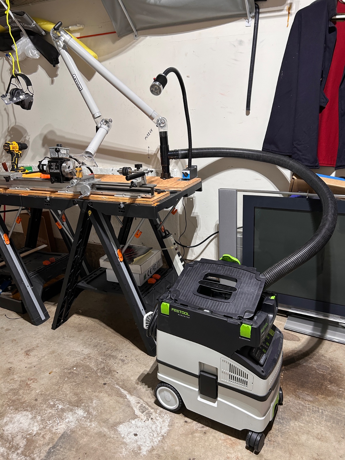

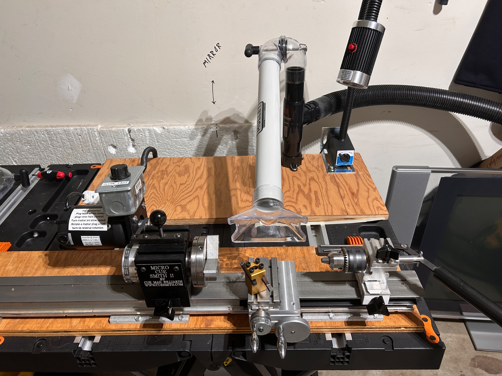

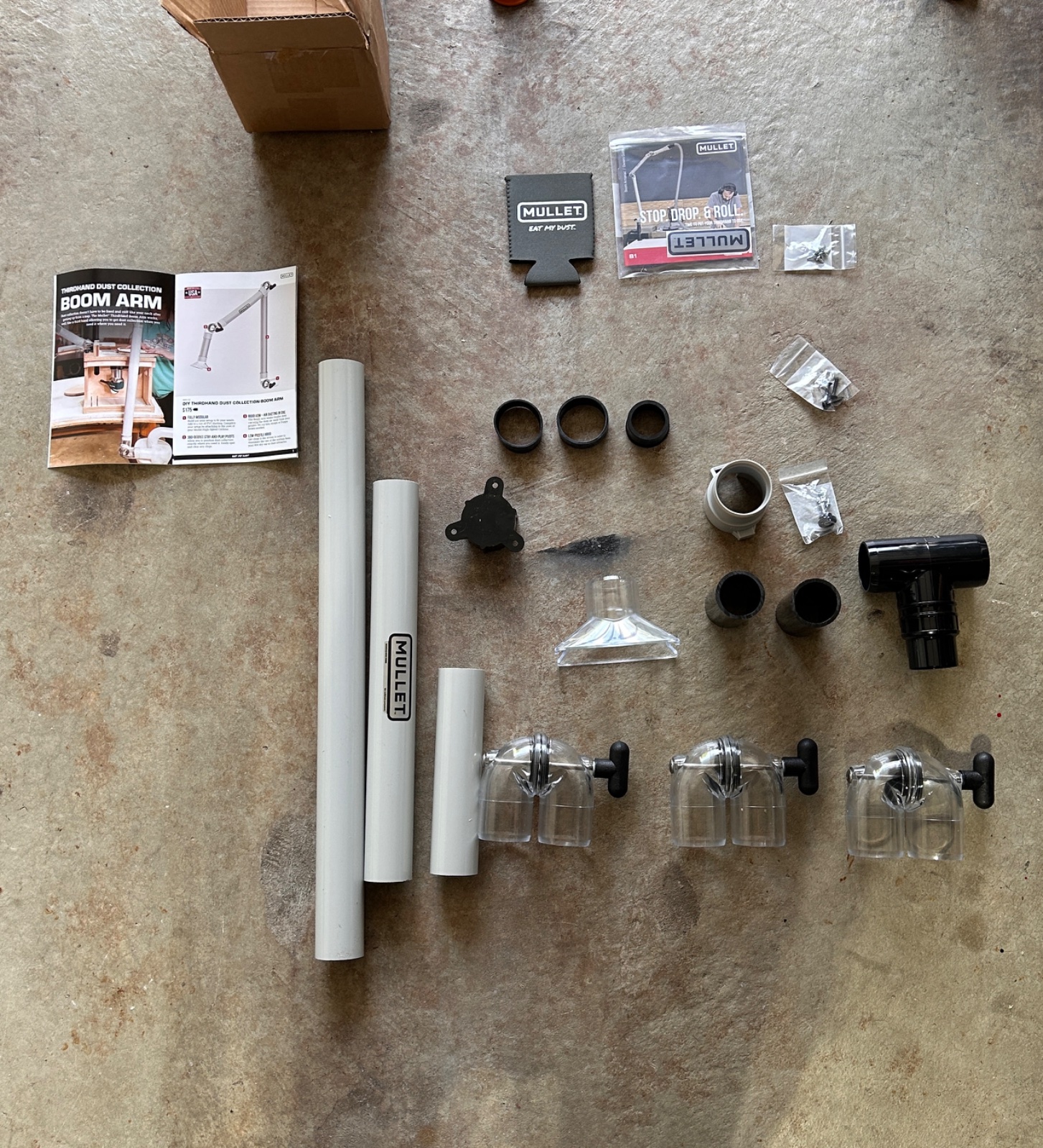

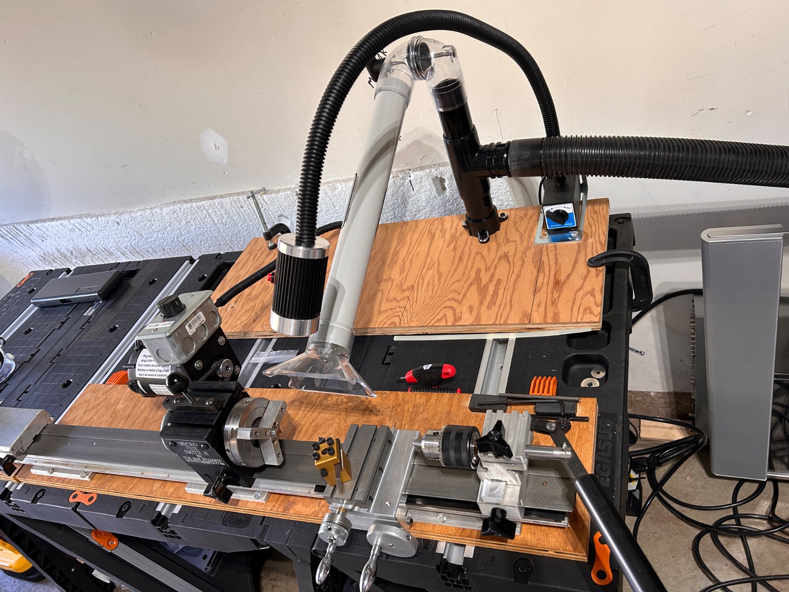

The Mullet Boom and Shop Vac will used on the Taig lathe. No many big pieces..
Mullet is sending a custom tube. Might need a larger hood... not sure yet.

If you have any questions call Mullet..they will not pressure you slightly. I have not turned the collector on but feel very confident I will like it. It's out of the way and flexible/mobile. I do have the Rockler Blue hood and the PSI clear plastic hood. I like the floating hood..it's out of the way.
