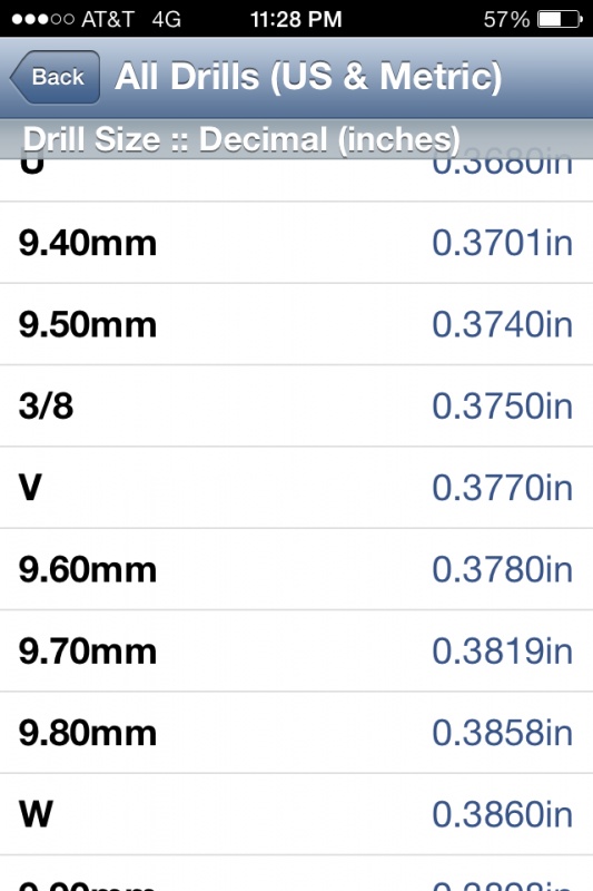

Try this. ...
attachment.php
The v bit is .3770 and the 3/8ths is .3750. If you reamed a couple times it may work. I'm wondering if this is an acrylic and you're going to paint the inside of the blank and tube it may be better to use a 25/64ths as that is .3906 and would give a little more room for the paint and the epoxy. If it's a wood blank I'm not sure which would be the better choice..:confused:.there may be a better answer coming from someone with more experience in sizing bits. Ah slow typing:redface:

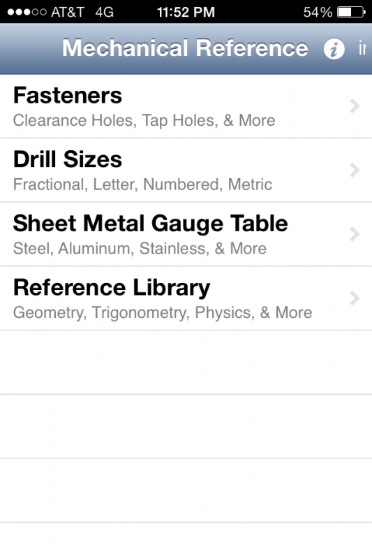

Side Note, Ed...where did you get that list, is that an app that I dont know about, looks useful, and I am always doing the conversions...I also just measure the tube, and select the right bit. I dont ever check to see what the kit calls for necessarily on paper...
yes it is an app called Mech Ref.

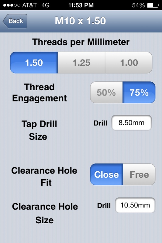

Also does this.
