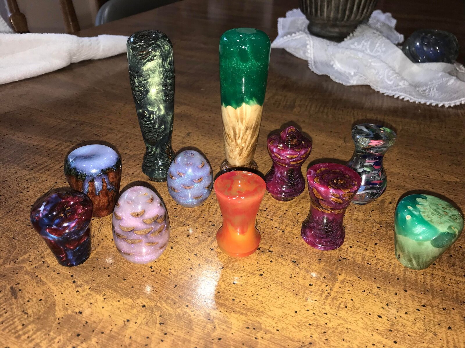

Very interesting, have you tried it on wood too?
Yes. There are some burls in here. Manzanita burl hybrid on left. Big Leaf Maple Burl beer tap in center and dyed Big Leaf Maple Burl on right. The manzanita and beer tap were not stabilized. The dyed maple was. I did finish on these all in one night.

The are super. I have all of the lights - what is another UV cure. I will buy it. Thx.

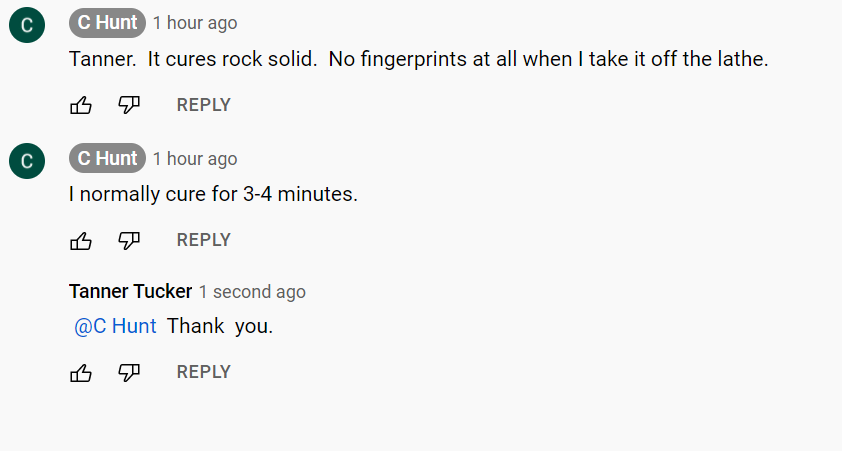

I wrote to the YT guy. This is what he had to say. I am Tanner Tucker (long story....two of my golden retrievers). I will give it a try.1641768046520.png

Ok. Well the stuff should arrive tomorrow or Wednesday. I will let you know what I think.
