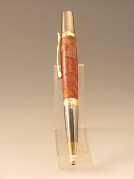

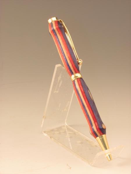

Saturday, I did a presentation to Bayou Wood turners, on hi tech finishes. These two pens where part of the presentation. Finished with UV cured clear, that I borrowed from Lance Dupre. one coat, dries in minuets. you need a special light to cure the finish and they can be costly plus the UV clear is pricey. When I get more info I will post. As of now Lance and I are still exploring the potential use, of this product.
The Gold/ Chrome Elegant Sierra is Rosewood burl, the Slimline is colorwood for a freedom pen turnathon. this weekend.
