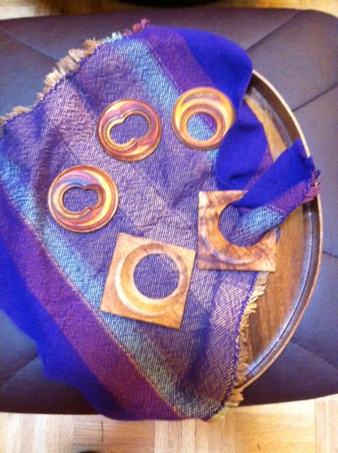

Susan -- one of the aspects of multi axis turning is that your are cutting air during the process and cannot see what you are doing in detail. Practice builds some confidence and can make the opportunity more enjoyable. The "propeller noise" -- that whir of the air moving can be unnerving too.
I have done a bunch on my Jet 1014 and as long as the vibration is not moving the lathe around, I have become comfortable with it.
I make shawl pins and napkin rings for the weaver I live with using these techniques and after a dozen, they get easier.
