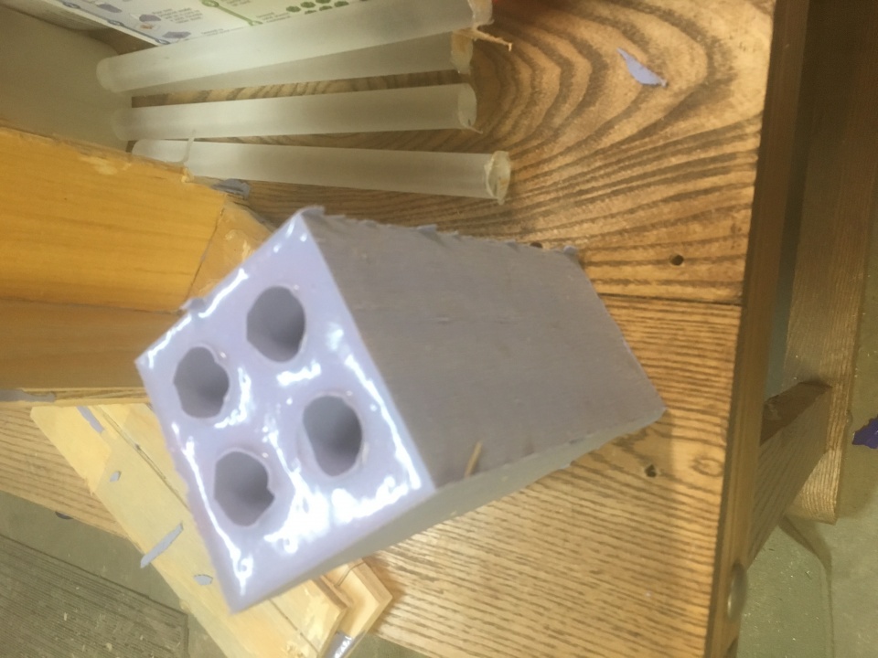

I poured this silicone mold last weekend and used it in my pot without any stabilization. I didn't have a problem with deformation issues ¯\_(ツ)_/¯
I'm talking about Tube-In molds. I talked to "I forget his name" from Royal Palm resin, and he confirmed that soft tube-in molds are not a good idea in pressure pots.
Gary
That is contingent on the pressures you want to cast with and the type of mould. If it is one with built in plugs it will leak past the plugs when you get to moderate pressures. Ones with separate plugs will take more pressure. If you make your own moulds with a hole through the plug it will equalize the pressure and be better at resisting leakage. You need to ask yourself why you need pressures that will distort for tube in casts? Most of the time it is totally unnecessary but the more is better mentality prevails. Any side distortions are insignificant and won't matter when you turn the pen.
Want to know how much pressure given mould will take? Put water in it and test to a given pressure and then remove to see if there is any water in the tubes. Repeat with a few more pounds each time until you get a leak. Back off a 5 pounds and you should be good with resins. Still can't get to the pressures you want? Make the mould from denser silicone.
