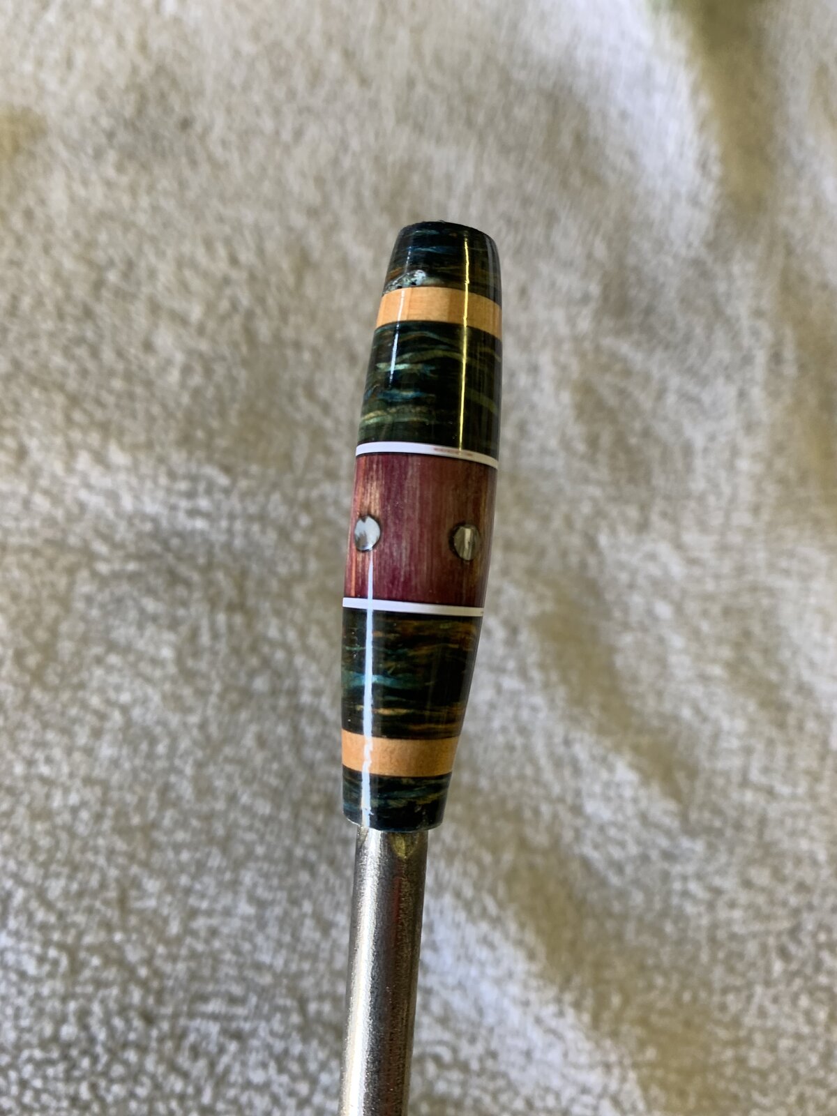

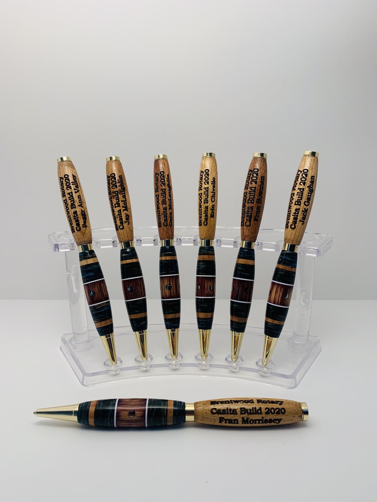

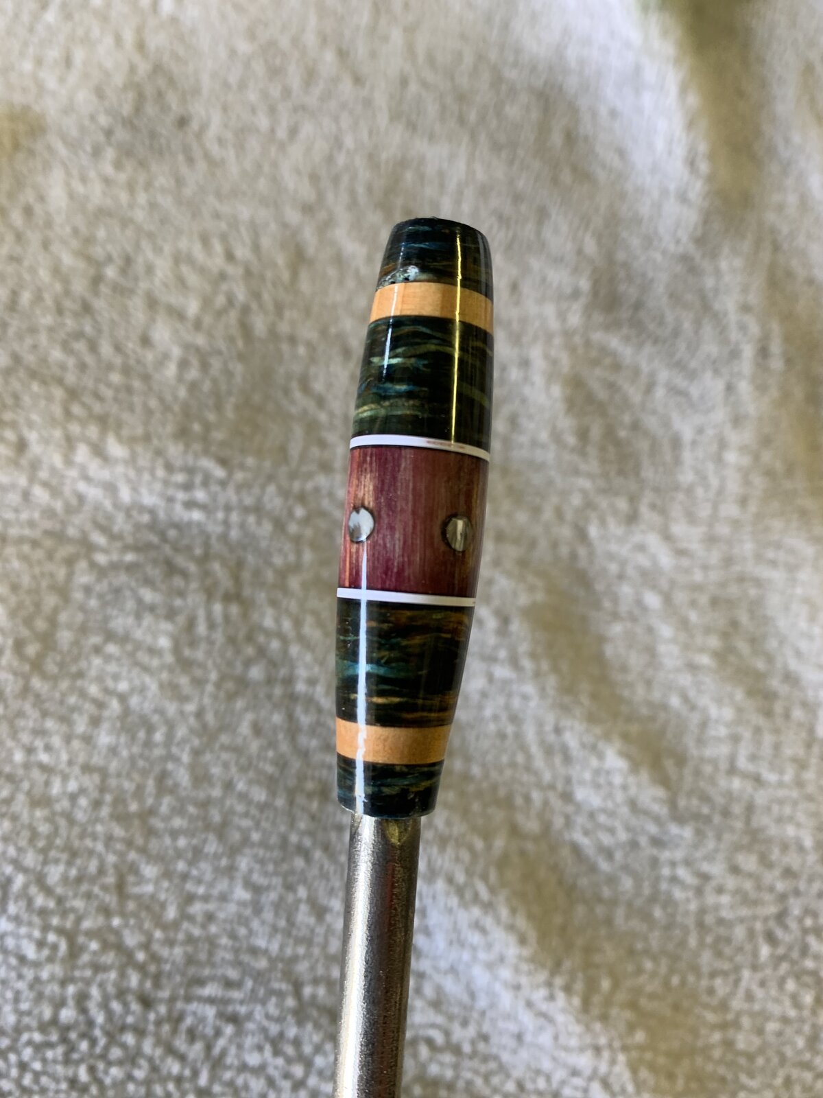

I turned a group of pens recently using OSB I had stabilized and dyed blue.

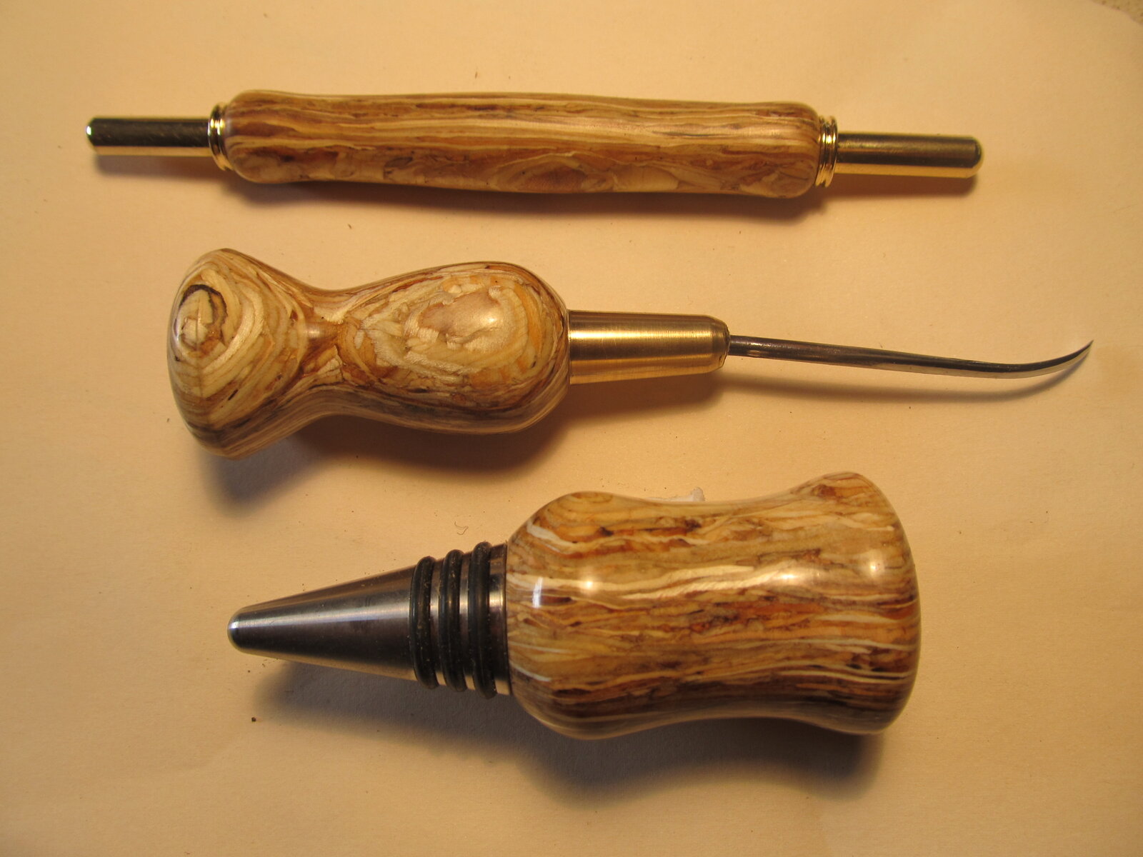

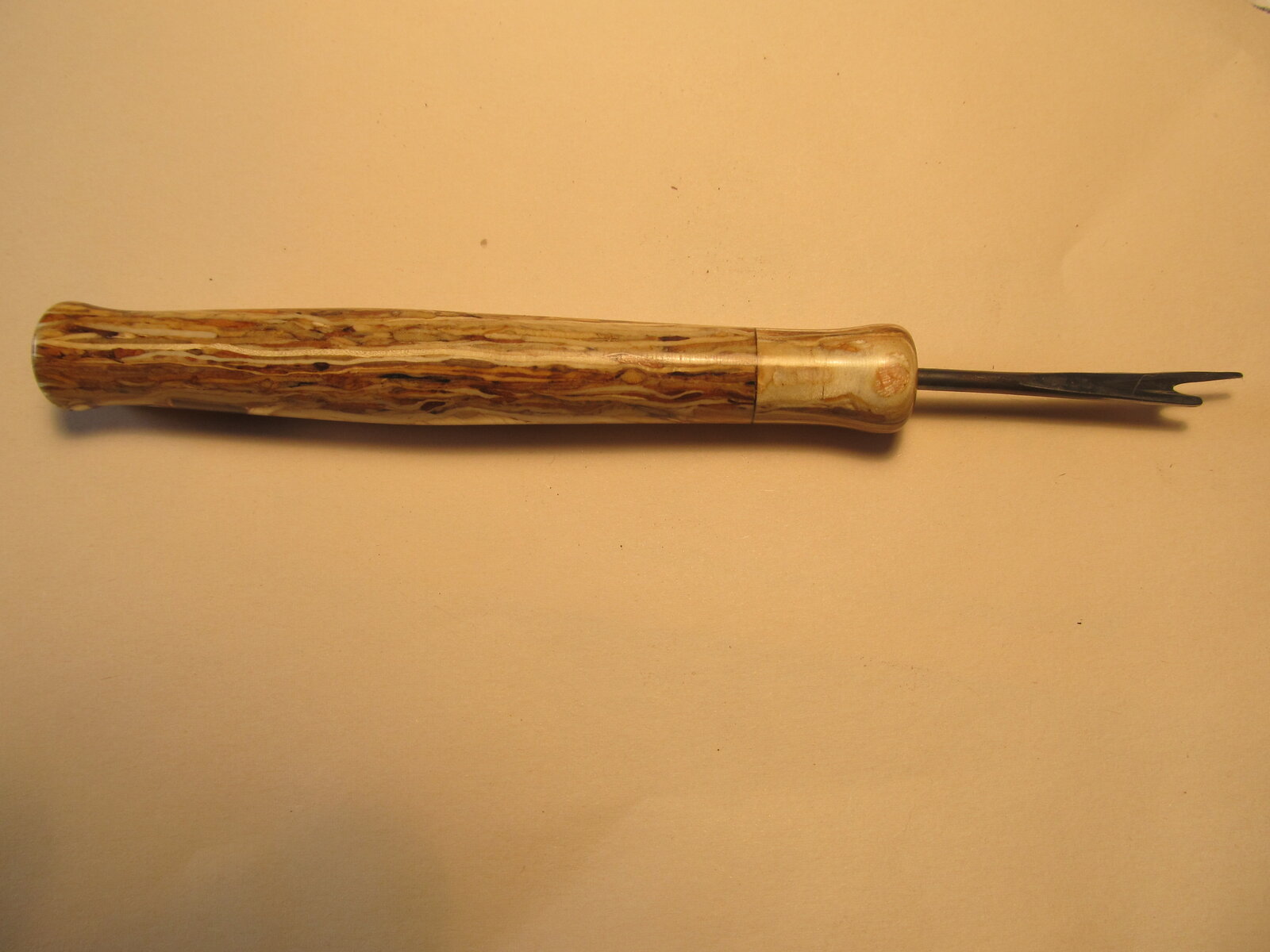

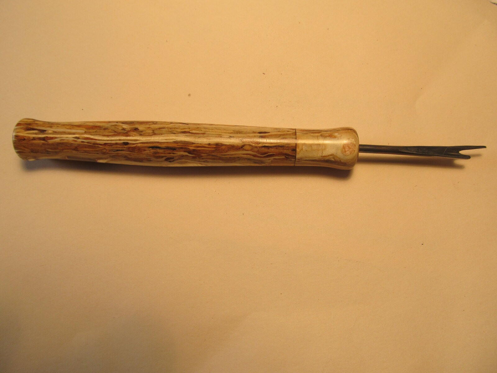

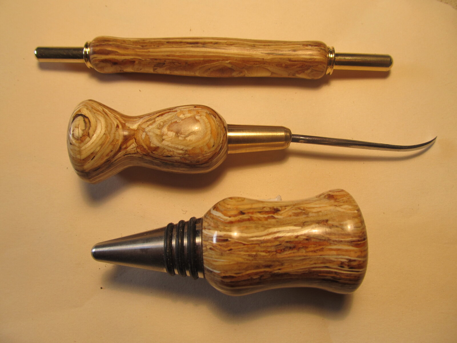

Here are a couple things I made with OSB. The blades on the seam ripper and leather awl are my design. Takes a lot of thin CA and patients but worth the time and effort. Some of the picture is cut off the wood shows up. Don't know how to change the picture

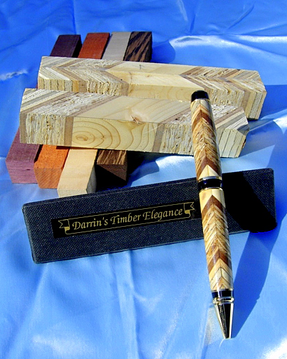

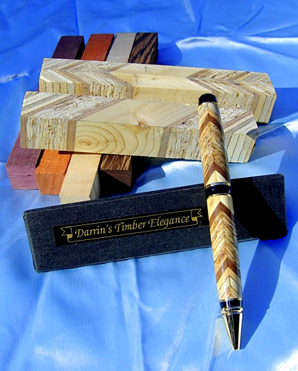

This was one I did for a PITH, many moons ago.
It was a "construction" wood challenge (because 2x4 spruce is not readily available in all countries) 😆
This one is different materials I was using to build my new workshop.
Plywood
Hardboard
OSB
Spruce
It was chippy, and needed scary sharp tools and sandpaper.
Lots of coats of CA

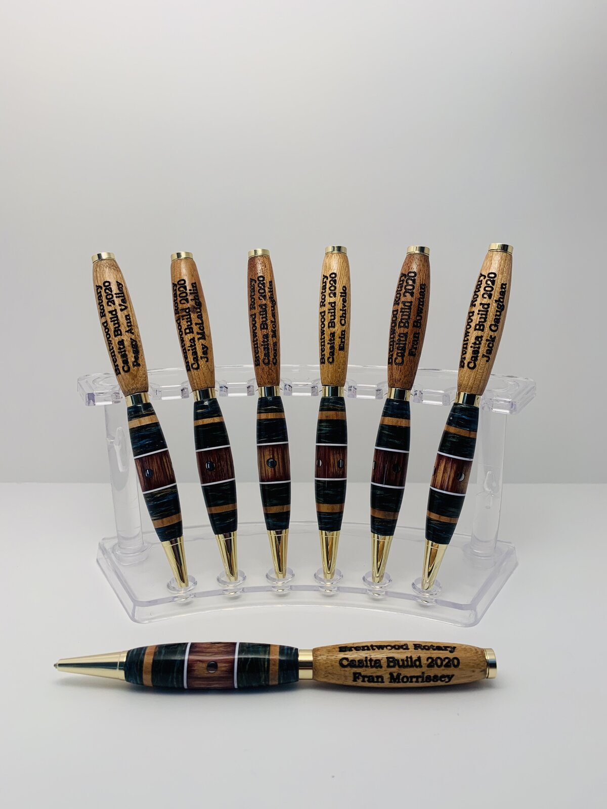

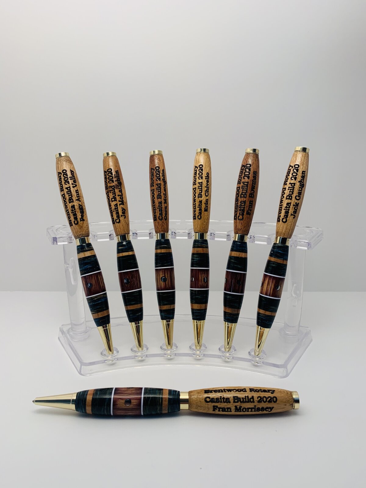

I made some segmented pens for a group of friends using OSB that I stabilized with Cactus Juice. I added blue Alumilite dye to the Cactus Juice which gave it a marbled effect. Here are some photos (the teal parts are the OSB):

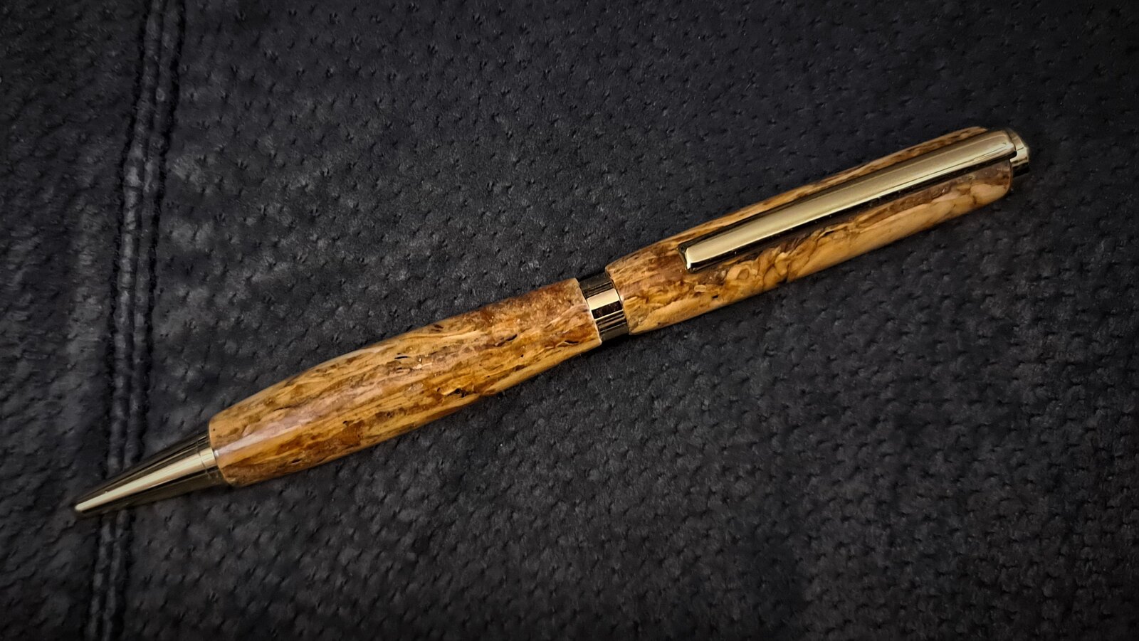

I made this from OSB a few weeks ago. Took a lot of thin CA glue and constantly turning, then regluing a piece that flew off, then turning, then sharpening, etc. :) But it turned out pretty good I think. :)
