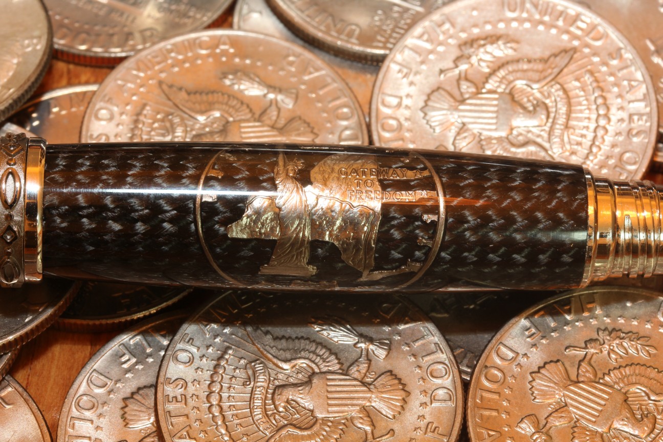

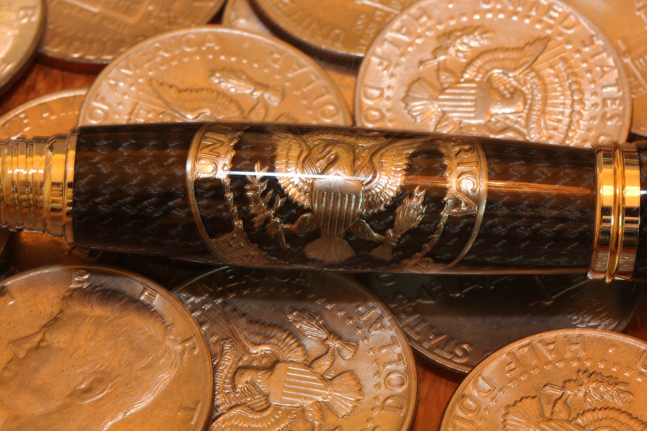

Seamus Rooney sets the standard:

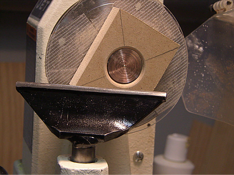

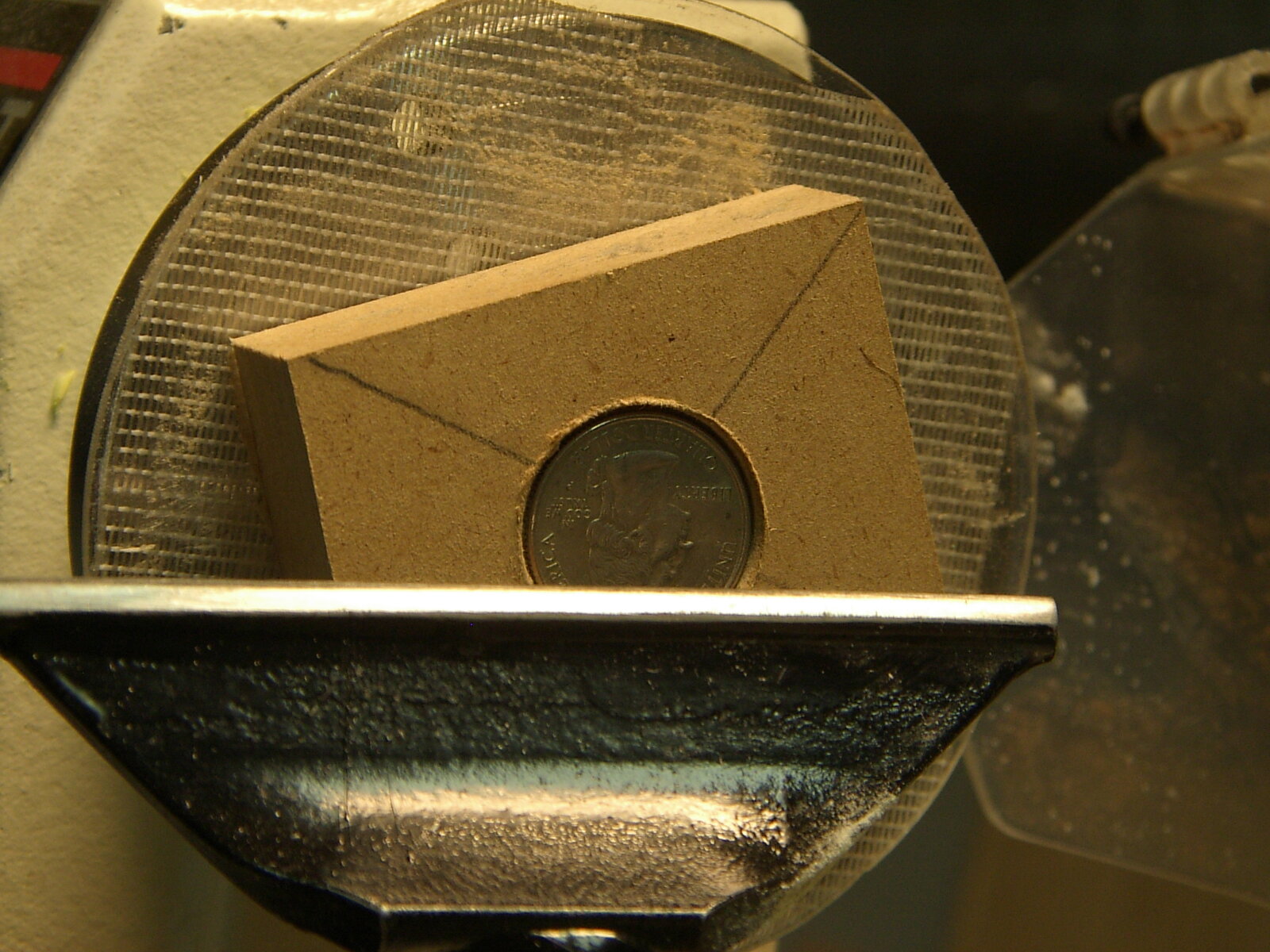

Yes Seamus is the man when using coins in pens. He scrollsaws the design he wants and thins them but he will not tell you how. This is a trade secret of his so do not pressure him. He makes money from the blanks he makes. Now thinning a coin is what you need to do to make it easier to bend something like a watch dial. I have shown my method many times here. and is relatively easy. I use a flat plate with a block of wood attached to it or you could just use a block of wood chucked up with your favorite chuck. Like a 4 jaw chuck. Then with a forstner bit ( proper sized to coin being used) in a drill chuck in the tailstock. Drill a partial hole in block. You can make it just deep enough to give you the thickness needed to bend or go deeper. Then with a spindle gouge or carbide round cutter trim down. Metal will cut easily. It is varied metals in there. Just protect your lathe electronics from metal filings. Included a photo of my jig. By the way I use double sided tape to hold coin in jig.
