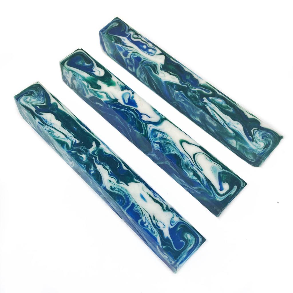

Blend 1 – Blue Lagoon (Highly Recommended)
https://images.openai.com/static-rsc-4/wUMh83fkeuzGjWnj2lq8ZVPQDerEfoFOz-Ft9L_2T5fqI8owQEvAzBdmzAbwvIyZL6fG9fMQlatkSeYpZrz0ZdvO_xW25GJepEbX9JcaSzlzbFUo2HoeatX7g14pKhcoDy-jOwexiXI2v1jT_-WeT7dRFvvhzEBG7wQWoAx08pRaXSMIesZRnMGrbYASqWdW?purpose=fullsize
https://images.openai.com/static-rsc-4/Q4az10V7LlEnWgX1NV5UaQWB5S_nPOaUsmC_uywWHs6hszoBKIFlU-hdW9Z6qyI6_LOzH8Fsp70e_eYd-XCpzoVdwMnoS56XF7tQzhhVlv2X9KznSszUJBlsj4I8RJg9r-h-55gbCbTTmG2OS9HwZiU2EoTMhOkE6LhKwM7qY5Wght8IQhcQMznnj3TCcFwW?purpose=fullsize
https://images.openai.com/static-rsc-4/3rLNTe604DD-JJ_AVGvE_OAerrAGQS5pLhGmmtYciD46rbylX_a4Y5kokP9NGJ1ymUEasPOpPiU9OmIRgH7EwPoRtdc3nk3X5Z8avPdDkzIKlO8Y_vtlhy8Fqlpw4BVsJKTnuBkd6zaKL0ASbn2H4_K2YedwowxcNDzRblay9FYTJmom5vatuQo4N8BUDNH1?purpose=fullsize
6

Produces:
  • Deep blue pockets
  • Bright turquoise ribbons
  • White "sea foam" highlights
  • Excellent depth after polishing

Pour Technique
  1. Pour sapphire into one corner of the mold.
  2. Pour teal into the opposite corner.
  3. Drizzle pearl white in a thin ribbon down the center.
  4. Use a bamboo skewer to make only 2–3 gentle figure-eight passes.
  5. Pressure-cast at 40–60 psi until fully cured for a bubble-free blank.

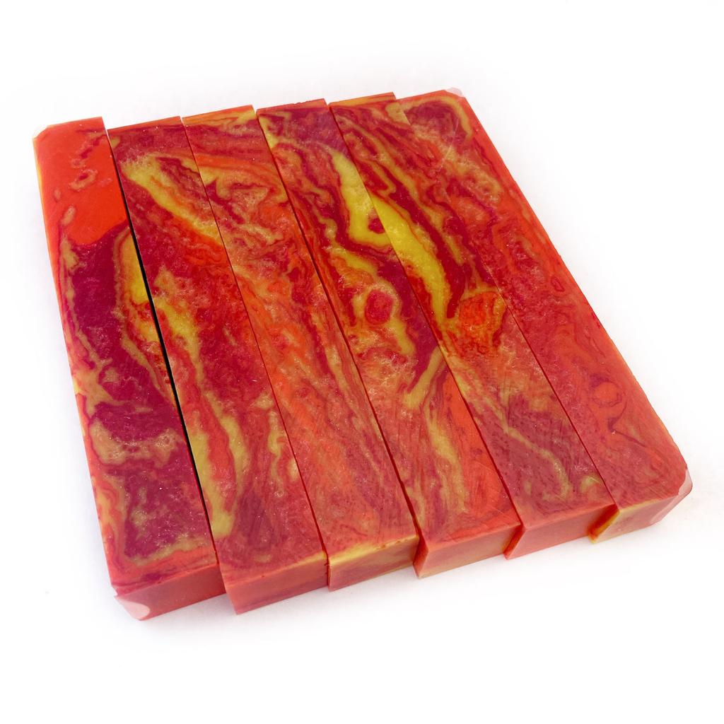

Blend 3 – Fire Opal
https://images.openai.com/static-rsc-4/aX3ShizLBwiXMVMZrBKS2xAJsZMEgS9wvHMLZy6xFHm-BIgUVB0zMea6T7N6Bf0-HwBh4ywzwQJBw9ukXh9j2Ci1Jy4OI886wILkqTnYPDEe5kxMfRjLoJPjt4QFbmbbwOF1Vg9KlTBu5Ph2suulVFoKkOtFs_-Gehy8qrLp_8Xl9IiDcfyp7guzZWstxDf3?purpose=fullsize
https://images.openai.com/static-rsc-4/kDQNTYRxGP68s9u38NNhLtfvcW6GCRnaBuYIfeTmNm5z8sqj8PUmjjBI5CQ1siwARPwatEnl7gEO7bOt4sdsPicg2sSS-kxtv0n_ihQBV8-yLg-D1jNyM1MAzVPSCl-FsdN1j-cZbqwKc9Xpi130cVqmspgTnk_YO_viQ4aU2EmPCeyrDTf4rngLyfMFiJDg?purpose=fullsize
https://images.openai.com/static-rsc-4/3icTjnYJjcFvjpm1l6VPERXQRDTzQxO3hwKEjgpwDlf2vPO44VUVZDUiCJjgQB7VBBcxDcxx1Z58WnQCVagQcbJPMUHiYrHrf_4RiEOUjIDGiouXlZfHDScYq5dkdpOdy-0lGxoF0gYR-IumUqlW68Fdfy1pHOu5KtAdxLJvwXCsS3DPvGMP4dZkSClGbagZ?purpose=fullsize
  • 40% Ruby Red
  • 35% Transparent Orange
  • 25% Gold Pearl
Creates warm flame-like swirls that become especially striking on polished pens.

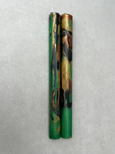

Are the blanks pictured what you made from the prompt or are these reference photos?
Edit to add: Ah I see now that the pictures were part of what ChatGPT spit out.
