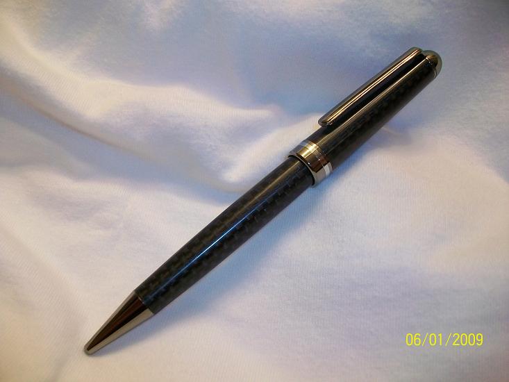

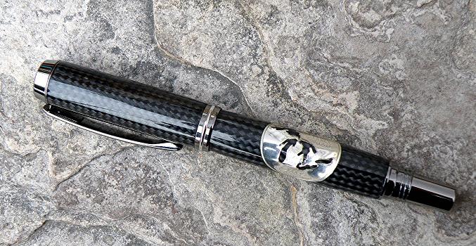

I personally think PSI uses a different type of resin than polyresin. the reason i say that i because when i first started turning I bought one thinking it would look cool, but i noticed the same problems, you gotta cut the blanks to size, then trim them, and if you want it done right you should square the ends for a perfect fit to your pen components. It wasnt shortly thereafter that I learned about (CaptG)'s carbon fiber blanks that he sells through exoticblanks! Not only are they specific to the kits that you are making but he also barrel trims the ends so all you have to do is mount them on your pen mandrel and start turning! Its just as easy as that, and you have a super sweet looking carbon fiber that PSI's CF just cant touch.
this picture is PSI CF, yuck! (on the right)
This is CaptG's Carbon fiber! AWARD WINNING!!! (on the left)
You choose, this is just my opinion

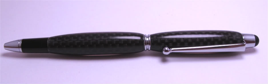

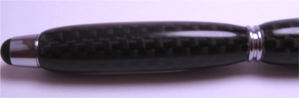

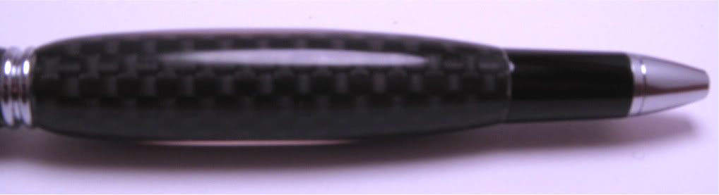

I just cut it close to length on the bandsaw, then took it down a little ways with my pen mill...didn't have any major issues except the acrylic seemed to be really hard for the mill to cut away.
It's completely the opposite of how I felt once I started turning the thing...the acrylic felt super soft, softer than the acrylics I usually get from PSI. I had to switch to my tiny gouge to get any work done without sinking through the material too far and getting blow out areas.
It polished up really nice too...my pics aren't the best, but here's what I came up with. The kit is the new iPad stylus kit (Chrome) from PSI.
Edit: I touched up the pictures and cropped them after I uploaded them to Photobucket but before I posted them here...I guess their server takes a while to show the updated versions I made...they should resize and be clearer/brighter as soon as Photobucket's servers catch up :)
