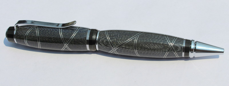

As others have said be sure to rough up both sides of flashing.

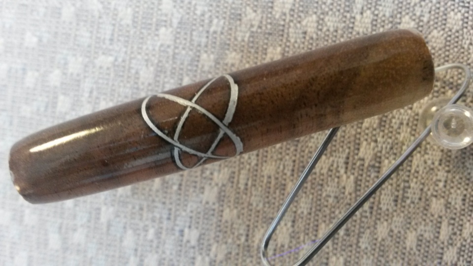

I thought this discussion was interesting and thought I would give this a try. I just happened to have a piece of aluminum flashing nearby and plenty of scrap wood on the floor so... I gave it a shot.
If you look at my picture, it is pretty clear I ran into some issues. I tried to follow the video posted earlier in this thread. I am very new to all this so I am sure I made rookie mistakes. How did I end up with wide spots in the aluminum? Also, as I was turning it (I used a carbide tip tool) the aluminum was bright and shiny like chrome, then after sanding it turned very dull, it almost doesn't even look metallic anymore. It seems like I missed a step with polishing it along the way. I finished it with a few coats of ca glue. I have plenty of scrap to try again and get it right but I thought I would ask to save some time.

It looks like your tool was dull. Instead of shaving away the aluminum it was sort of rolling it over giving you that look.
Try and use a skew to ever so slightly shave away just a little bit and it should take off those edges.
If that doesn't work for you just try sanding more with a lower grit before going onto the final sanding process.
