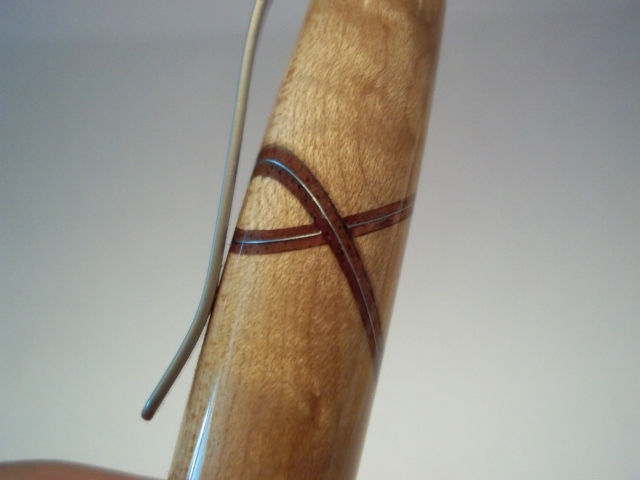

turn carefully at the aluminum. it turns down slower than the wood around it so if your not careful the aluminum can be raised. which still might look cool if thats what your after. as for the aluminum. pop (soda) cans work good. they are thin and soft. just sand off the paint so you don't see the color and the glue gets a better grip.
