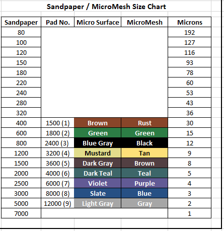

This is a grit chart that I made a few years ago based on the CAMI (Coated Abrasive Manufacturers Institute) scale and various published Micro-Mesh and Micro Surface charts for regular Micro Surface pads for Plastics like Urethanes, Wood and Wood Composites. Some of the missing data has been extrapolated.

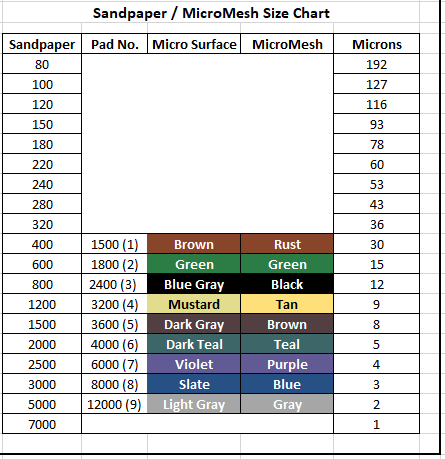

So the "grit" numbers on micro mesh are not the same equivalent as sandpaper?
No they are not. I get mine, called Micro Polish Pads, from Turners Warehouse. I cut the 4" x 3" sheets so I wind up with four complete sets of 1.5" x 2" pads. The adjusted cost winds up being $3 per set - not too bad compared with the 2" x 2" pads from other sources that cost $12 to $22 per set according to Google AI. - Dave
