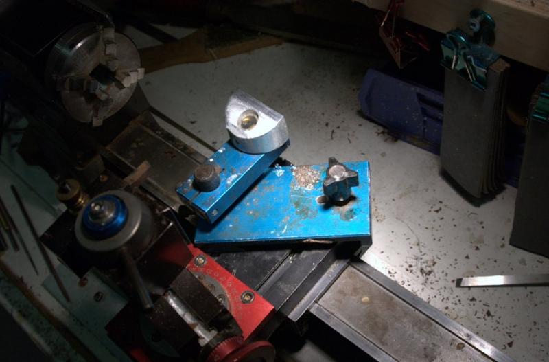

I have a sherline 4400 I use it to turn my pen blanks as well. I have a couple of different set ups to do the hand work. I use the standard hss tools to round the blanks and then go to a tool rest to do the final shaping. In my case I adapted a taig tool for turning wood to my uses. made up a 1 1/5 wide tool rest so in can get right up to the Blank its adjustable for height and the head turns to match the area i need to turn

I made a tool rest for my 9x20
http://www.coleman-family.org/gallery2/v/temp/MetalLatheToolPost.jpg.html
