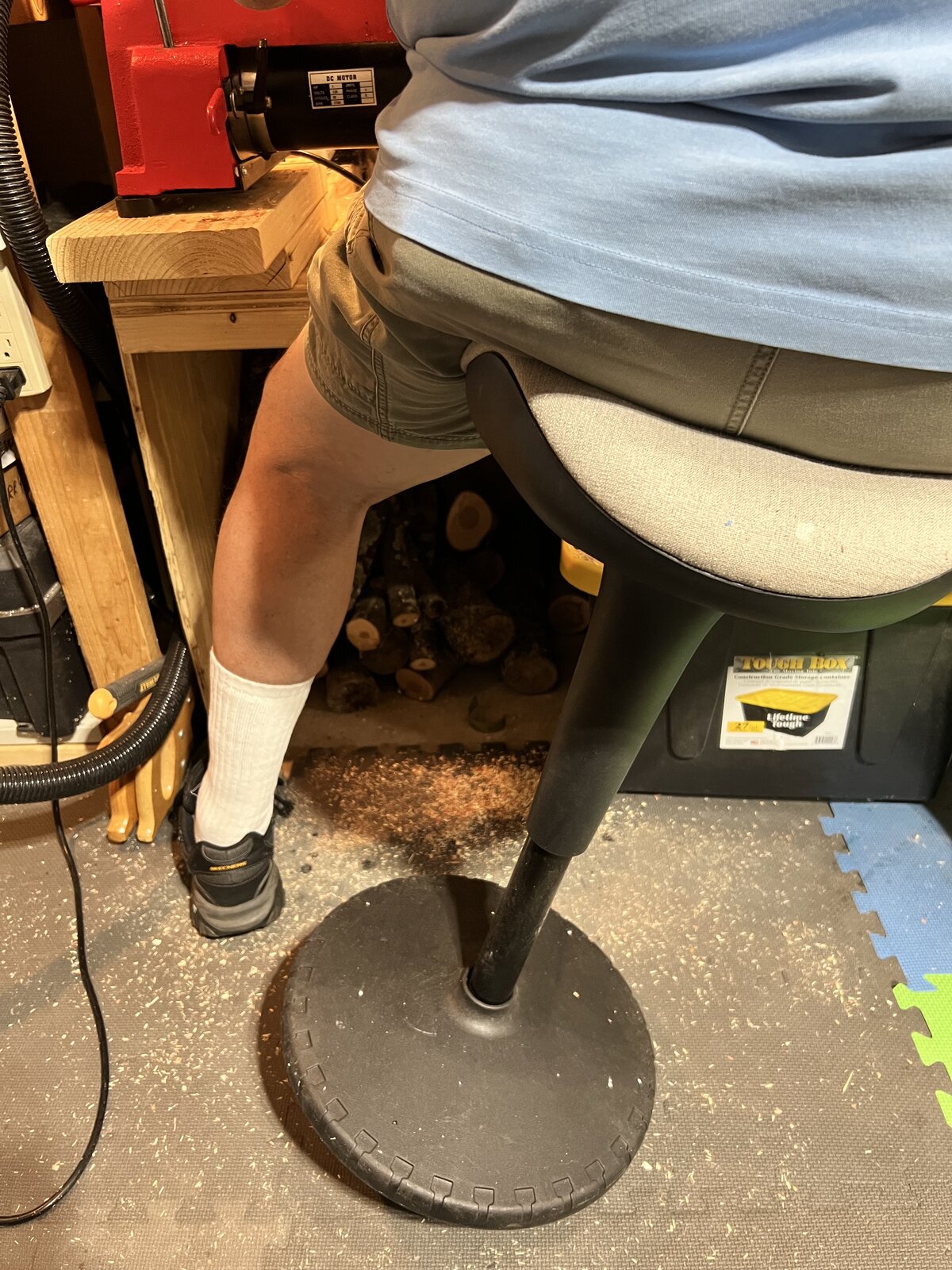

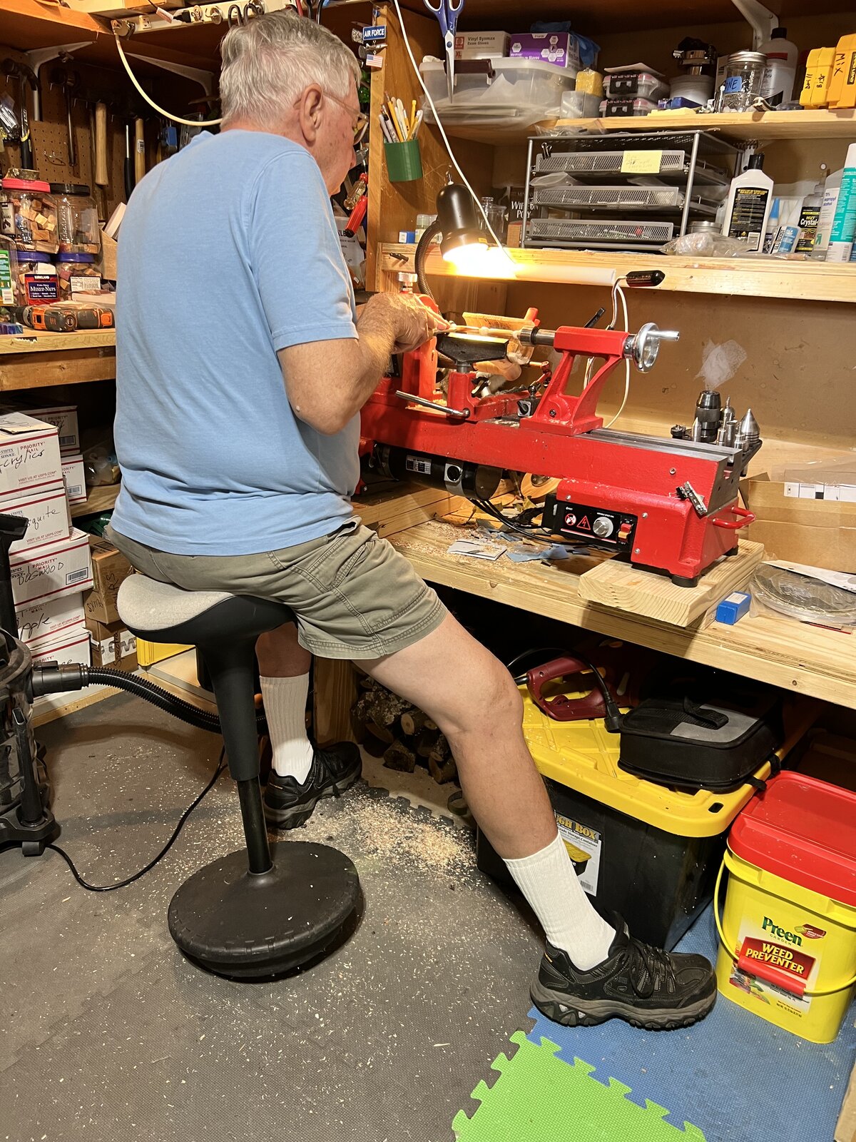

Not the answer to every situation but some number of years ago one of my career choices was selling ergonomic furniture and equipment. One item that was very helpful to the position of having to stand for long periods of time was the sit-stand stool. It allows for a near standing posture at equipment without full strain on the legs/knees/back. It does take some practice at balance (so don't try if you have a balance issue) - I can easily lean forward, left and right with little effort. I purchased this item and use it on a regular basis - https://www.amazon.com/Learniture-A...4&sprefix=sitting+stools,aps,996&sr=8-60&th=1. Again, its not the answer for everyone but it has been very helpful to me. Hope this helps.
