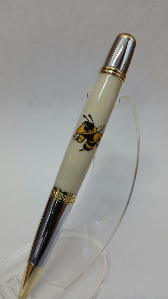

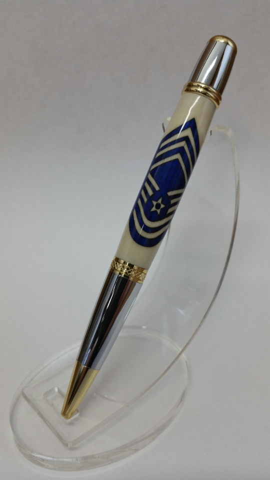

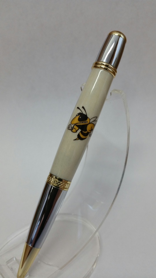

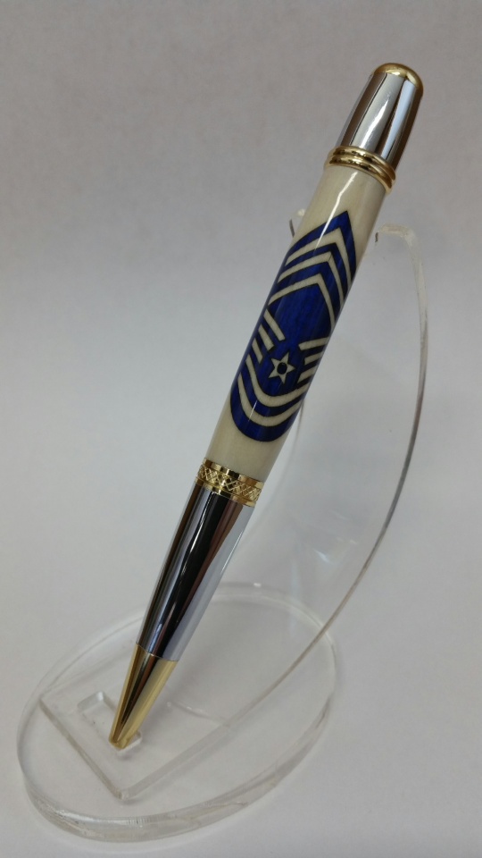

One of our outgoing chiefs is an Air Force BEE.
Some of the leadership asked me to make a pen for him.
I used the laser inlay CMSGT blank from W&W and then printed a waterslide decal with their mascot.
Used my usual 8 coats of super thin followed by 8 coats of medium CA over the decal.
I disassembled the sierra top end to remove the clip prior to assembly. This allowed me to use a larger decal on the back side.
