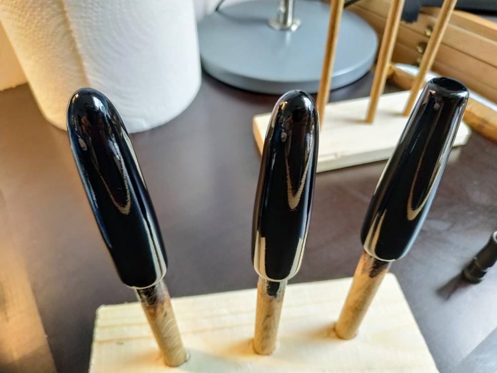

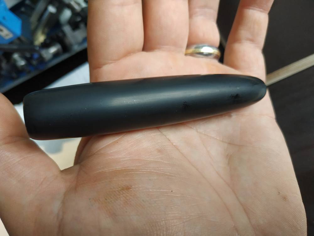

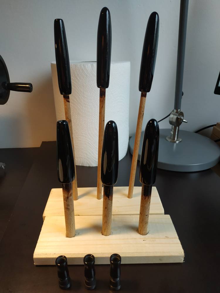

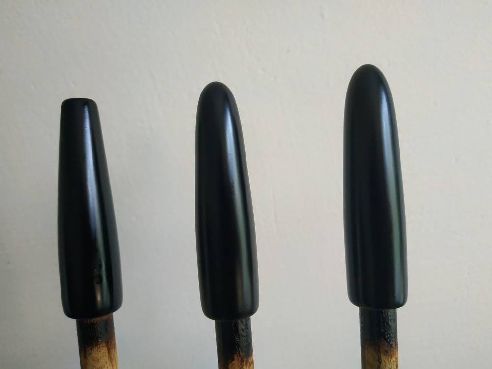

Hi all,
Today I applied the final layer of raw Urushi.
It will cure the next 24 hours and next phase is starting, colour urushi.
Regards,
Teo
Sent from my Redmi Note 5 using Tapatalk

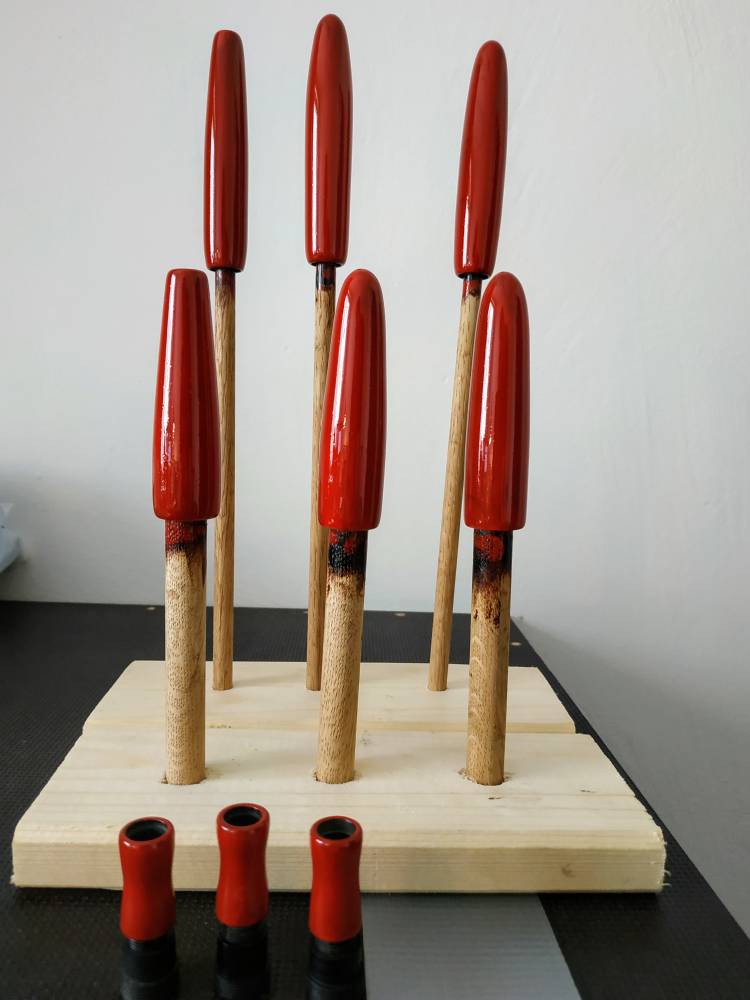

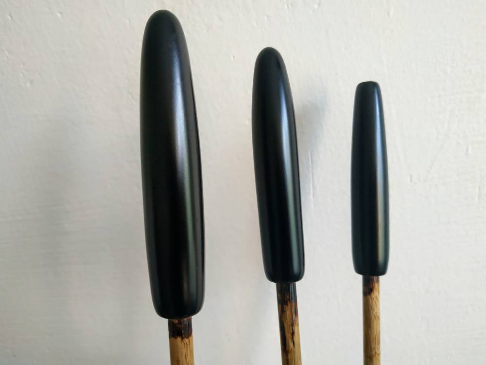

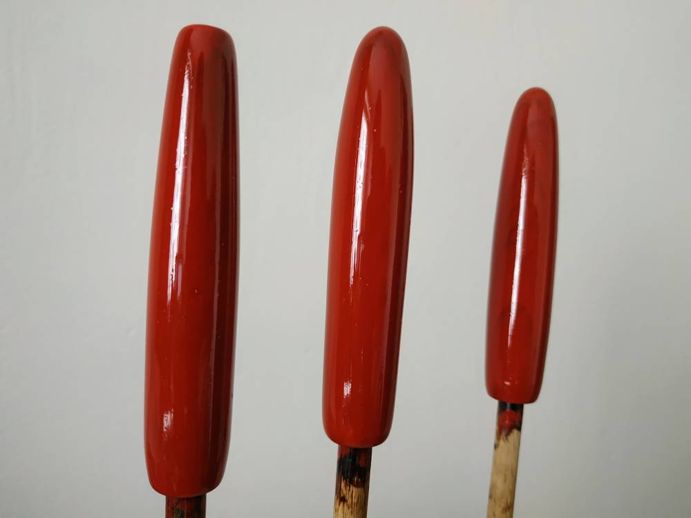

Hi,
So .... Before application of colours, I need a solid base of raw urushi, after this I can start to apply coloured urushi. I'm buying directly prepared, I'm focused for now on correct application of Urushi and curing, I'll do urushi preparation later...
Applying urushi... Well, you need to experiment yourself to find your type of brush, movement, thickness, curing. It's a long journey.
You need to balance your layer thickness, and curing environment, a thick layer will create rinkles and urushi will peal, to much temperature and humidity will increase the curing and again creates rinkles, to low temp and humidity, the curing process will be longer or no curing at all. Ideal temp is 25 and humidity 75%.

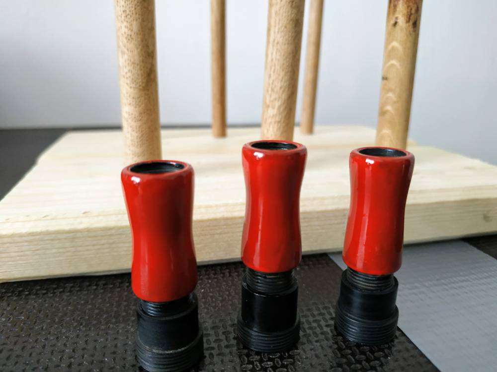

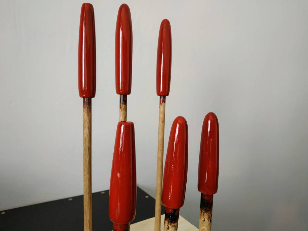

Teo, looking good, thanks for sharing this process with us. Maybe I missed it, but what material did you start with? Ebonite? Sanded? Polished?
Can't wait to see the next update.
Yes, I'm starting with Ebonite, sanded and washed with water and soap.
After each layer of Urushi is cured I'm sanding it with 3200 or 4500 micromesh and wipe with alcohol before applying a new layer.
I will add 3 layer of red Urushi.
