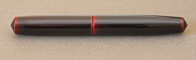

Has anybody tried the Urushi Lacquer finish?
this is a fabulous looking finsih that is apparently difficult to apply. Can't find source or process.
Any leads would be helpful.

Tread carefully if you have any sanity left and want to keep it. Yes, I use a urushi finish a couple of times a year. The cost to get into it and the hoops you have to jump through are huge. It took me about 6 months to track down the components and someone who would sell to an outsider. The initial investment was about $500 for the basics. To date I have had more failures than successes and the successes have not brought fame, glory or money. There's nothing quite like an urushi finish but the investment in time, money and materials is very high.

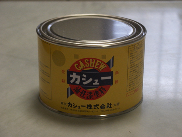

is this the Cashew youwere speaking of? The Urethane kit by Washin for 60 bucks does me no good unless I send you $ and you stop by the hardware store...I can't wrap my mind around what I would need a few grand for to apply this finish. Is there any reading about the application process you could help me find?

Yes, that is the cashew base.
Remember there are a lot of smoke and mirrors with any traditional art and getting the highest deemed quality liquid urushi, powdered deer antler, the proper kind of sumi and the mouse hair brushes and so on is going to cost you...and those things aren't in any hardware store. Even my carpenter buddies just look at me and chuckle when I mention exploring "traditional" urushi..lol. Also, budget for a humidor unless you are willing to wait until....umm...forever.. for urishi to cure. Curing requires humidity. And then there's customs and HAZMAT policies..
