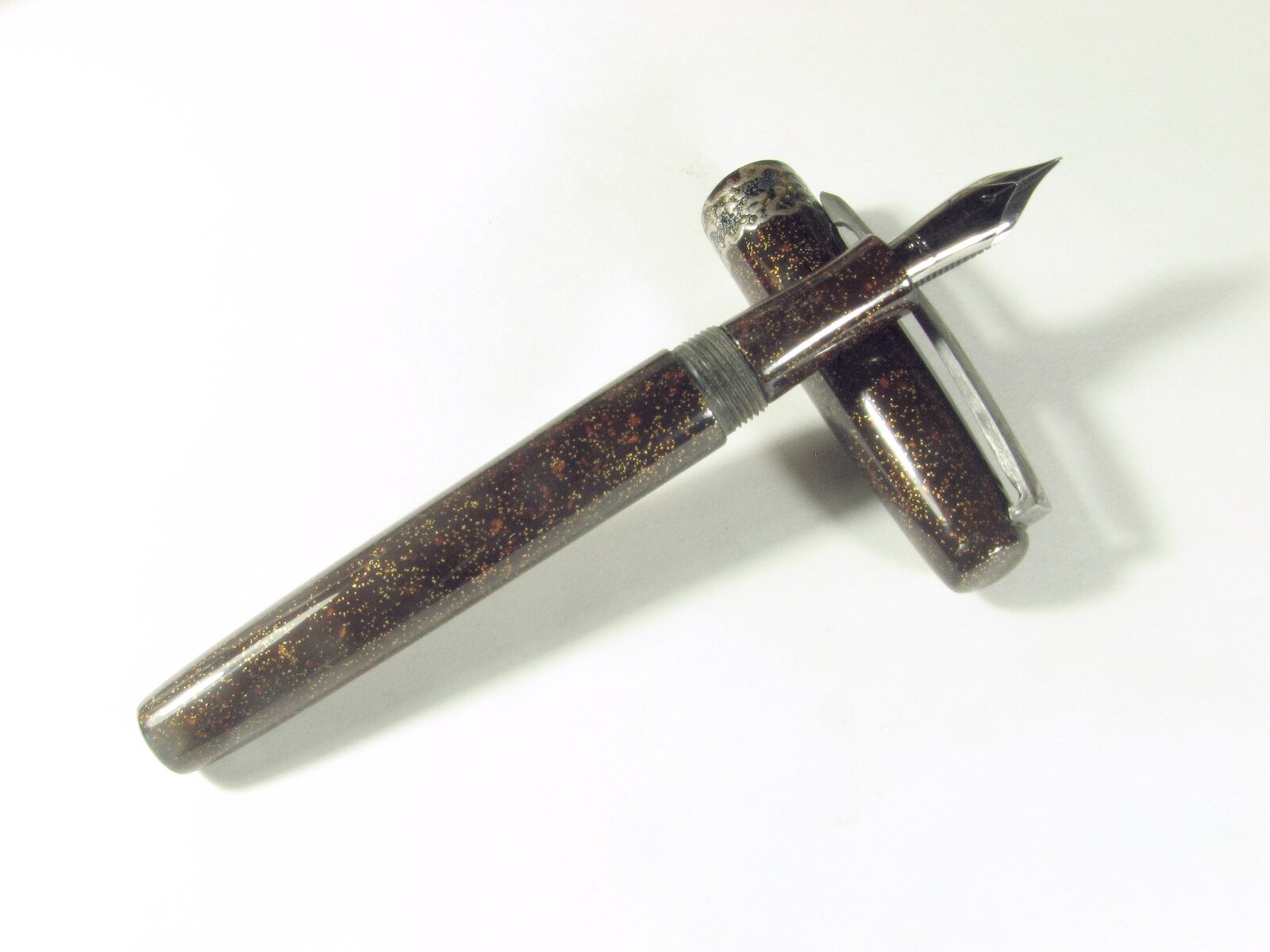

Hi all,
Made this pen on a ebonite base, with multiple layers of urushi, big gold flakes, more layers, tiny nashiji gold flakes before polishing, that gives a little depth. A little decoration at center band place with dark blue urushi and silver, and a Damascus clip. Like an evocation of a sail on the sea under a starry night:

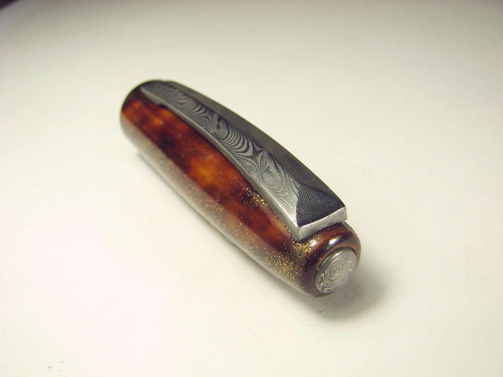

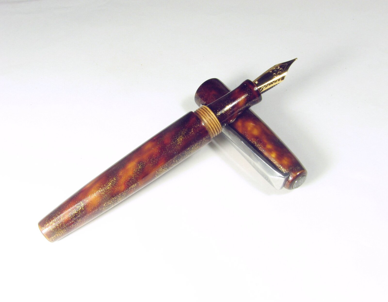

A second pen on a wood base, sort of an tortoise shell imitation, also with gold powder and Damascus clip. Not easy to catch all the gold on the picture... :

This is amazing! Did you fabricate the clip yourself?
Yes Sir!
Incredible.

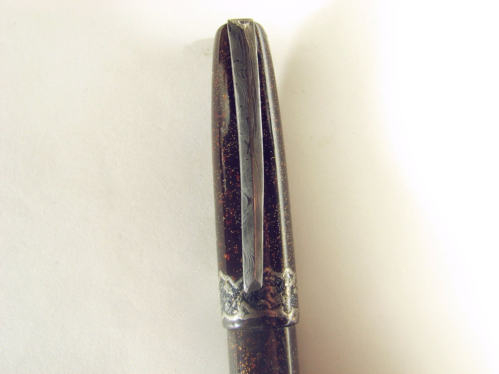

I'm curious how you made the Damascus clips.
That is not so difficult: I have a 3mm Damascus plate, I cut rectangular blanks, bend them with a torch, a hammer and a vise, shape them on the grinder and with files, sand and polish them, a little swim in percloride and that's it.

Stunning work. I haven't seen too many Urushi finished pens. They often have a kind of depth (thanks to the layering) that you just don't see much. I imagine these are long haul projects with Urushi? About how long does it take to finish a pen?
Truly love the damascus clip and cabachons. WONDERFUL! Are you making the clips yourself?

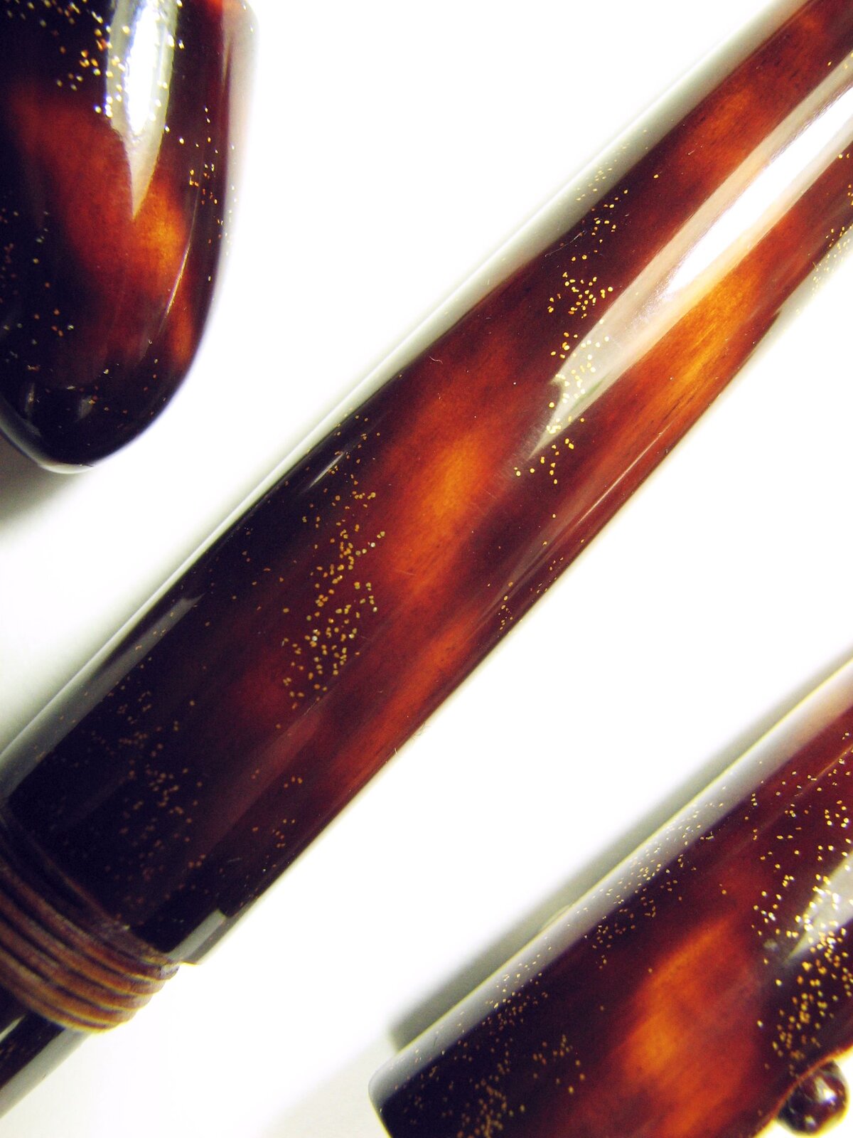

Seeing the real object and seeing a picture are two different things with urushi, especially when metallic powders are involved: you need to move the pen in the light to really appreciate it and the transparency:
About making of, between 15 days and six month are needed for any urushi pen after turning. I made these pens in maybe one month. Mostly curing time, happily.

Bien sûr Fred !
The clip is bent and the little tab is heavily notched. The cap inside has a flat end, and I drill a little hole perpendicularly, right at the end. I shape it to fit the clip with no gap (the longest work), I prepare a little wooden disk that fits into the cap, and pour plenty of two-parts epoxy into the cap through both holes. I made a nylon stick I introduce into the cap with the disk on top, clamp it and wipe the glue in excess.
I would have preferred to screw it, but could not find a good way to do it precisely. But epoxy is strong, and I never had any problems.

Let's say I'm encouraging my French je ne sais quoi to do some exploring 🙃 One of the unresolved things is to attach a clip after the pen is done/finished without destroying the cap or damaging the finish 😅
Pierre---
Jun 10, 2012
415
France
To screw a finial sandwiching a ringed clip is another effective way, with no damage to the finish.
