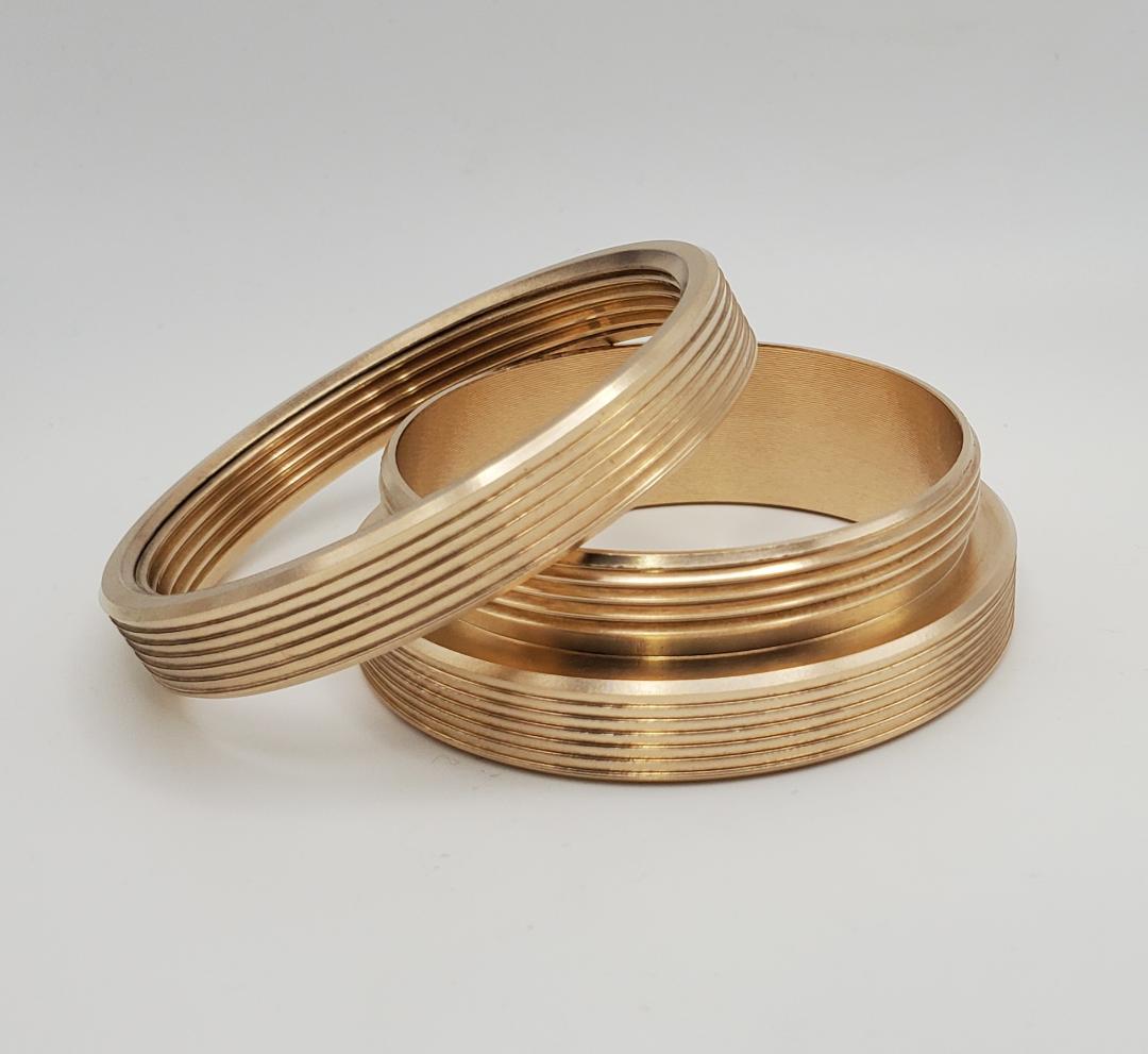

Ruth Niles posts that she has brass rings for urns....
I can't find his site right now, but I also bought a couple of brass/bronze rings from a fellow on the web... his are plumbing fittings that he reshapes to use in urns... I haven't used them yet, but have them out to try next time I'm in an urn turning mood.
I think his name is John Keeton or keetom... he's on Sawmill creek I think.
