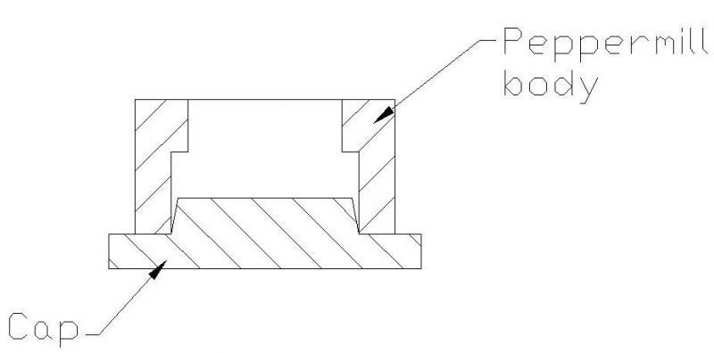

I don't think you have to worry about making it so the grinder is on top. I think all you need to do is turn a cover that will insert into the output area, then it could be set down like normal. You wouldn't have to worry about the nob on the top.
Dvoigt
Dec 5, 2008
274
Fraser, MI
I have heard the "cover" comment a few times. So basically you would make a plug... like this sketch?
