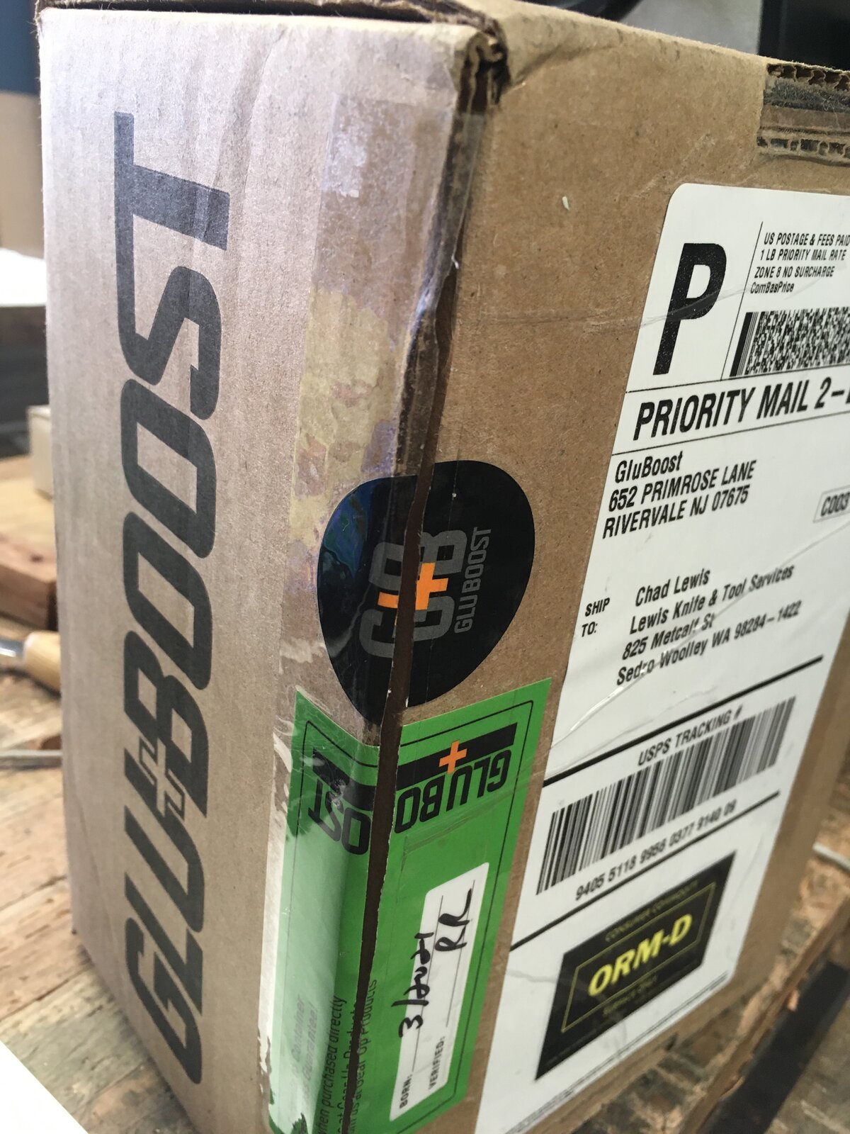

Hmmmm, wonder what's in the box? Hoping to get the same results as using Titebond CA, but quicker and easier.

I'm on my second batch of Gluboost - I love it! Check out Mark Dreyer's videos on YouTube. Excellent!!
I have looked at his videos and they were part of why I'm gonna try GB. My results with Titebond have been good, but I think GB will be easier and quicker process. Also, the Titebond accelerator makes it go hazy immediately, so I haven't been able to use it to speed up finishing. I also had a lot of weirdness when I bought a second bottle of TB thin, which made me think it might be a bad bottle. We'll see!
