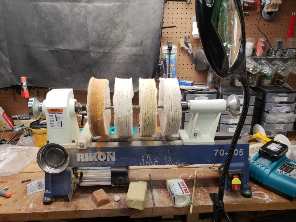

This may help you decide. I wanted 4 wheels.
