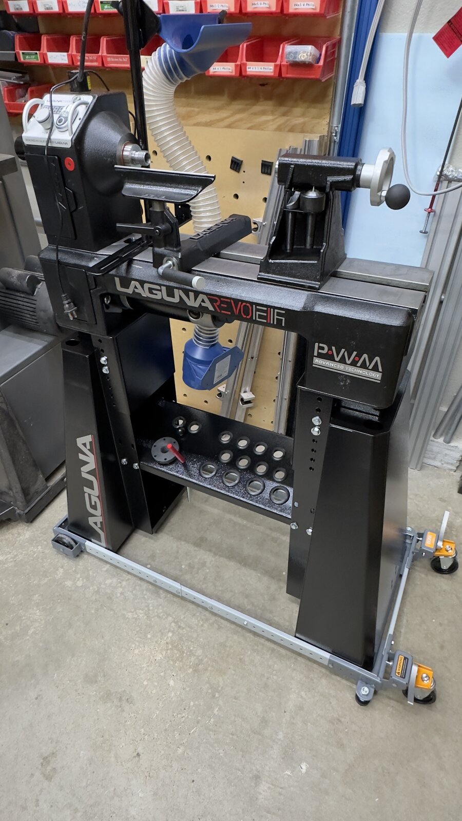

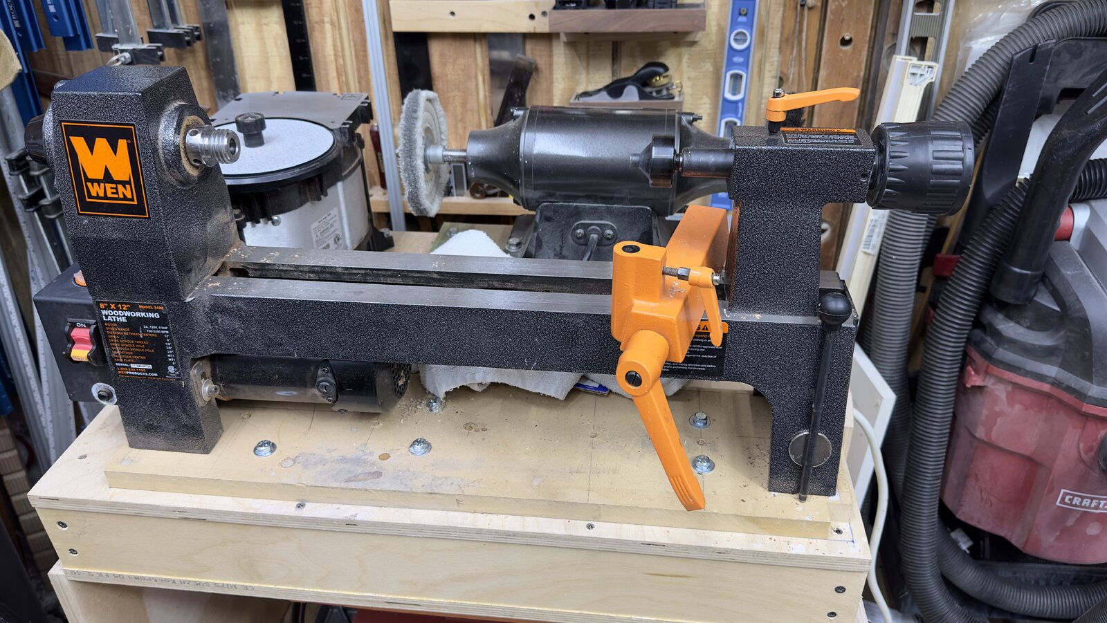

Started turning right before Christmas and I am really enjoying it. Started out with an inexpensive WEN lathe and quickly discovered its defects and limitations. Just brought home the Laguna 12/16 with the stand and the 10" bed extension for larger bowl capabilities. Along with this upgrade, I am looking to update my pen mandrel system. I purchased an inexpensive mandrel set with the mandrel saver from PSI. It is a #1 MT. I can use a MT adapter but plan on using the WEN for blank squaring and finishing so I would like to minimize tooling setups and changes.
After some initial research, I am leaning towards the Axminister mandrel. I briefly considered the Woodpecker system but the cost just is too much. Are there any other pen mandrels similar in quality to the Axminister I am missing?
Oh - not going to be TBC at this point. Maybe later but for now staying with a mandrel setup.
Thanks.

Wow, that's quite an upgrade! I started with that Wen. It's not a bad little lathe, but the slop in the tailstock is insufferable. I'm leaning towards that Laguna next time around, but the old Jet 1014 is getting me by. Sorry that I can't make mandrel recommendations as I've gone TBC, but had to comment on your upgrade.
I have the Axminster compression mandrel which I have been using for a number of years with zero problems.
Would highly recommend it, Bob.

The tailstock on mine is absolute JUNK! The slop is horrible as you say and the dang thing keeps locking up on me. I can't retract or advance the quill now. It's just horrible.

Warranty is long gone on mine. Like I said, I am going to relegate the WEN to squaring my blanks.

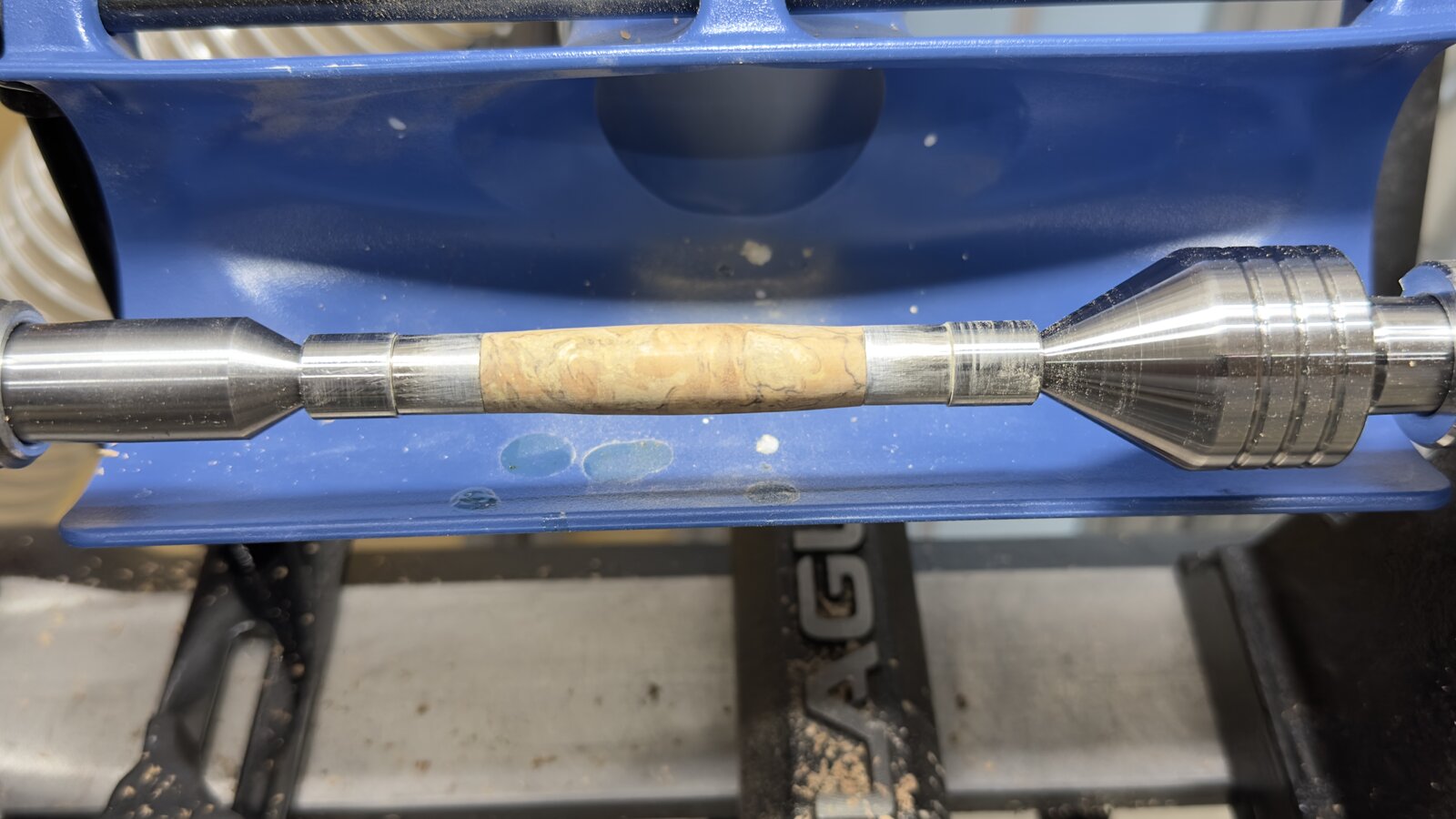

Quick update:
I know I said that I was NOT going to be TBC at this point, but I did venture into that space a bit albeit the term "turning between centers" itself is not as straight forward as I had originally thought. I guess "true" TBC involves having the blank turned without the use of any bushings/mandrels involved - only a drive center and live center - typically 60 degrees - coming into contact with the tube/blank.
I did pick up those centers but also opted to use the bushings from TBCBushings.com. Turned my first blank last evening. I have to say there was a much more solid and steady feel to the turning experience. I still need that guidance at this point from having the bushings there for making sure I have the right diameter. Thanks TBC Bushings.
Just be aware that, no matter their starting quality, the bushings become unreliable if you touch them with your tools or with sandpaper. They can also become unreliable if you get finish on them.
You can certainly use them as you noted in your post, and many do so with great success. But if you want them to remain useful, you must treat them with great care and/or plan on replacing them regularly.
Thanks, Vince. Definitely understood.
I have gone through a few bushings, mostly from becoming loose on the mandrel.
I do NOT finish with the metal bushings. I use HDPE cone shaped bushings for that.
Late to the thread but I wanted to say congrats on the new lathe.
I was in a Woodcraft this past weekend and they had that lathe and the next one up from it on display. They appeared to be very nice.
Enjoy!
