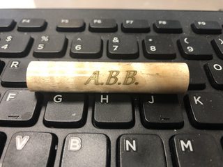

Just another progress report and rambling…(not that anybody cares)
Seems that for me so far I’ve had the best luck with the metallic powder and CA. I use one coat of thin CA on the bare sanded blank before engraving. Then medium CA (the thin runs too easily) with the fine point nozzle put into engraved letters then put the powder on top of that and press it down with a paper towel. That seems to enfuse the powder and actually leaves a raised mound. (which looks like a blur at first but sands down to a very nice finish). Then I recover the excess and blow off the blank with compressed air and hand sand the lettering until it slowly reveals itself. This method holds up better than the Rub n buff or acrylic paint I think because powder is metallic, the CA is rock hard and bonds with the wood and powder. This combo is hard and elevated enough to withstand sanding. It also doesn’t have to dry overnight like the paint and RnB. Seems like hand sanding just the letters with 120 grit until they are back down to the level of the blank works best otherwise sanding on a spinning lathe sands the entire blank. Interestingly, having the burned wood as the substrate seems to give the lettering a delicate border around the letters. Then, just finish as always with 400 or 600 and CA.
