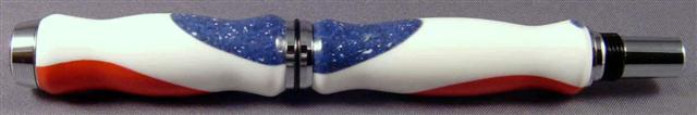

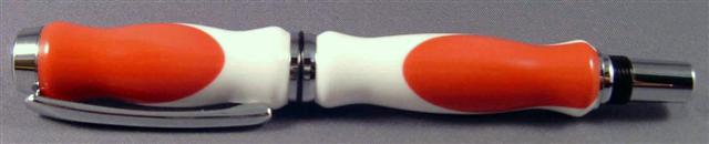

I have thrice now been the happy recipient of Frank's (Rifleman1776) "failed" experiments. This pen is a result of the last and I cannot take credit for the blank. It's Corian and Frank bent and glued it together. However, one of the glue joints failed and he became frustrated so he offered the lot of red, white and blue pieces to the first soul willing to pay the postage. I bit and was surprised to see this blank in the box. So I reglued the failed piece and turned this Baron FP. Oh, and yes, I said "bent". It seems you can heat Corian and bend it. I didn't know this, but the result is pretty cool. At least I think so. BTW, both photos of the same pen so you can better see the curves. Sorry, Frank, I hate to keep doing this to you, but... THANKS![}:)];)
Hey, Frank, remind me on temperature and time, please. I'd like to try one of these myself.;)

Nice effect and save on that blank. Playing with corian can be fun. Heat it glue some colored strips togther and twist is insteac of bending. Twist it like a candy cane.

Thanks, all. BION this was my first experience actually turing Corian. I've worked it for other small projects, just haven't had time to put any on the lathe until now (too many irons in the fire). I like it. A little harder on the tools, but turns easily and polishes like a dream. By the time I got to MM 6000 it shined like it does now, but I finihsed through the last three anyway. Now I'm looking forward to what else I might be able to do with it.
