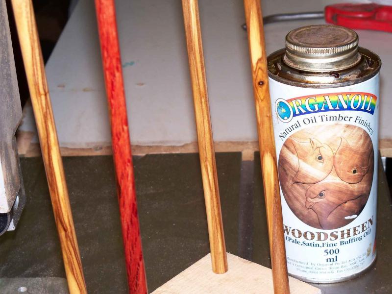

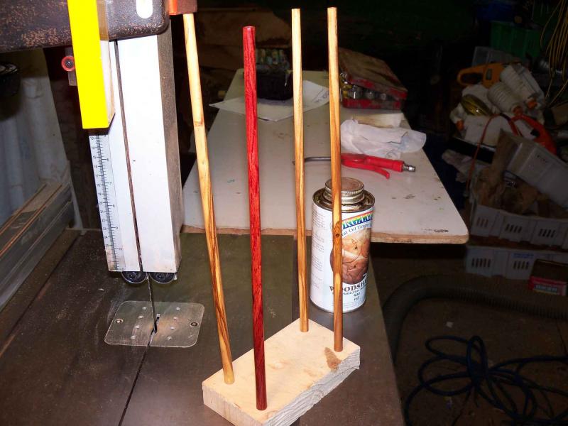

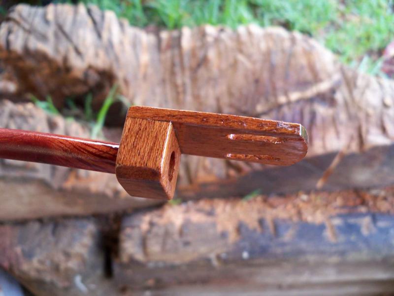

All done, packed and posted...!
Hi everyone,

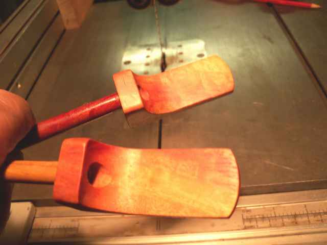

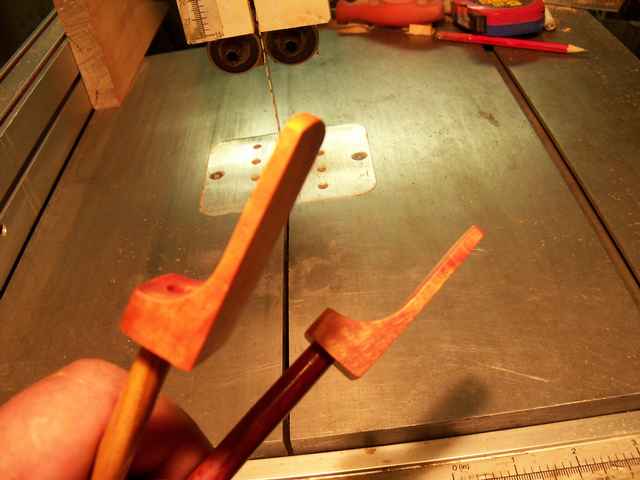

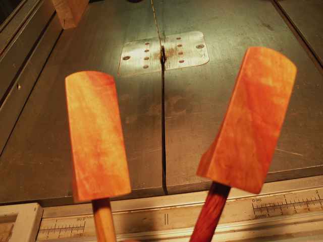

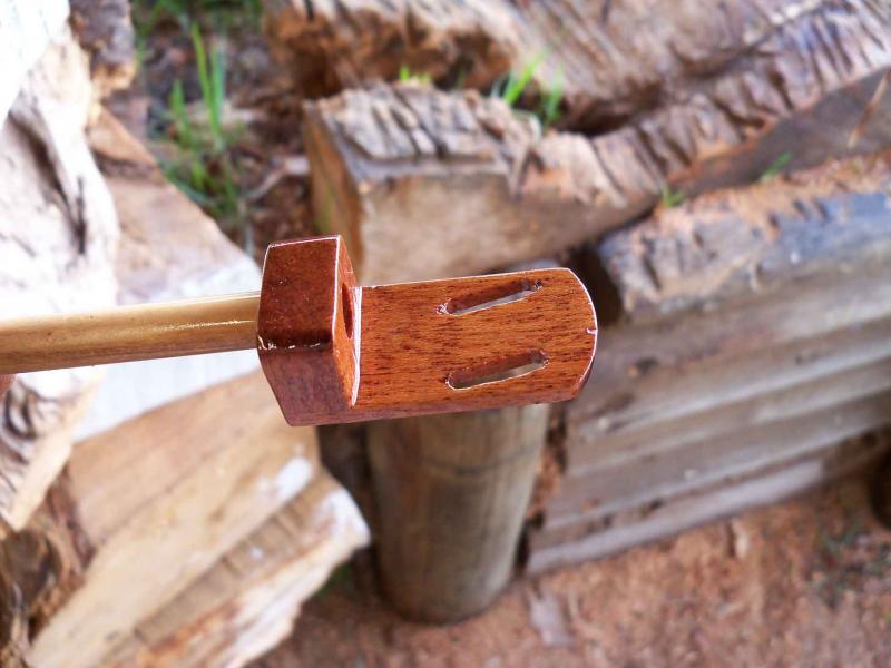

Well, this project ended today with the postage of all pieces I was request to make, including the first job as the 350mm hollowed sticks.

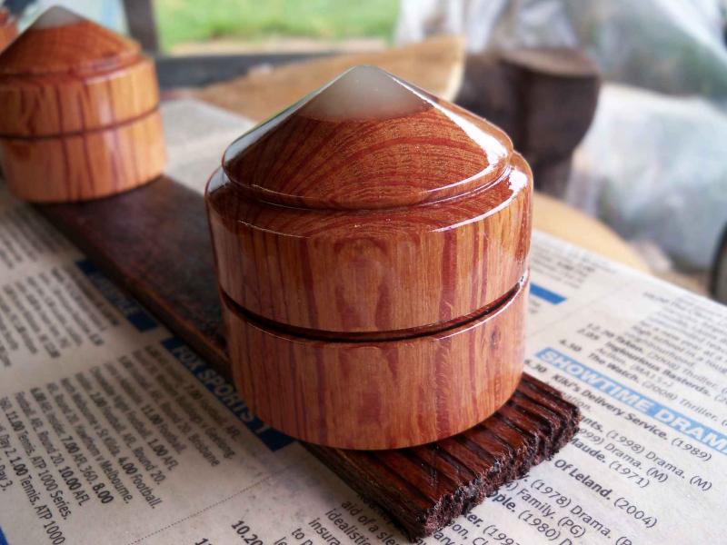

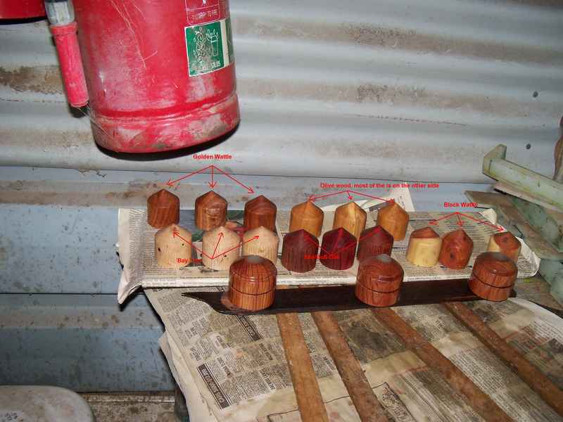

After making 4 of them, there was a request to make some base cones with solid Teflon material for elimination of vibrations, some more base cones but a little simpler to make, and 2 little pieces (shells) made out of Platypus Gum that were a pain to get right.
Anyway, all is on its way to its owner, rapped very very carefully and supper protected with lots of bubble-rap so, lets hope our Australia Post people don't mess-up things for him/us...!:wink::biggrin:
Attached are a few pics of the items that went into the box...!:eek:
This will be, this story END also...!:)
Cheers
George

It is a project /invention he is helping with but will not disclose as of yet if I read correctly.
Sorry about that maxwell_smart007, snyiper is correct, I have done these pieces as a request from someone in Melbourne (Australia) which he is involved with the "music" industry from the old days.
This is all his idea and invention, he requested me not to disclose "clearly" what these will be used for and I will respect that but, is no harm in showing the pieces finished to "validate" what I wrote in the beginning on my thread...!
I reckon someone out there, will put 2 and 2 together and work it out, after all I have gave some nice hints, already...!:wink::biggrin:
When it comes to "other things we make" is just no limit in what I'm asked to do, if is made of wood...!:eek::)
