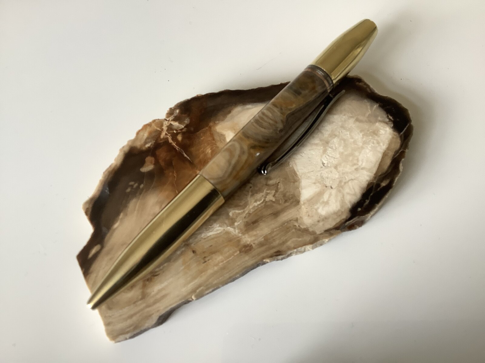

If I were to engage on such a project, my first thought would be to use a Sierra-type kit and create a custom top that would be a bit longer than standard such that a bit of ashes mixed with epoxy could be cast into the top. Here's a pen I submitted in the last round of contests employing a custom nib and top made from brass to illustrate the idea. If the top were made just a bit larger it would definitely work…
This would most certainly require access to a metal lathe but this would be my starting point.
