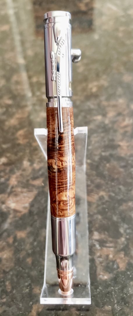

Thanks. The wood is Oak Burl and as far as I know (I've had it for 3 years) its been at least 4 years since with was cut and maybe more. I live in Arizona so the weather is hot and dry. I assembled one last week when it was about 111 degrees F with about 13% humidity.

If the Oak Burl was sound, then you should be OK.
If it was not sound, you would notice it, probably even before you started to turn it.
With spalted oak you have to inspect it carefully. . But even if it is a little bit punky you don't necessarily have to do a full stabilization with Cactus Juice.
I have had success using Minwax Wood Hardener, soaking blanks in that for 20 minutes and letting it then cure/harden for a day.

I believe it is sound. It turned easy, there were no cracks, knots or etc. I used Gluboost to finish the pen and it came out looking pretty darn good (at least in my opinion).
