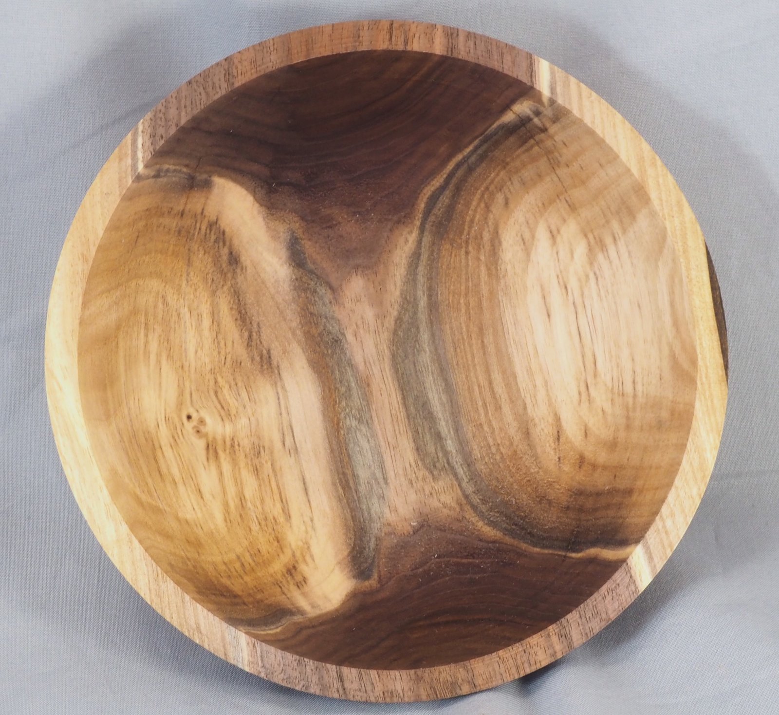

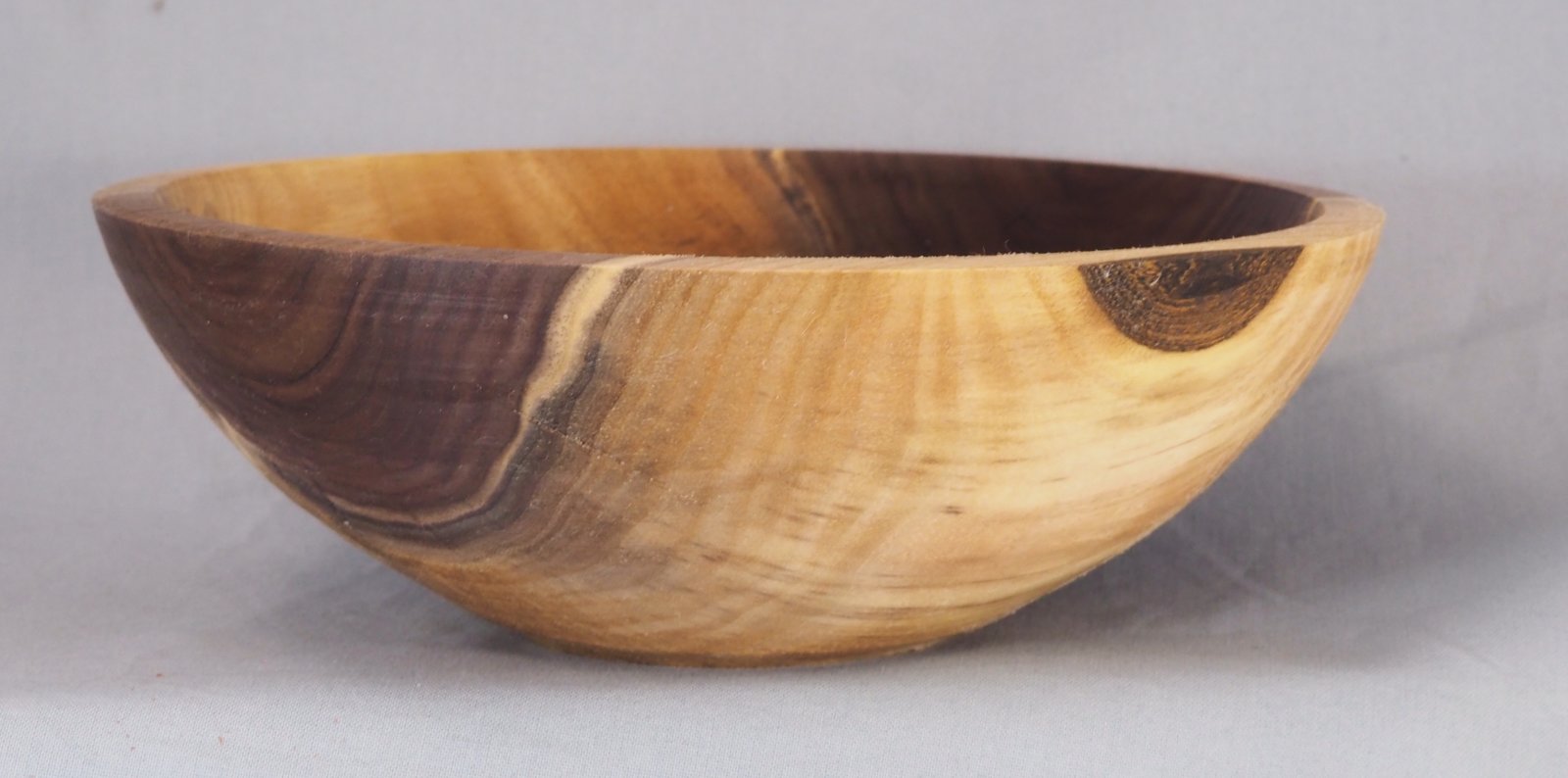

I know that my turning techniques are not as strong as they should be so I have decided to participate in a challenge to turn a bowl using a single bowl gouge with no sanding. My plan is to turn several practice pieces. This is my first practice piece with a single coat of lacquer to highlight the grain. Turned from a seasoned walnut blank. I think this will be a very beneficial exercise for me. I will go back and sand and finish this bowl later.

Taking a good close up look at the end grain on your bowl shows very little grain tear out which is a good thing. Did you use the bowl gouge in a shear cut for the final cuts??
Great work.
Great work.
Thanks, I did use the bowl gouge to make shear cuts at the end.
