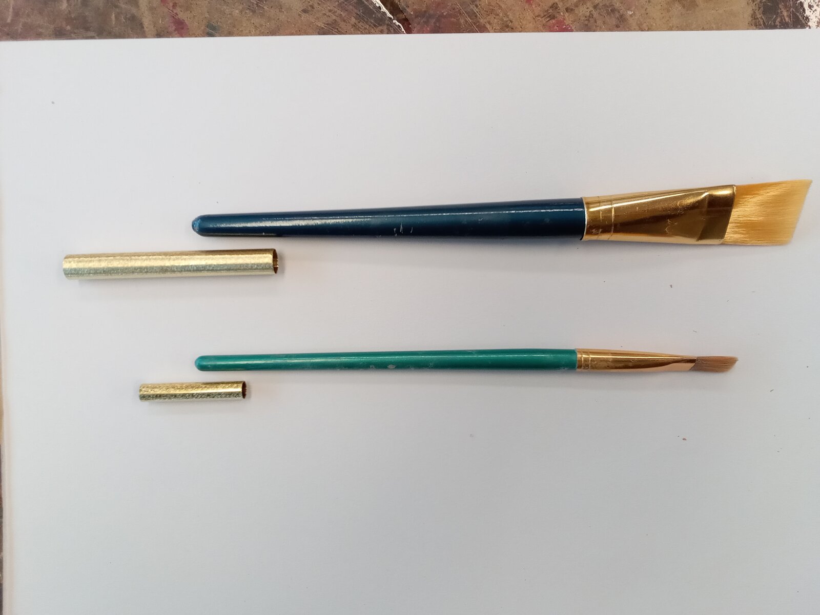

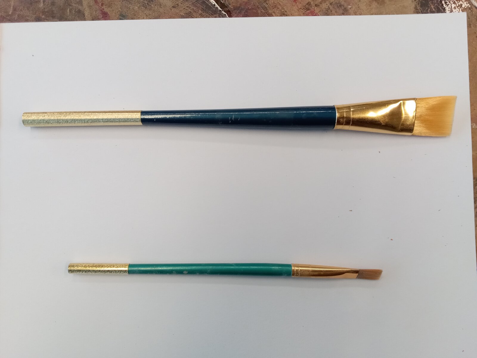

Most of you folks most likely know this but I am new and yet to build my first pen.
Been tooling up to get going and saw the universal pen tube insertion tube for about $12.00 + shipping.
I had to kind of smile at the concept there are several ways of adding the tube to the blank without using this tool. Additionally the same insertion tool doubles as a pen section finishing toll / holder etc.
Here is what i plan on using, actually I have used this process not yet to turn a pen but have built about a dozen pipes , same gig just smaller.
The pics her should be clear what works for me so far, here is a hint handles to artist brushes :p.

The only problem I see with that is that glue might get on the brush handle & possibly adhere to the tube. I use a piece if delrin rod that I tapered so I can use it for any size tube from 7mm to 1/2".
If it gets some glue on it, it won't adhere to the tubes & I can easily clean it with acetone.
That being said, whatever works for you is a good solution.

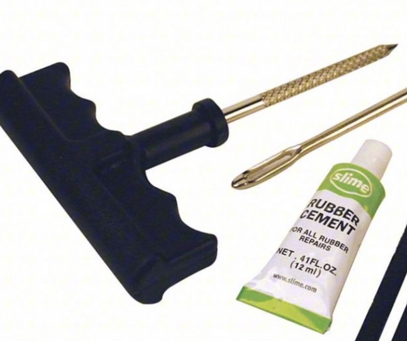

I sometimes get a little glue inside my tubes. I use a plastic flat tire plugging tool to clean the glue out. Just a little filing & presto glue is removedā€¦(picture shows a metal one but mine is actually plastic, been using the same tool for many years)
neat idea I use a dental probe to effectively scrape the cured epoxy off the tube. I have used pin nail punches as insertion tools. They work well and grip tube enough to rotate on insertion.
