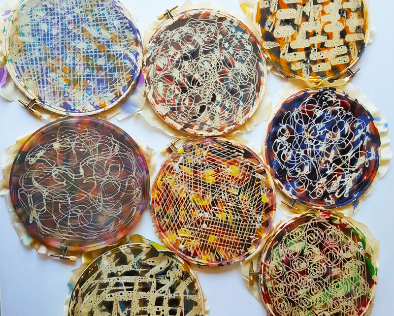

I'm exploring and streamlining methods of batik creation today - more tubes ahead before casting:
attachment.php
- Bob
