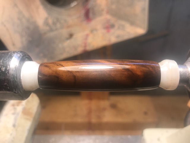

This is piece of walnut root stock. Three coats of medium followed by four coats of thin with activator between each coat.
Left overnight to cure and this is how it looked after going through the Zona grits wet.
It did not look like this before the Zona.
Thinking I may sand off and start with thin first and see if I get better coverage unless someone else has an idea.

I can't see it as well as you but it looks cloudy along the one end. I'm wondering if moisture didn't soak in the wood along the ends while wet sanding and get under your finish.

I agree with the above on the picture. I am sorry. I take it from your comments the zona paper was wet? In general you should be able to get away with minor wet sanding after the last coat. The concern always the ends where moisture can go in under the bushings. I never wet sand wood - independent of the finish.

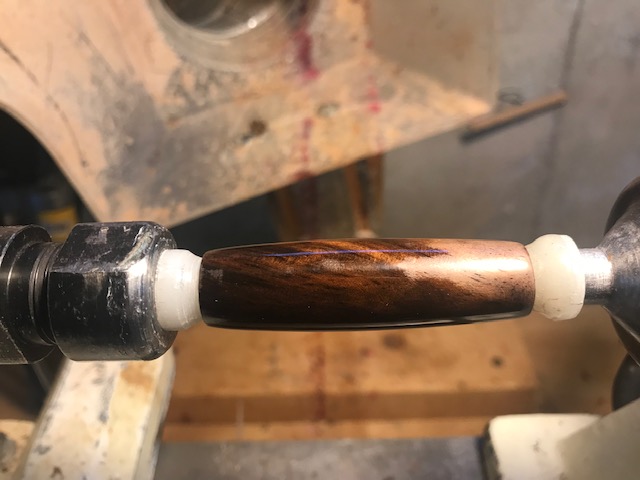

Thanks Lee, that's what I thought at first too until I ran my finger along the finish and there is a solid finish all the way across the blank. If you see most of the discoloration in on the right while there's a tiny bit on the left too. I turned this originally between centers as I don't have bushings for this kit. I always leave them a little proud knowing I'll be sanding down. At his point I'm not sure where they are because I've put three different finishes on and removed them. I did it a fourth time today and tomorrow will use steel wool, Zona and Novus 3 step. The only thing different will be no wet sanding with Zona. I'll post the results tomorrow.
Here is the blank after sitting overnight.

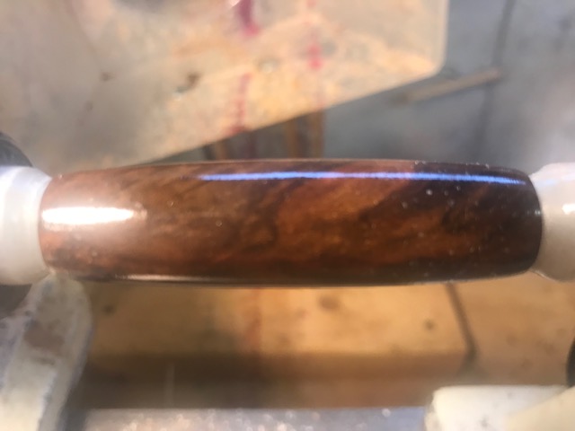

Here is the blank after polishing with stainless steel, Zona, Novis and Ren Wax. Notice I'm picking up some fuzz from my Scott blue shop towels.

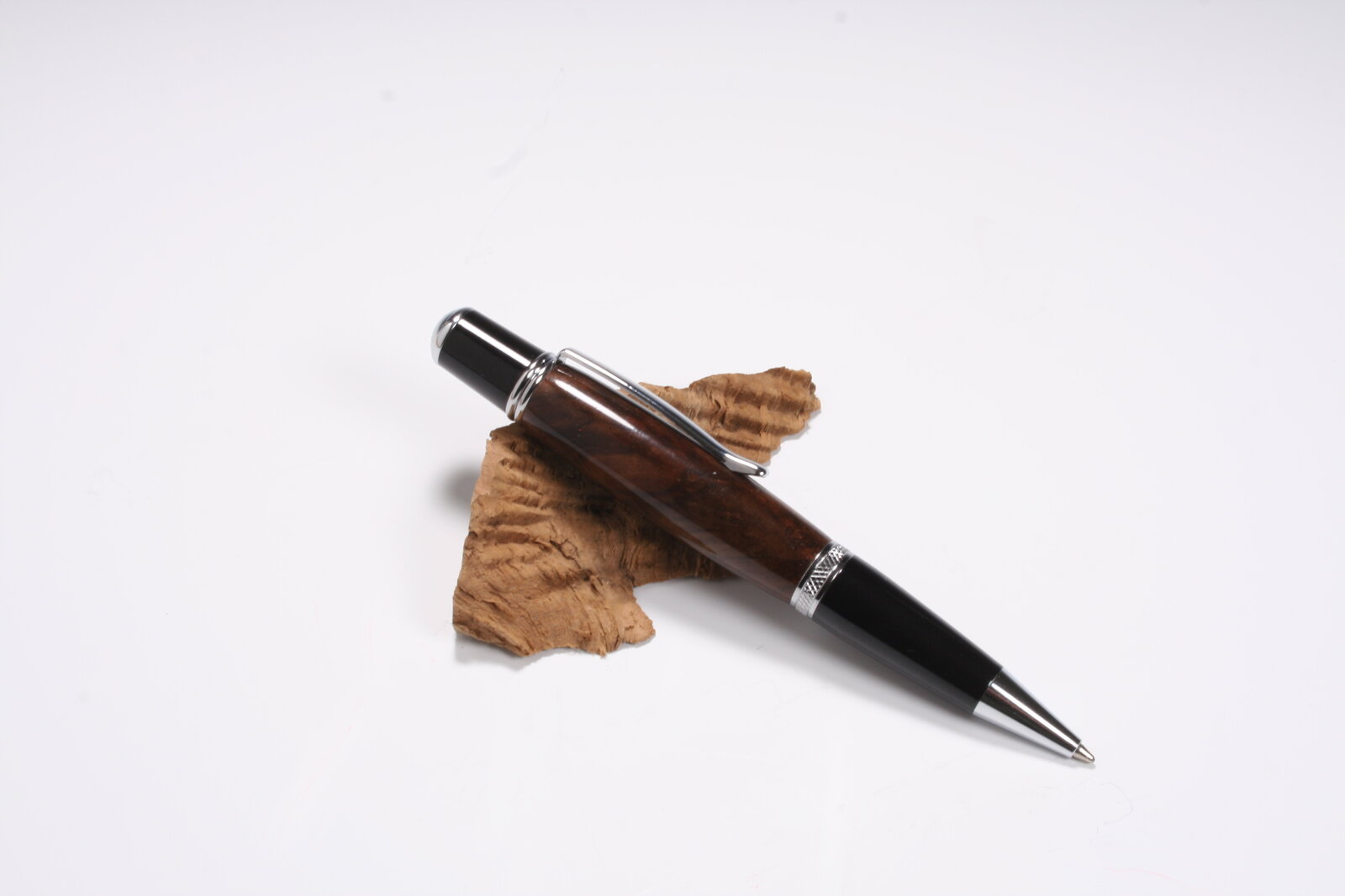

And this the finished pen.

Moisture was the culprit. Thank you all.
