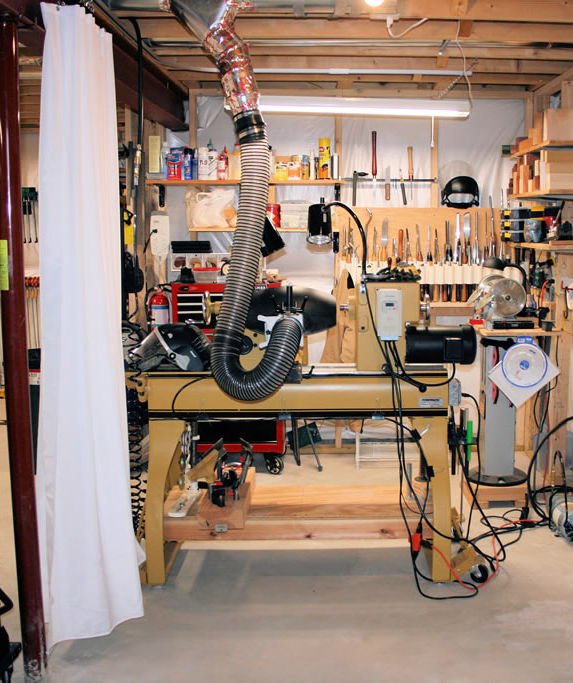

I invested in a hospital grade curtain track and two oversized shower curtails for the right side and behind my lathe. The track is very smooth with nylon rollers supporting the curtains. You can see the curved track anchored to floor joists in the attached photo.
save sooo much mess and time . I used roller curtain o pull down when needed and out of way at ceiling height when not
