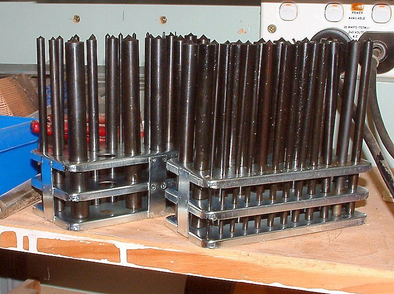

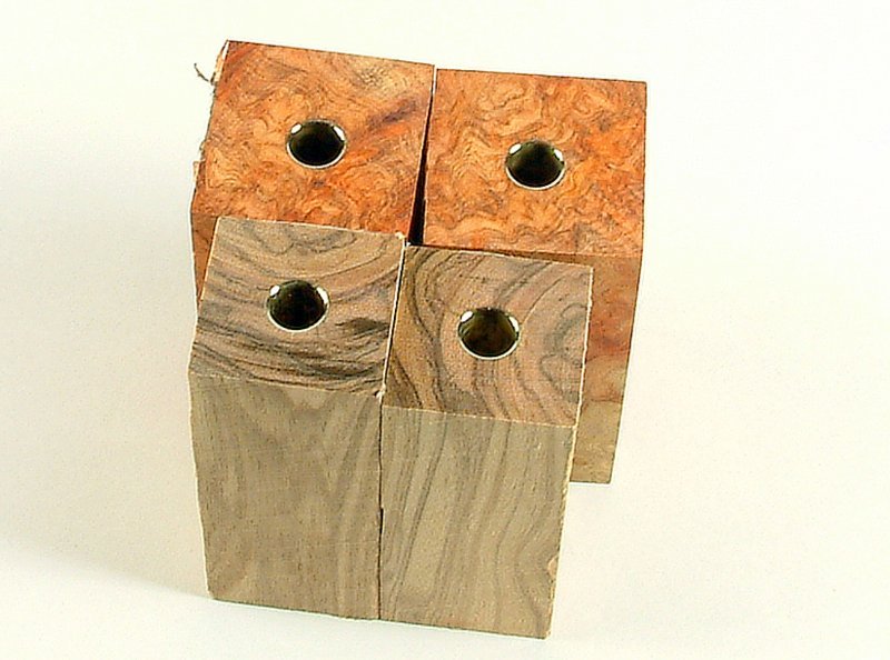

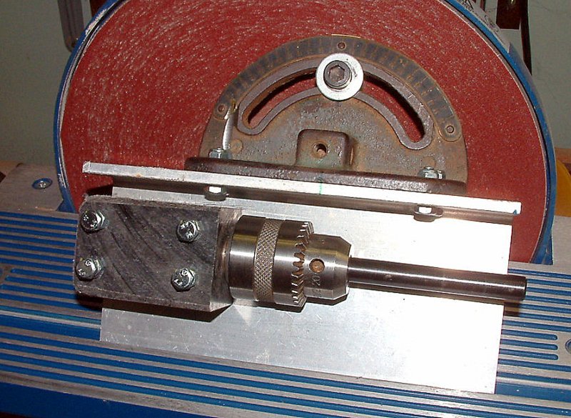

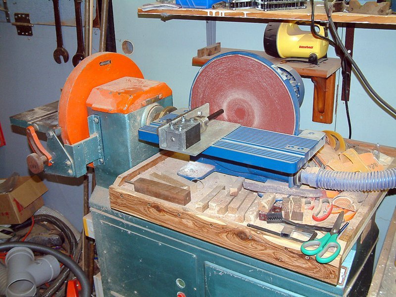

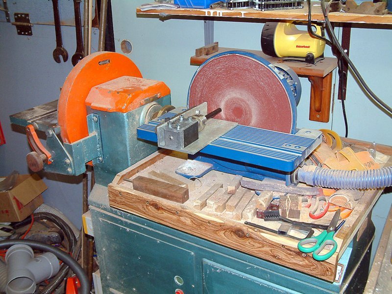

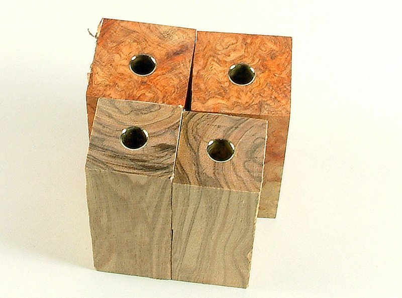

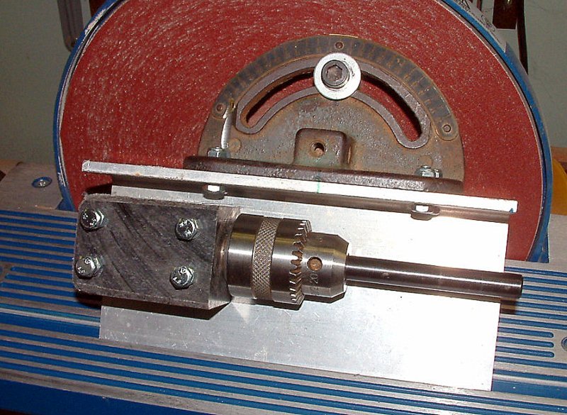

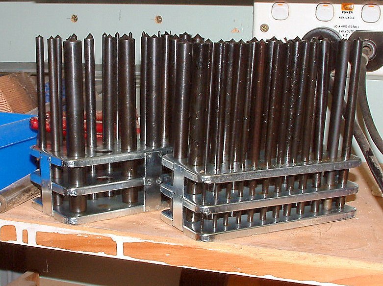

This is what I do. I used to use the square wood block with a cut off mandrel fitted in front of the Sander. I now use the same mitre square attached to the mitre square in corporating two sets of punches, metric and Imperial to accomodate the proliferation of pen kits these days.
Works for me. PS I ream the brass.
